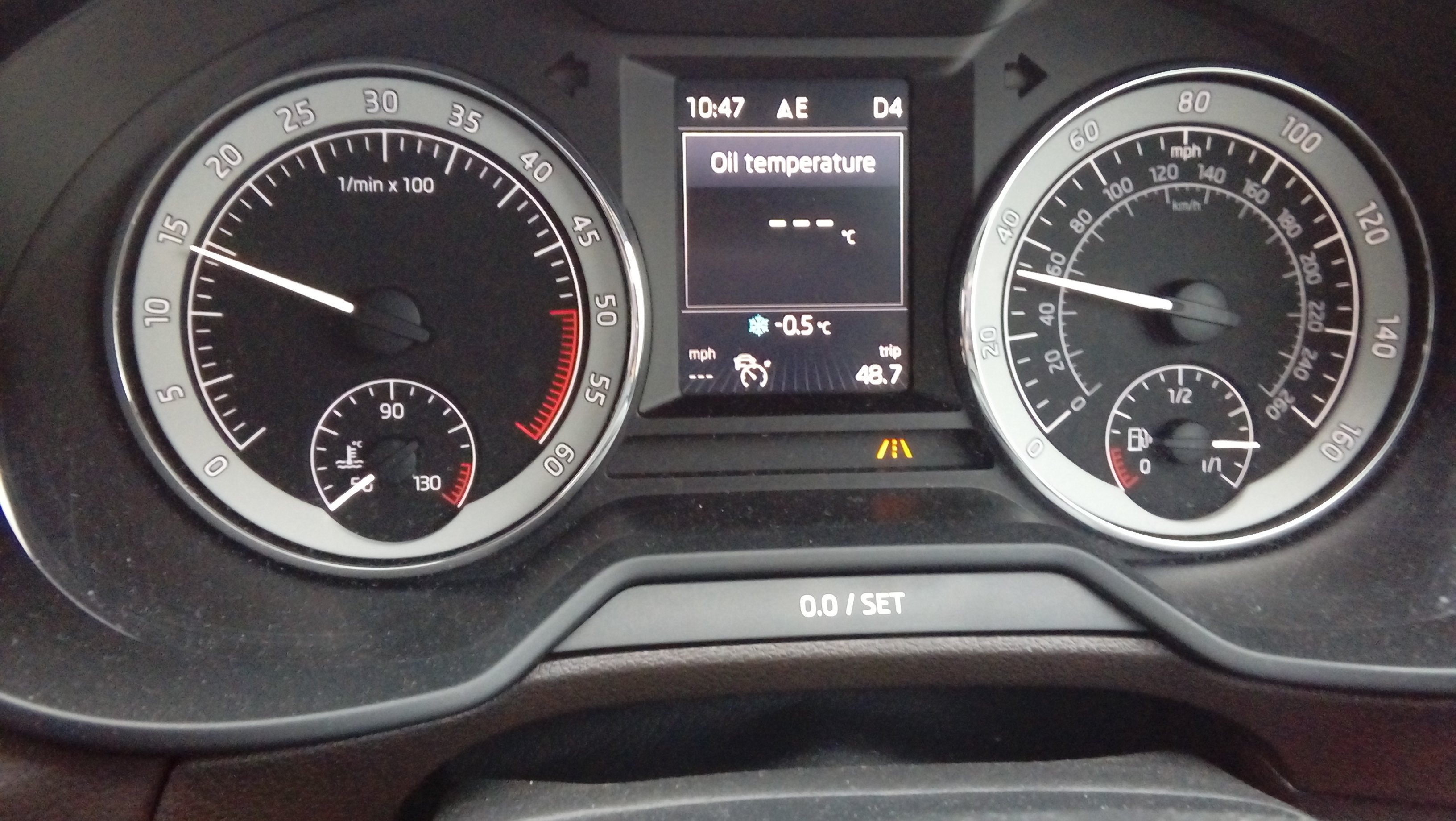

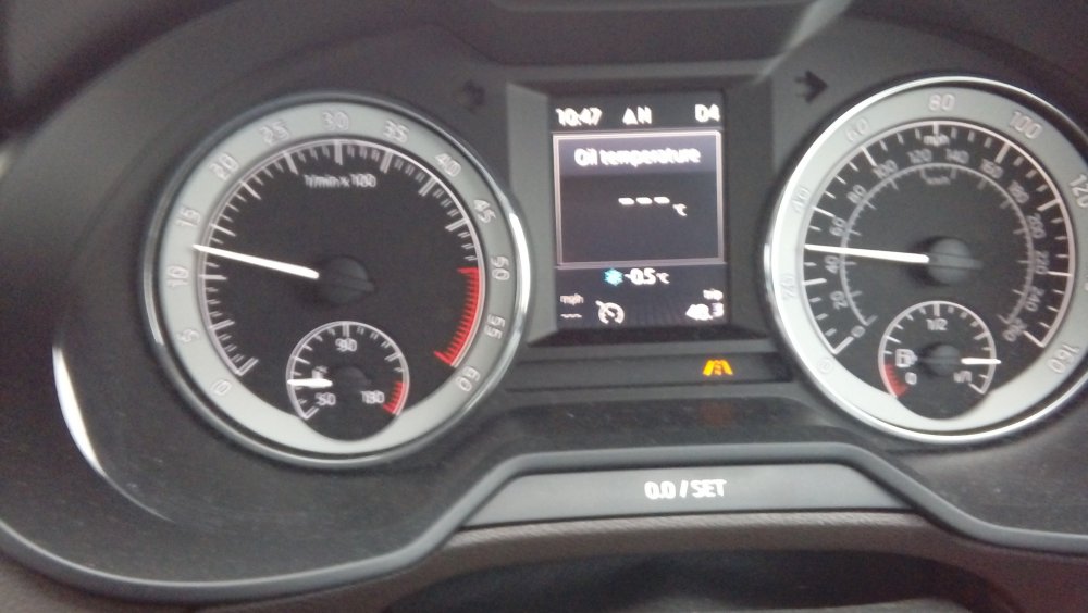

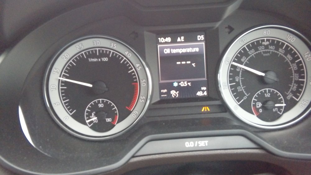

Apparently photos are not accepted by Skoda UK, instead a video is needed of the event. Which I now have, showing a 12C+ drop in temperature over 30s from 62C to below 50C (car engine coolant does not read below 50C).

For brevity I have not posted the next 5 images showing the gradual rise to 90C
Mileage 48.3 miles on trip image 1 62C/63C
48.7 miles image 2 below or 50C
49.4 miles image 3 56C
