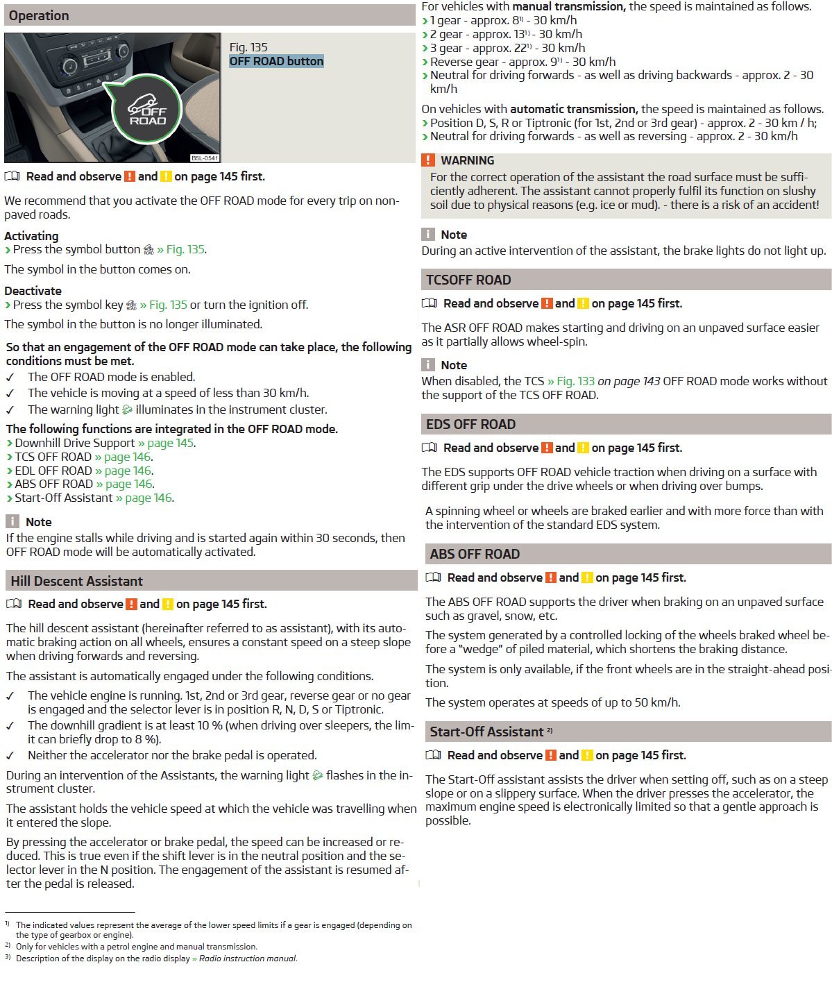

The Handbook has a very good description of exactly what the Off Road Button does, and what systems it works with.
great manual.. thanks..

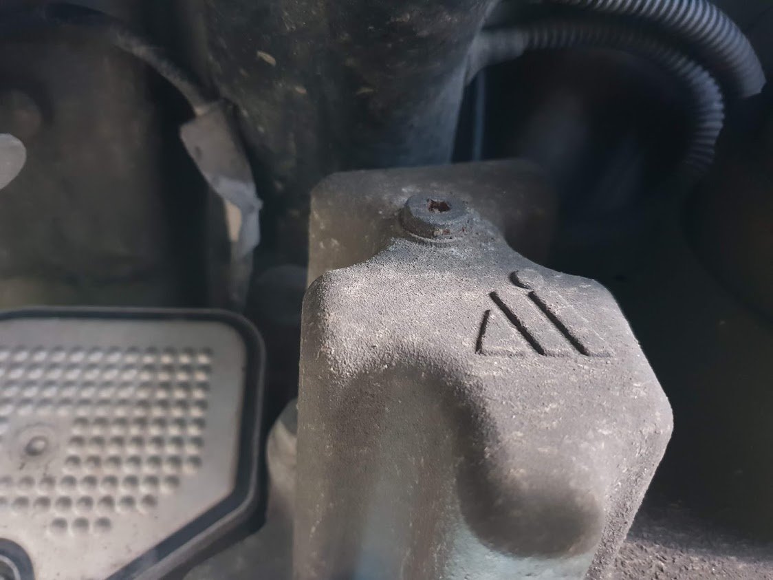

on this haldex, oil and filter looks like it is never been changed.. mine too is corroded, but not that much..

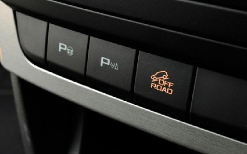

have you part of that Handbook? i never read nothing about off road button and what is going on when is on..
The different editions of the Yeti owner's manual can be downloaded from here.  You should be able to find the description of the off-road button's functions from the Table of Contents.  In the 2012 editions of the manual it's under "Starting off and Driving", around about page 100 plus or minus a few.
thanks, i have some manual but it have not all stuff, it is generic one i perhaps..

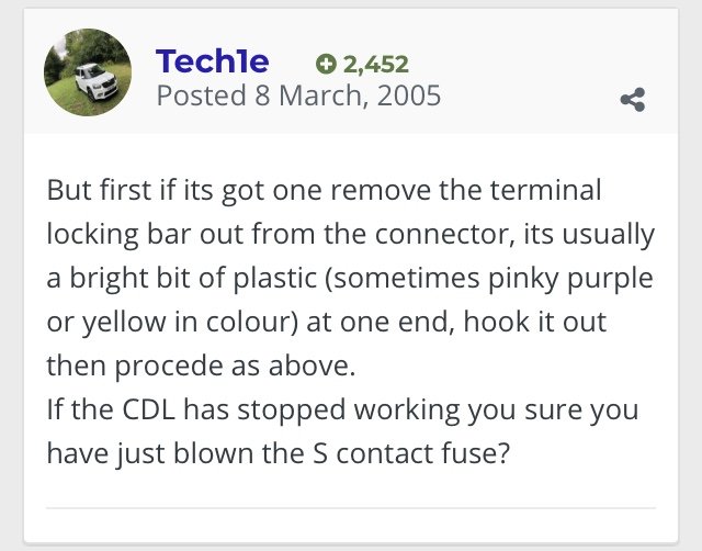

In 2005 you commented on this (see picture) explaining how to remove iso pins from the connector. I am able to get mine out a bit, but then they are stuck, and I think that’s because I have to remove the yellow/pinky terminal locking bar that’s on the side, but mine is pushed flush into the connector itself, so there isn’t anything to grab on to pull it out, so how do I remove that bar?
Thank you so much if you answer! I hasn’t been able to find anything else about this

13 years ago!!?? You have to be joking??!!
And what on earth has this got to do with Yeti's??
They weren't even around then!!

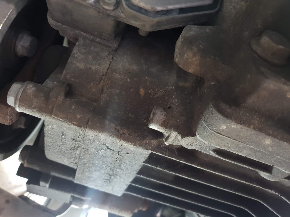

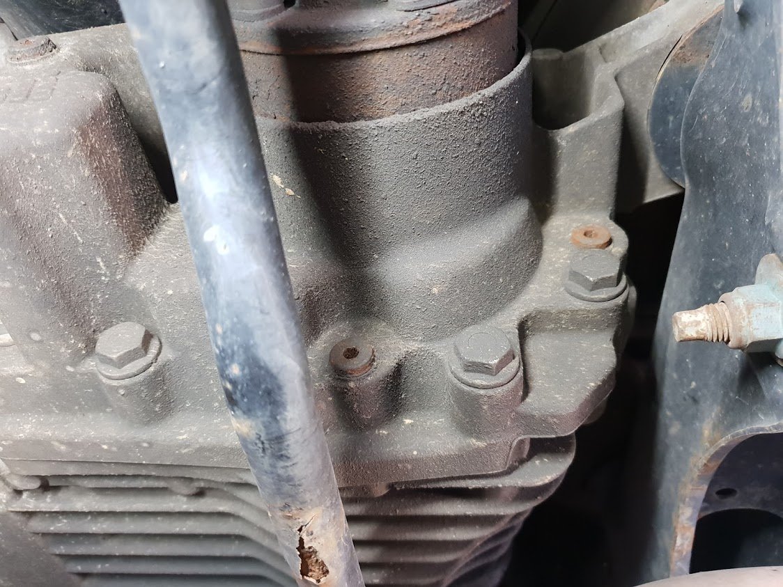

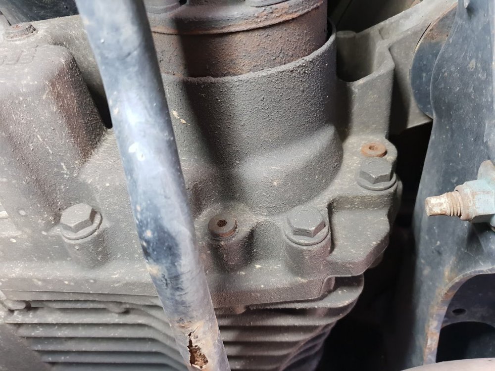

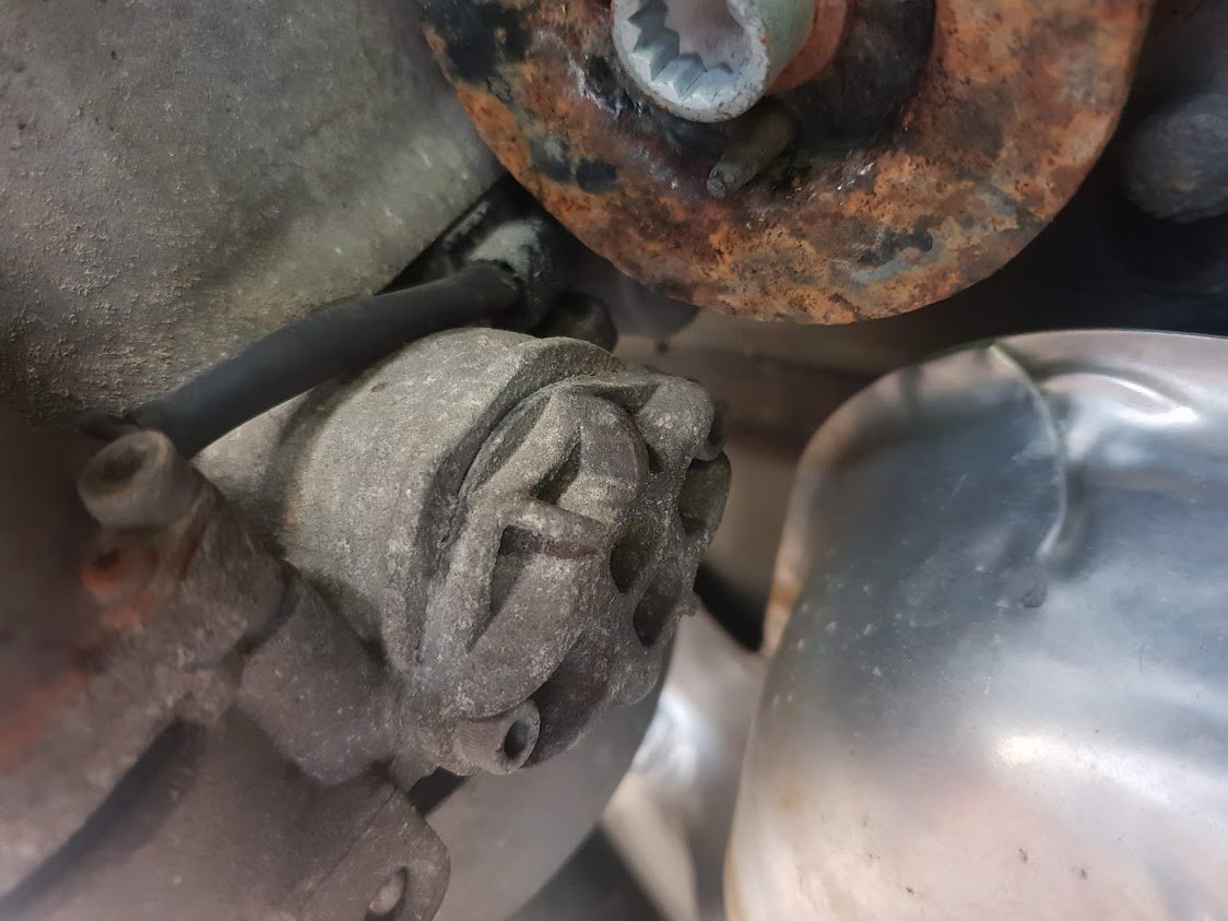

today i have a time to clean rear diff, and preparing for oil and filter change.. is this ok?
https://www.ebay.com/itm/Borgwarner-AWD-oil-filter-VW-GEN4-AWD-111358-and-oil-G055175A2/302318931379?ssPageName=STRK%3AMEBIDX%3AIT&_trksid=p2060353.m1438.l2649
my work:
this two bolts on picture 4 are for 85W90 oil right?
when to change that oil? i have 200000kms and 7 years old yeti.. read somewhere that oil is not changing (filled for life) but not sure.. it is cheap, 10$ litre..
brrrrr... Castrol says every 30000km.. od 24 months.. should it be changed really? i am in doubt now..
