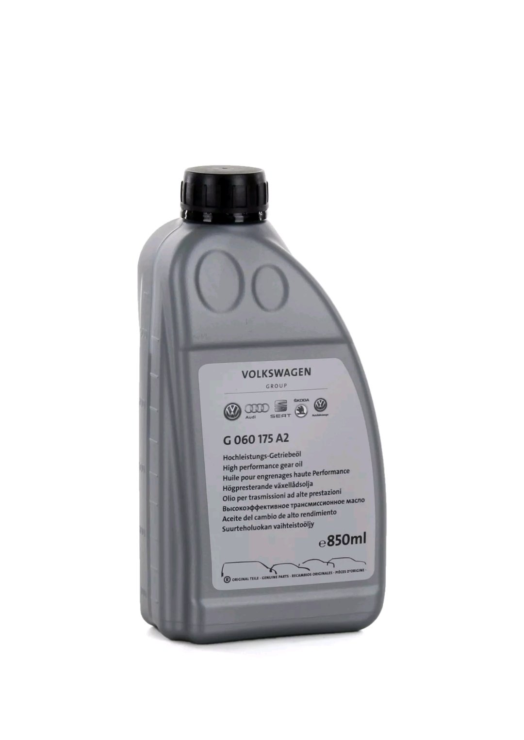

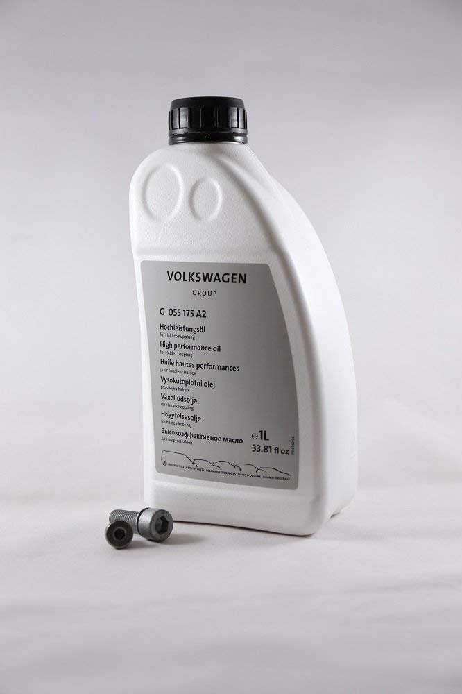

which oil to put in my haldex ? skoda yeti 2012?
i see somewhere  that is oil VW 055 175 A2
is that oil correct?
Hi, On my 2014 Yeti I used G060 175 A2, no filters, bit fiddly used a large syringe.
Spoke to Skoda UK, confirmed no filters.
Good luck

Which oil do you have?
https://www.skoda-parts.com/spare-part/g055175a1-haldex-clutch-oil-skoda-13625.html
Filter is that:
https://www.skoda-parts.com/spare-part/0br598574fil-haldex-clutch-oil-filter-skoda-26750.html

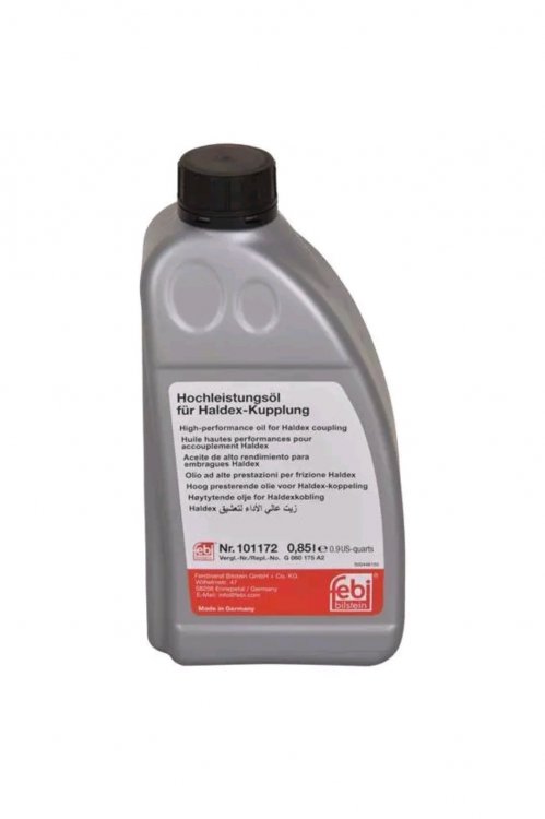

Think G060 175 A2, is same as G055 only smaller package. 0.8L instead 1L
same oil can be used.. bexause 0.75 is volume in haldex.
think it is same oil
https://rover.ebay.com/rover/0/0/0?mpre=https%3A%2F%2Fwww.ebay.de%2Fulk%2Fitm%2F113212276825
half price
It is the SAME OIL as vag original (with vag oem sticker)
Edited by imart143

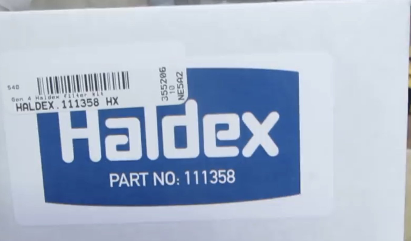

oil  g 055 175 a2
filter as per photo + top plastic mounting and alloy cover and screws
the idea was to do the stuff in a chums garage on a small vehicle lift, however, he exchanged the lift for a fergy tractor!
Ok stupidity rules, work not done, not shown in ERWIN re Haldex, Skoda garage no idea, explains why it wasn't done when car in for service at around 42k miles and also when I called at my local, now closed, Skoda dealership to request oil change in Haldex etc  -  was told it is sealed for life(like the diff!).
