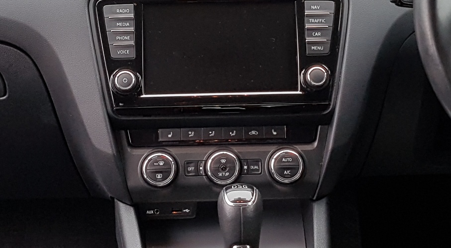

My Scout has the "Winter Pack" but I'm yet to identify which of the 3 knobs turns the window heaters on as the left one apoears to have a heated window symbol in both the top and bottom sector where the second knob also seems to have one!
Which knob/sector turns the heated rear window on and which controls the front one?
And therefore what does the extra one do?
What I could do with is a complete "idiot's guide" to the entire heating control system!

LH Image is the Front and RH is the Rear
Oh that's where they are - thank you!
But what then are the functions of the three knob sections with heated window icons on?
I'm still confused!
Cheers,
John
Middle rotary control, top button turns on electric heated front screen.
Left Rotary control, bottom button turns on electric heated rear screen.
Left Rotary control, top button puts climate control into a mode that will attempt to demist windows as quickly as possible.
Auto puts the climate control is the best mode to obtain your preset temperature
AC turns aircon on and off but always leave it on.
Setup or Menu in later models enters the climate options.
Lee
Thanks Lee. It's all becoming a bit clearer now! Shame the author of the owner's manual didn't explain the functions as comprehensively as you! I'll give them a try in the morning! Cheers, John
