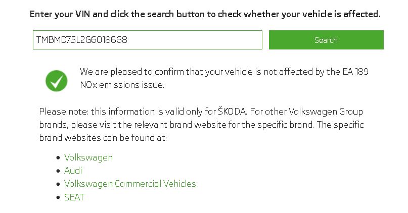

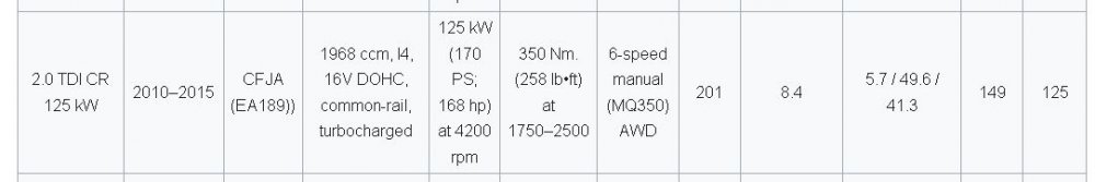

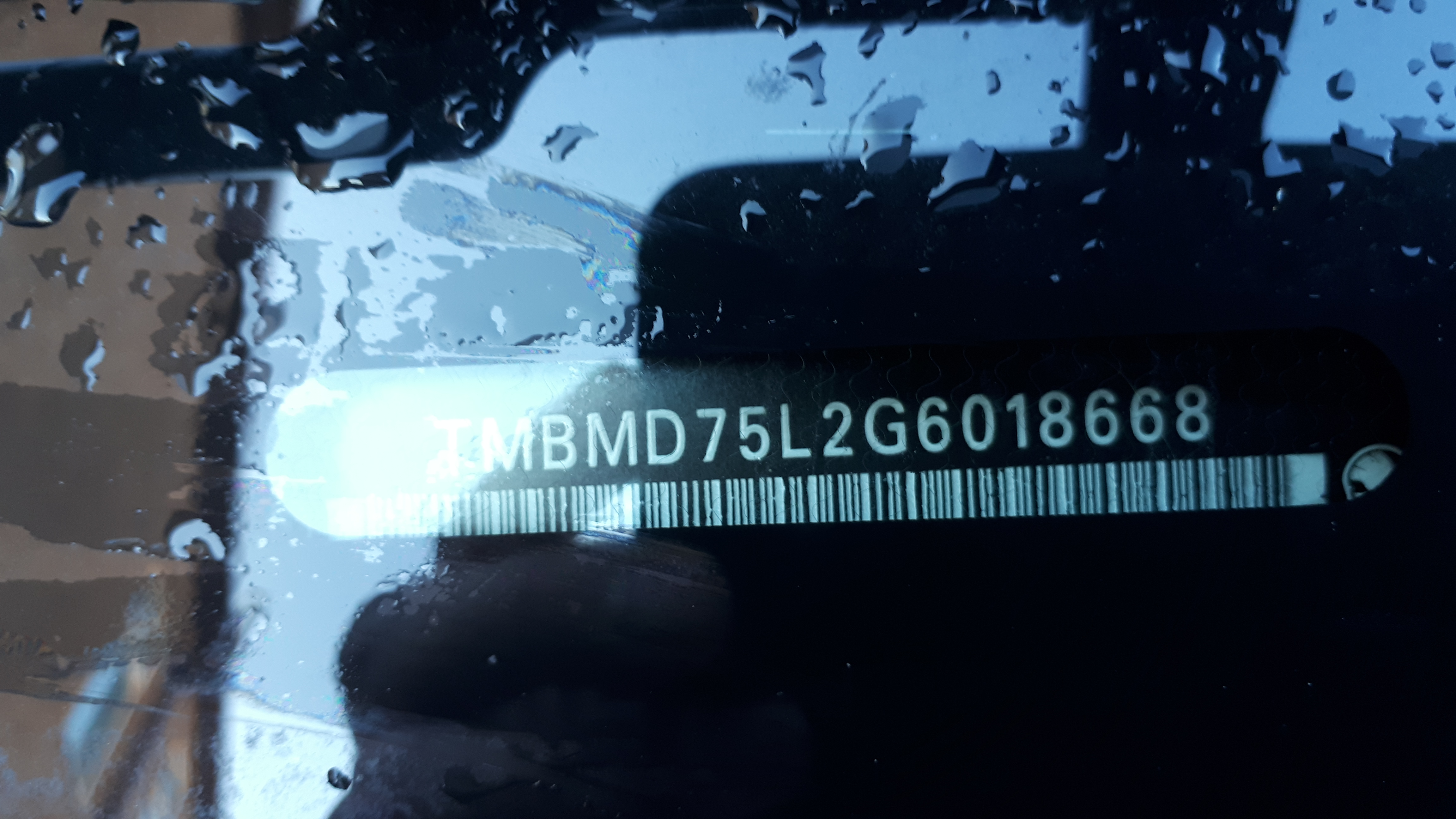

MY VIN is  TMBMD75L2G6018668 and using the Biskoda details for how to read Skoda VINs i can't make out engine BHP.but  using Wikipedia the  engine appears to be 125kw meaning it is a 170. so until I get a definite answer from Skoda I am in the dark.
Good news though id that the car is not affected by the EA 189. Attched photos of wikipedia and Skoda Vin details5aa19e742d89e_YETIVIN.thumb.jpg.e7418774d9d0b1418ebdb2c06fc1da7b.jpg5aa19e6393800_YETIENGINEDETAILS.thumb.JPG.d6716a6acd6209508ad1ec12c7f51493.JPG5aa19e742d89e_YETIVIN.thumb.jpg.e7418774d9d0b1418ebdb2c06fc1da7b.jpg5aa19ea0abd7a_SKODAEA189.JPG.0d7452e87d3eb1332bc92a5b38be740f.JPG
1 hour ago, Ajay24 said:
 That suggests to me your car is NOT a 170.

As a 2015, it could be a 150ps EA288 rather than a 170ps EA189. Given the DVLA and insurance both think it's a 150ps, there is a good chance that's the case...

Has anybody looked at the VIN he put up?
It comes up everywhere as a 2016 car !!
I think you've just confirmed what a few of us have been thinking from the start, that he's got a 150 model.
