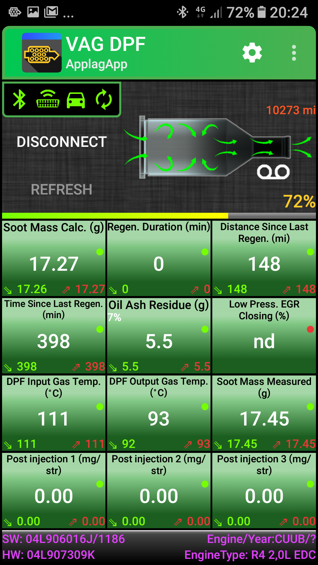

Today I bought the full app and it is telling me the DPF is 72% full. See attached screenshot from my phone.. I have not figured out yet how to read  the results so any help would be appreciated.
I don't think there is anything strange in that screen shot.
When the soot mass gets above ~18g the car should start an active regen. If it gets above ~24g, you'll get the DPF light and need to do a 'regen drive' to help out. The 72% is showing how close to 24g soot mass you are. During a regen both soot mass figures should drop and so should the 72%.
If for any reason the car can't do a regen, the soot mass will keep increasing. Above ~40g will need a dealer regen (DPF, ECU, glow plug lights), above ~45g is normally the end of your DPF as it's no longer safe to regen.
Assuming the car is working normally, it's the oil ash that determines the DPF lifetime. You're currently at 5.5g or 7% suggesting an expected life of 150k which isn't unusual.

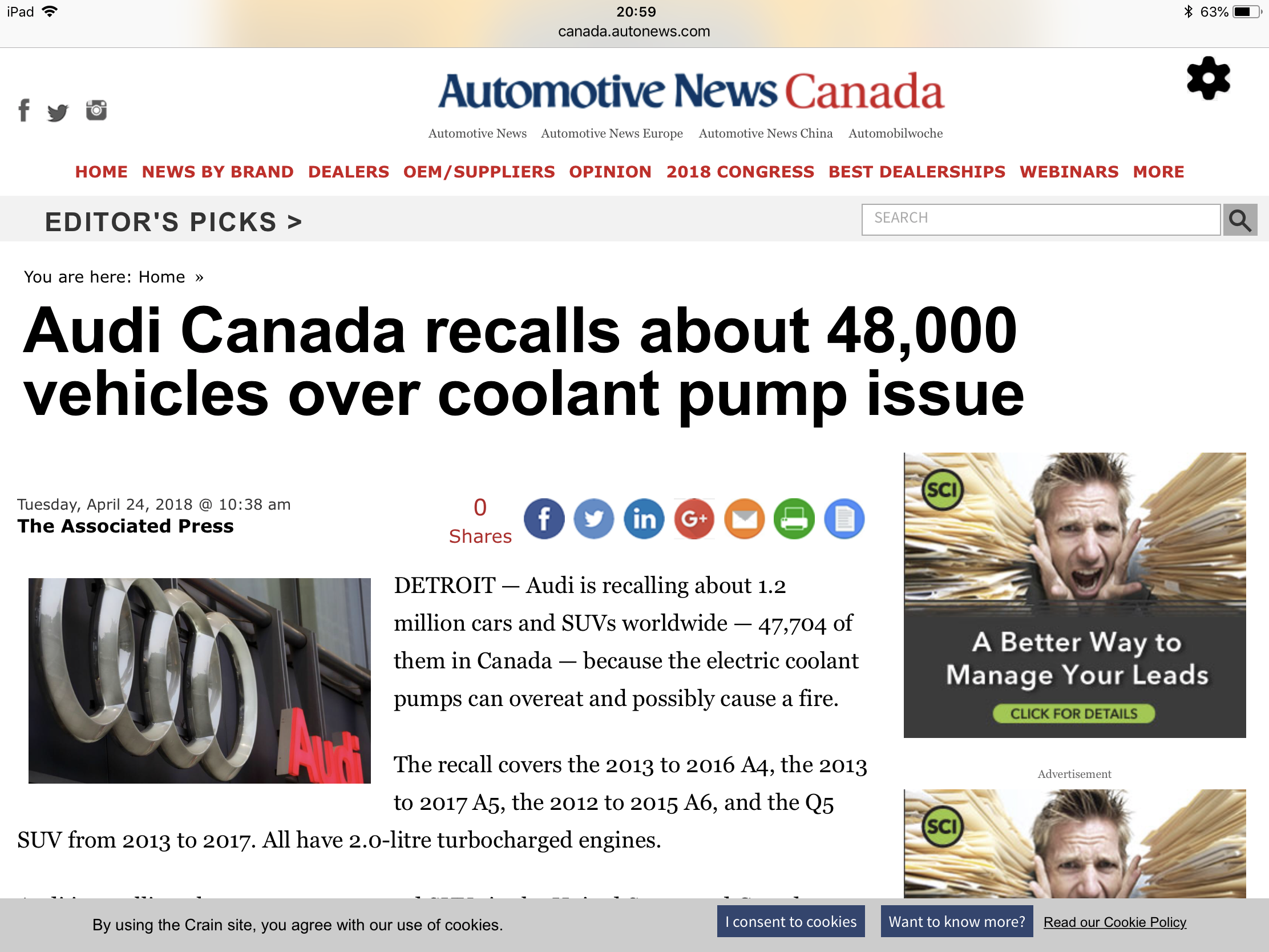

look on the Volkswagen diesel customer forum emission scandal,it appears from what i can understand the higher heat produced by post fix  to clear the dpf and egr in nox reduction is causing many more problems for the engine,remember the engine emission system was designed to CHEAT euro 5 and all was well because it performed well and produced too much nox that they thought could not be detected but when vag got caught cheating they had to come up with measures to satisfy some stds (not that the british?european gov have done much about it) and they said theFIX they had applied would not cause any problems or increase fuel consumption and because the European standard is lower than the  American one they are getting away with it to a large degree but as they cant meet USA stds hundreds of thousands of VAG vehicles are stacked in the desert,also some legal firms in this country are in the process pursuing VAG through the courts.
To say the fix is harming the coolant pump is pie in the sky.

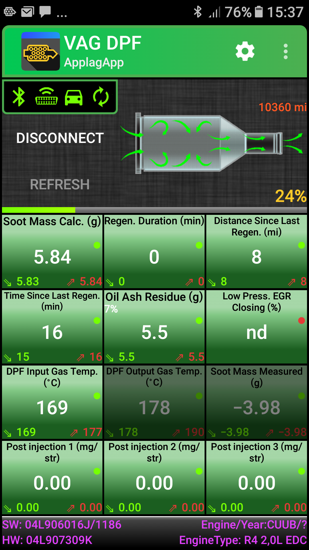

Many thanks to Langers for explaining how to read the reults of my VAG-DPF app (paid version)
With that information in mind I connected the OBD2 and my mobile phone and did about 75 miles dual carriageway in 4th and 5th gear over 4500 rpm and watched the results until it started a regen (220 miles since last regen) and yippee doo the soot levels fell from 74% to 22% and the soot mass Calc fell from 22.1 to 5.84. So  hopefully I have cracked the problem with a lot of help from fellow Yeti owners and will keep using the DPF app to avoid any more limp mode episodes.
See screenshot showing results a few minutes after the regen ended.
Its still a real nuisance having to do 75 miles every now and again just to keep the Yeti free from the dreaded limp mode.
Hi EJSTUBBS. I understand what you are saying and by now you may have seen my latest post which appeared just before yours. I will have a look at my manual to see what it says about solid or flashing warning lights. At the moment I am a lot happier today than a few days ago.

For example, when I recorded my CR140 doing an active regen, it took less than 5 miles from start to end at ~70mph in sixth gear. The engine would need to be up to temperature first but that should only take 10-20 miles depending on ambient conditions.
If everything is working normally, you should only have issues if you do lots of short journeys where the engine can't get to temperature and start an active regen.
Still, at least you can monitor your DPF during your normal drive and if it gets above 25g, consider taking a longer route home :)
Thanks Langer, just letting you know I kept driving for probably threequarters of an hour just watching the levels going up and up until the the dpf symbol on the app turned red and the regen started. It took between 15 and 20 miles to turn green again. I will keep monitoring the DPF every few days and always take a screenshoot to prove what is happening for future reference.

A link to this artical was posted by ryemanrye an
