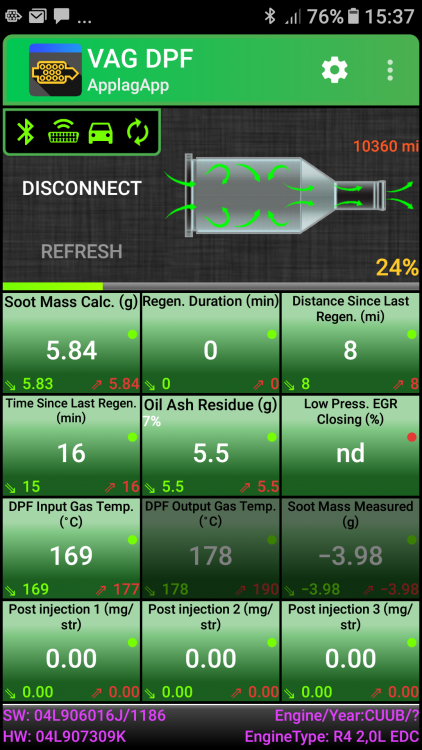

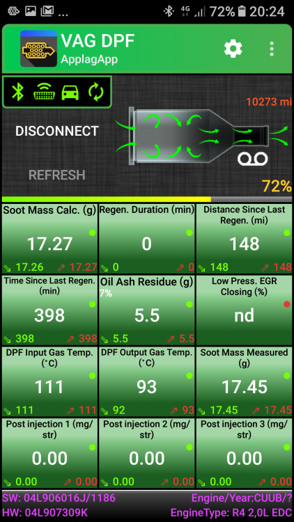

1 - The regen problem is almost certainly down to me doing mostly short trips and not enouigh motorway type driving.
2 - Will plan to do at least one long run every 4 weeks
3 - Will download VW DPF app and getan obd2 dongle to check dpf values

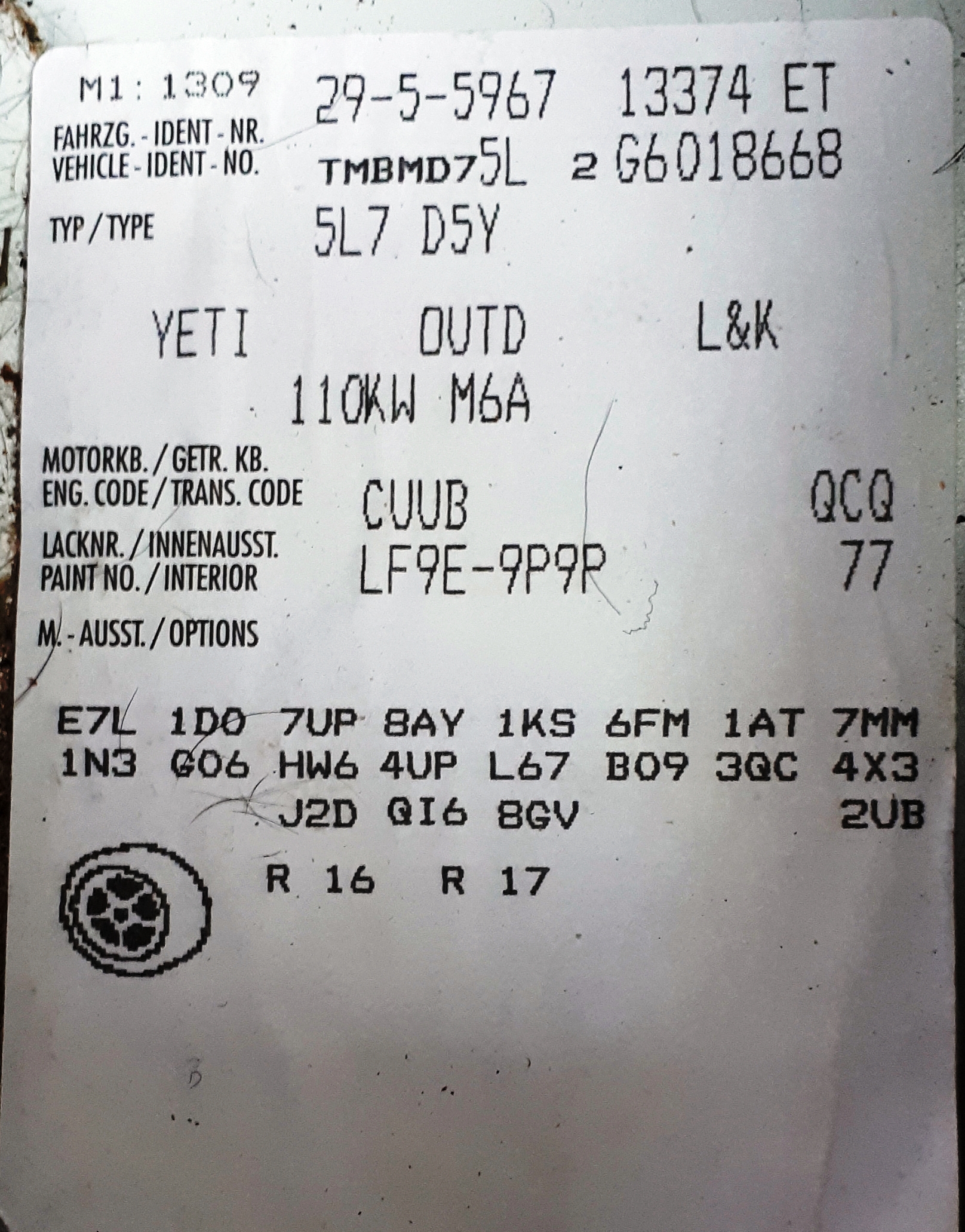

On 09/03/2018 at 23:55, Ajay24 said:
First of all-  Yes I doI have an adblue tank and have filled it up twice following warning light.
I am getting so confused trying to sort out my enine .Reply from Skoda received this morning telling me they could not give me the details of the engine they fitted in my yeti.(are they keeping something from me?)
On a skoda yeti vin check site the details came up as a 2016 model with a 125kw engine so I checked under the boot carpet and the detail sticker shows the engine as  110 kw   M6A.
1 - Can anyone translate the details on the attached picture.
2 - Is it possible that the vin code is incorrect
3 - I still have the Arnold Clark advert for the car stating it is a 170 ps (ex demo) car with 10 miles on the clock and if the car is proven   to be a 150 ps what course of action could I take against the seller.
4 - Strange how this post has gone from a DPF problem to an engine size problem just because I wanted to order a bluetooth code reader to read the DPF state on my phone when all I needed was the engine detail to order it.
Getting really angry with the possibility that I have been sold a car wrongly described.
Any help would be greatly appreciated
Quite clear on label 110kw which is the same as 148ps

Basically with your mileage and your type of driving you shouldn't have a diesel
Fans running when you stop is a sign that it's trying to actively regenerate. Each time it's doing a repeated regen it's injecting extra diesel on the exhaust stroke some of which can run down the side of the bores(OK with normal driving but after multiple regens....). Diesel is not a great lubricant (for the bores or the contaminated sump oil)
