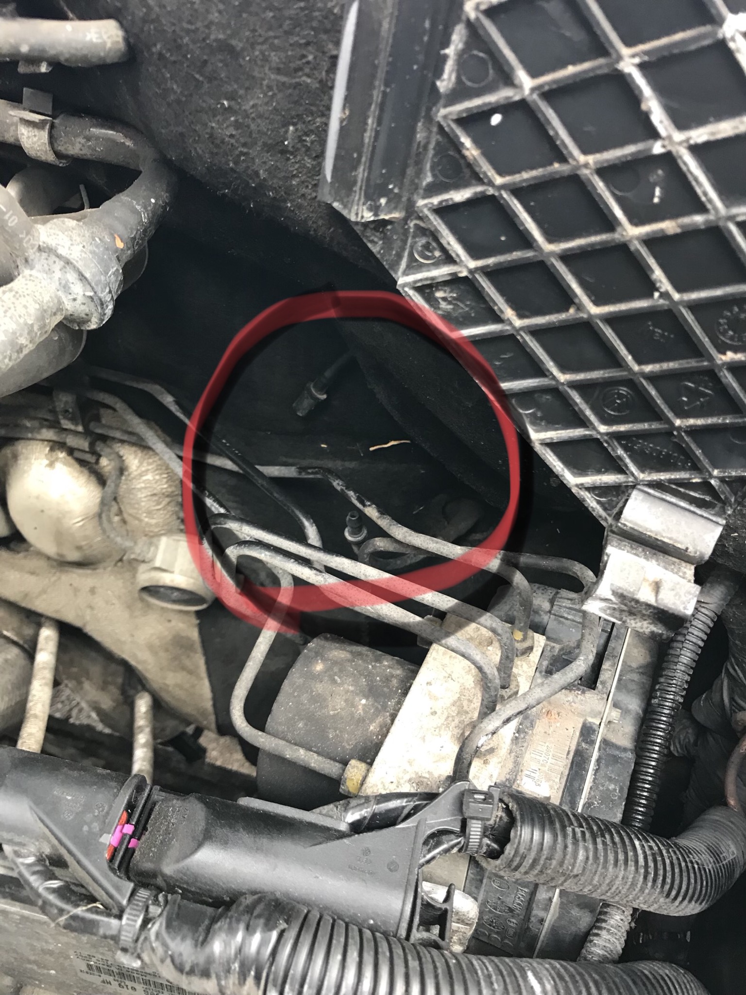

have dug a little deeper to check wires under battery n found 2 more earth points by the ecu which I’m gonna clean now. But I have found this in my dig but what is it? Obviously it should b connected n I don’t think I disturbed it whilst digging.. is it for the washers or vac?
Washers.
  • Sponsor
Rear.
^^^ What he said.
Lol thanks all, doubt that’s my problem then but on the plus side I now have rear wash wipe..
