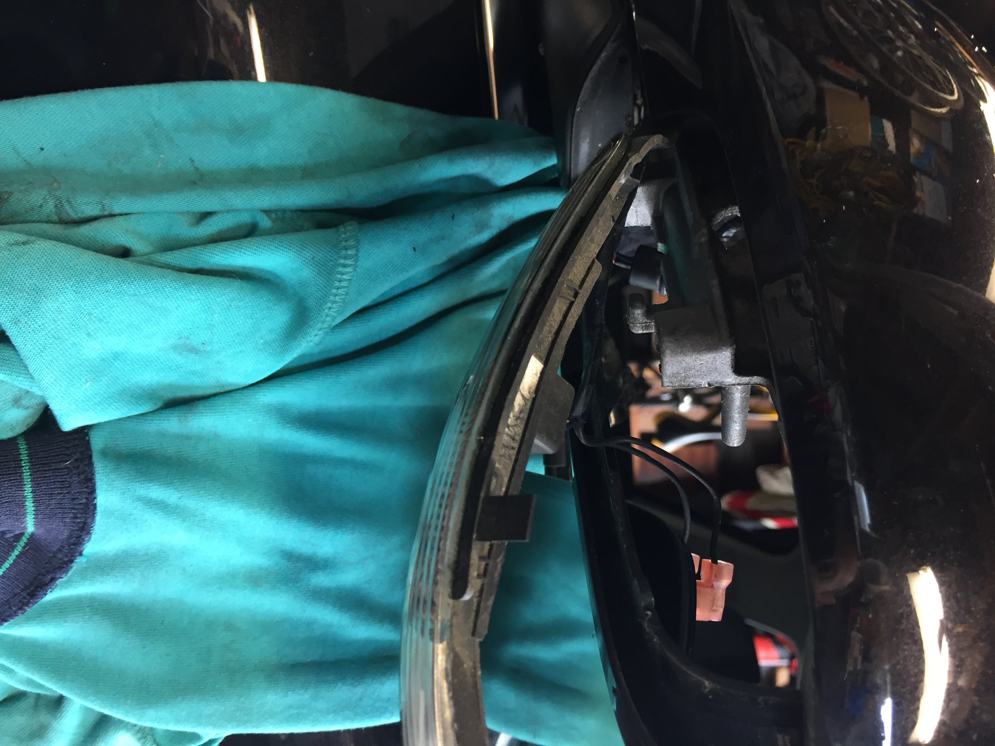

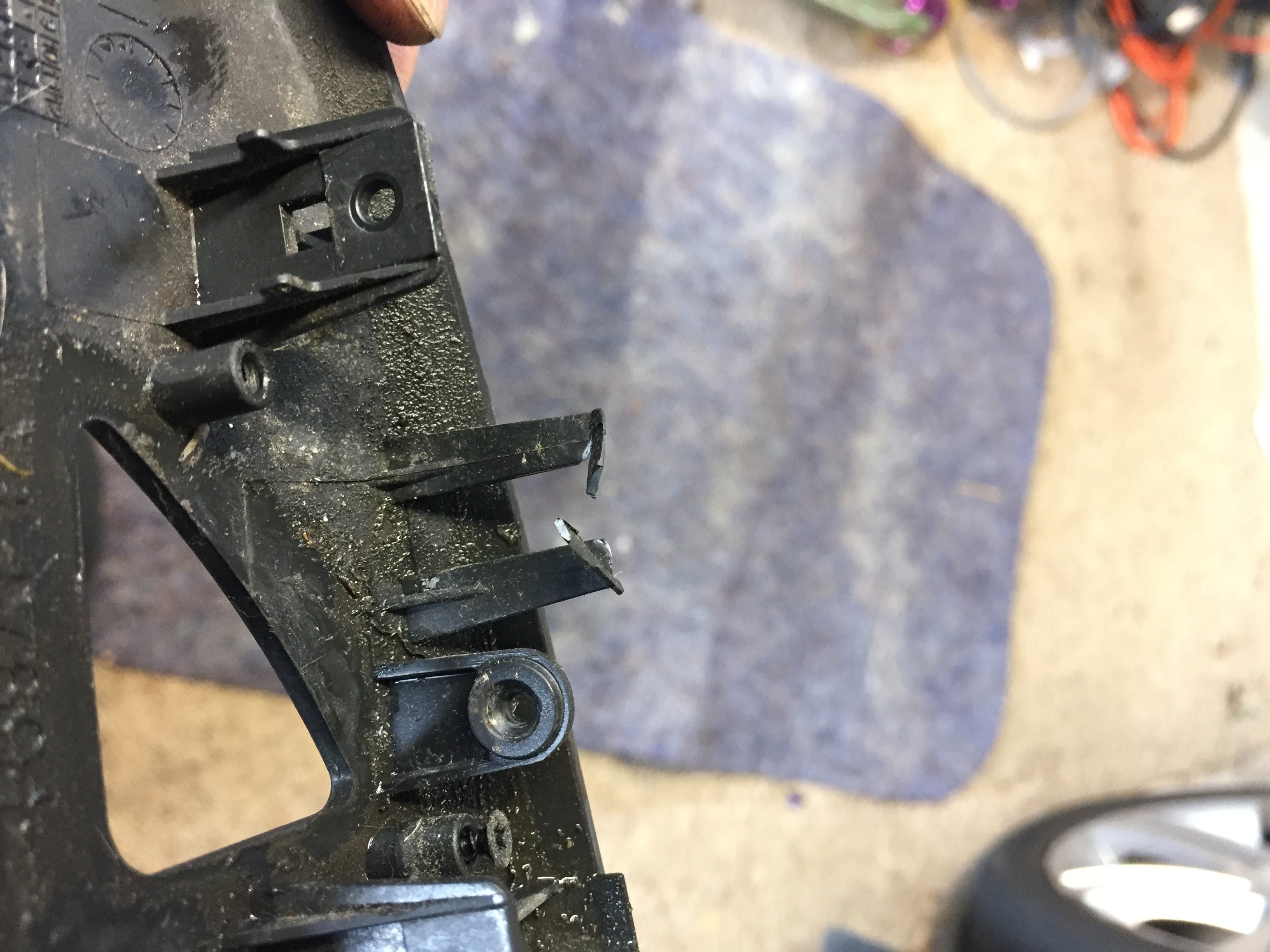

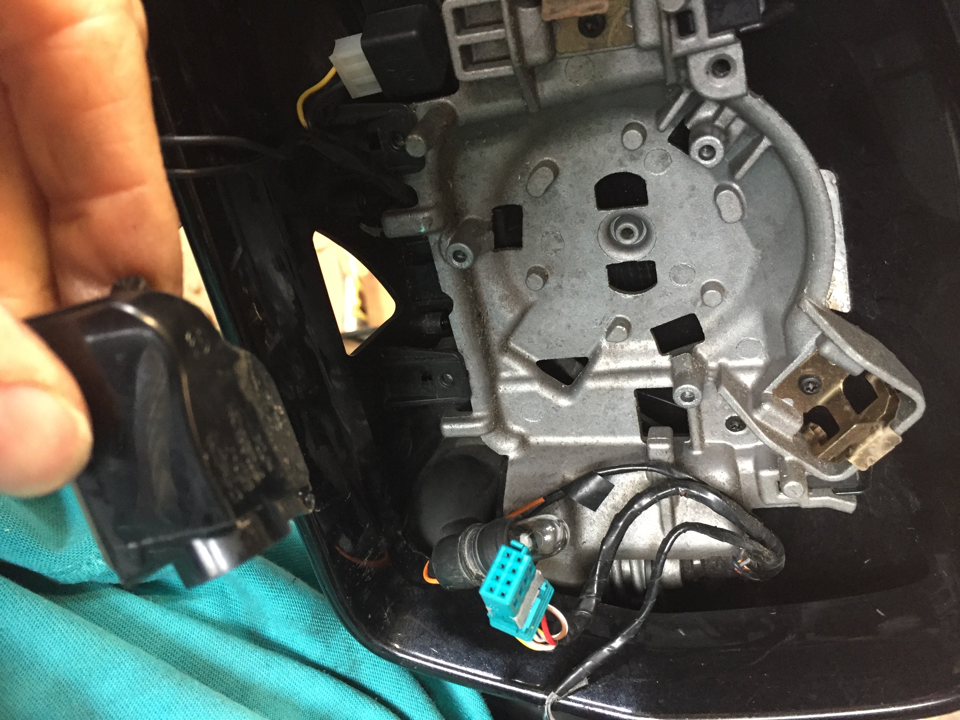

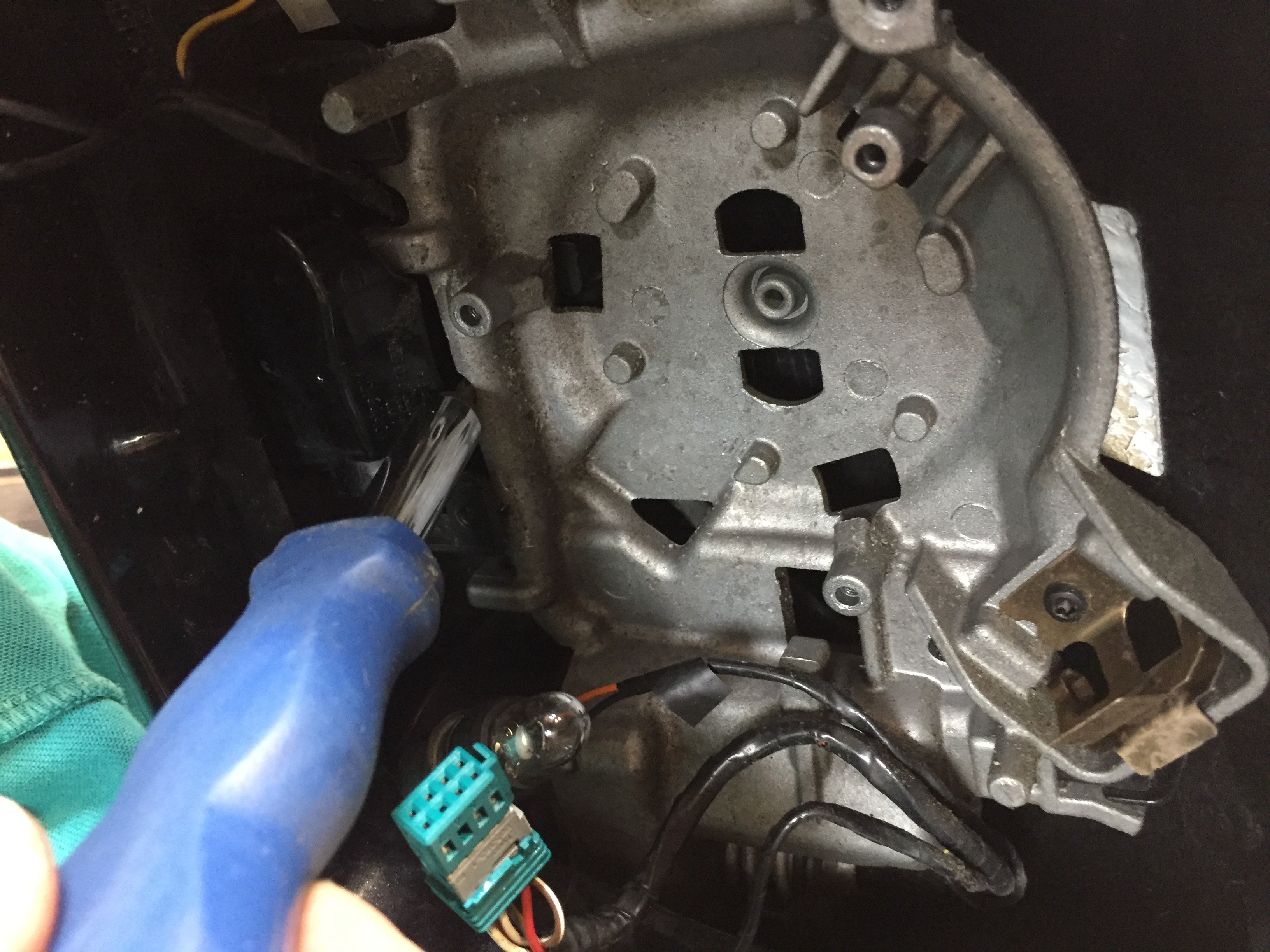

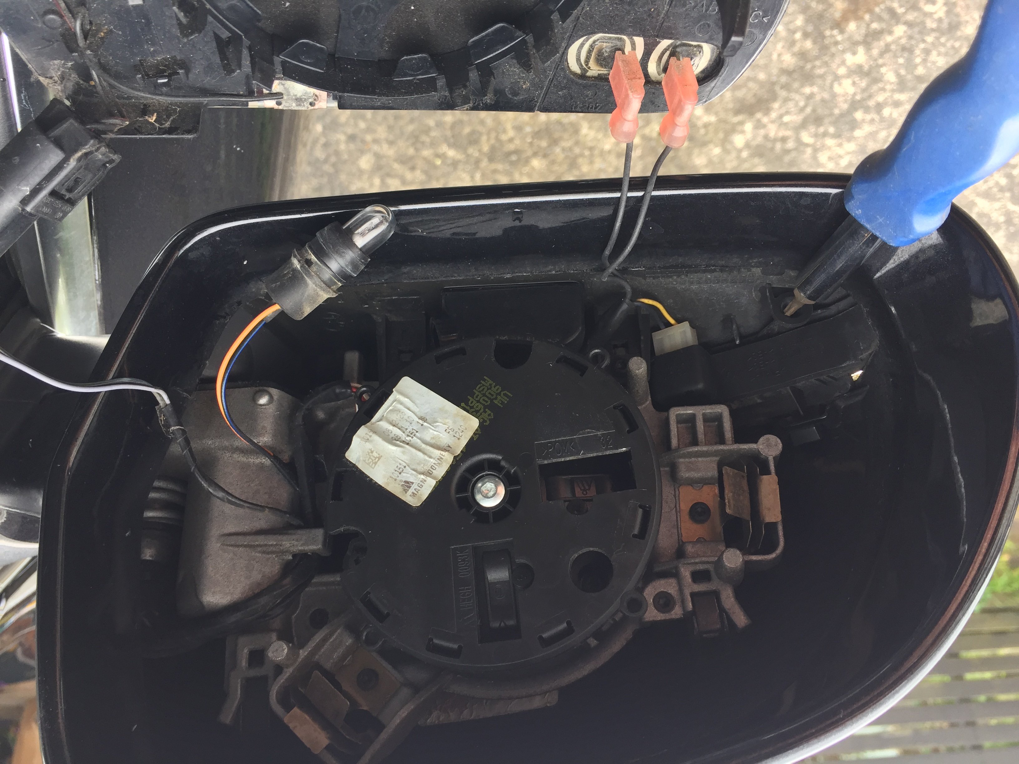

Hi, I recently replaced the same in my left hand mirror. Got the part cheap from superskoda (15euro).
The job itself was a right pain in the ass, hidden bolts and fiddly. I ended up breaking a clip as I thought I'd removed all the screws. Having said that, I'd do it again, but take more time!
Here are some photos that I took that might help you!
Matt
