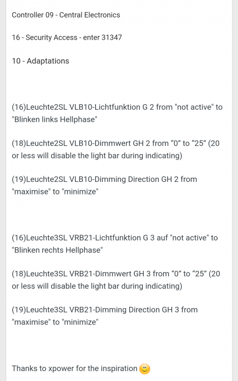

Could someone please explain me how can I know what light or bulb corresponds each "leuchtexxxxxxxx" in obdeleven 09 controller adaptations?
Thanks in advance
Google translate can help.
Yes you'r right. It can helps with the functions or translating what does "dimmwert" mean. But what about the "leuchte 2SL VLB10" that I supouse it is left or right DRL and
"Leuchte 3SL VRB21" the other one.
Thanks for your fast reply
dimmwert is the setting that determines how bright the lamp will be for that function - 25 is approximately 25% bright etc.
