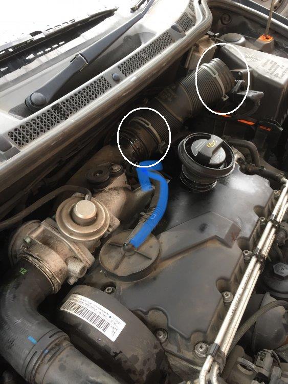

So the rac and a local mechanic have been out. The car turns over and will start but then judders and cuts out. When disconnecting the pipe that come from the top of the engine into the air flow bit (not to technical with engines) it will run. Reconnect then If you take the oil filler cap off the engine will run lovely. No smoke from exhaust. Pressure coming from the oil filler as putting the cap back on blew the dipstick out along with a load of oil and nearly for the mechanic in the face.

Air is flowing along this pipe. Disconnect it and engine runs fine. Put back on and it cuts out.

The blockage will where the pipe enters the plenum.

Take the pipe off where you have drawn the arrowhead and see if it is clear
That’s where both mechanics took the pipe off. At the arrow head end. So air getting to that end. So check where it enters the unit - so after the arrow head?

The bit where the pipe plugs into, the pipe, the cap the whole lot need removing and cleaning thoroughly to ensure they can cope with the gasflow.
@SamCoal - A day late more or less, but a second for the advice you've already got.
Looking at your pic I note the main air intake trunk from the airbox has been partly removed. Deliberately, by the position of the clips. I assumed that you know this and its part of the investigation of the fault. But if it isn't deliberate then it will mess up air flow sensor readings causing rough running. Needs reconnecting.
I have a bad feeling that sufficient crankcase pressure to eject the dipstick is a sign of more serious problems
Yes that was the rac chap who clearly didn’t reattach. Will get husband to do that properly later. Thanks! Good spot
