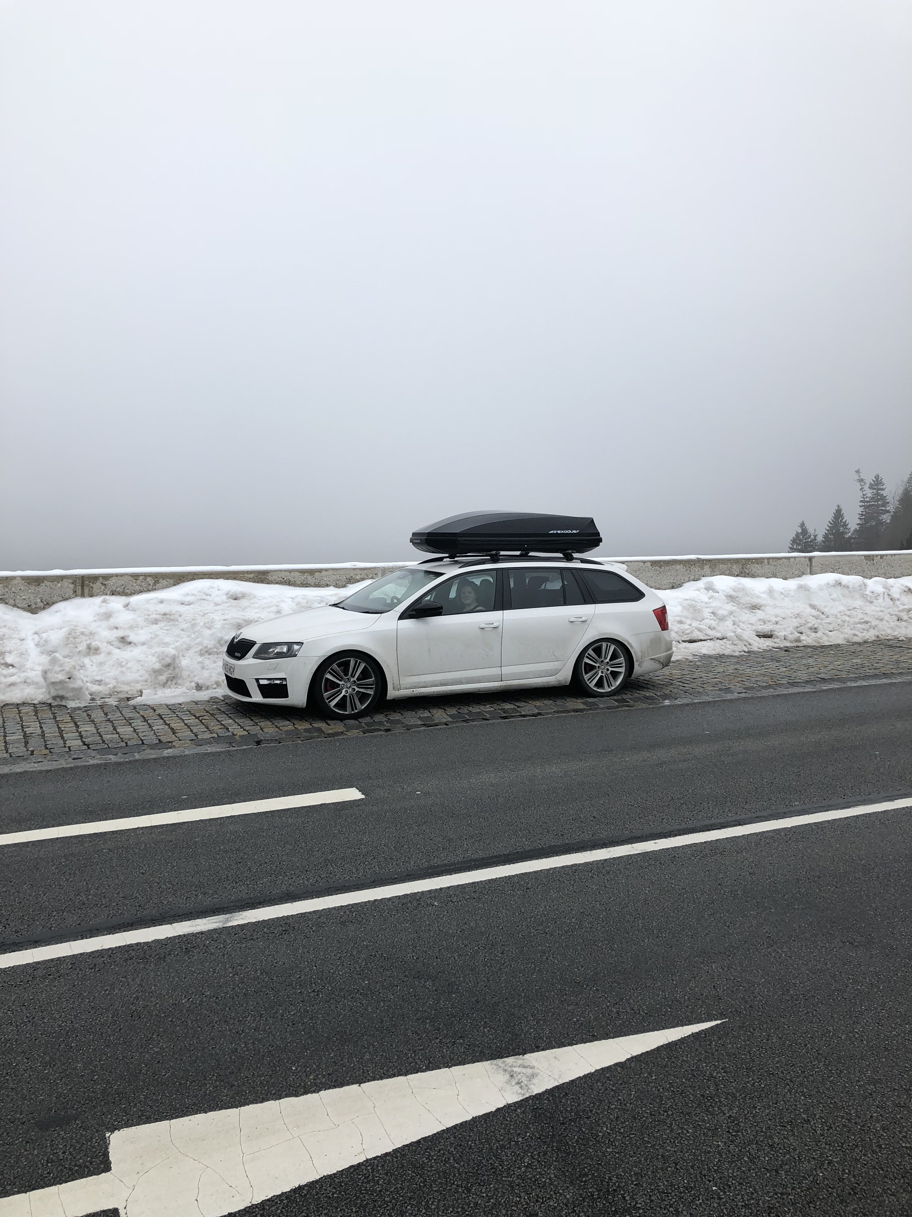

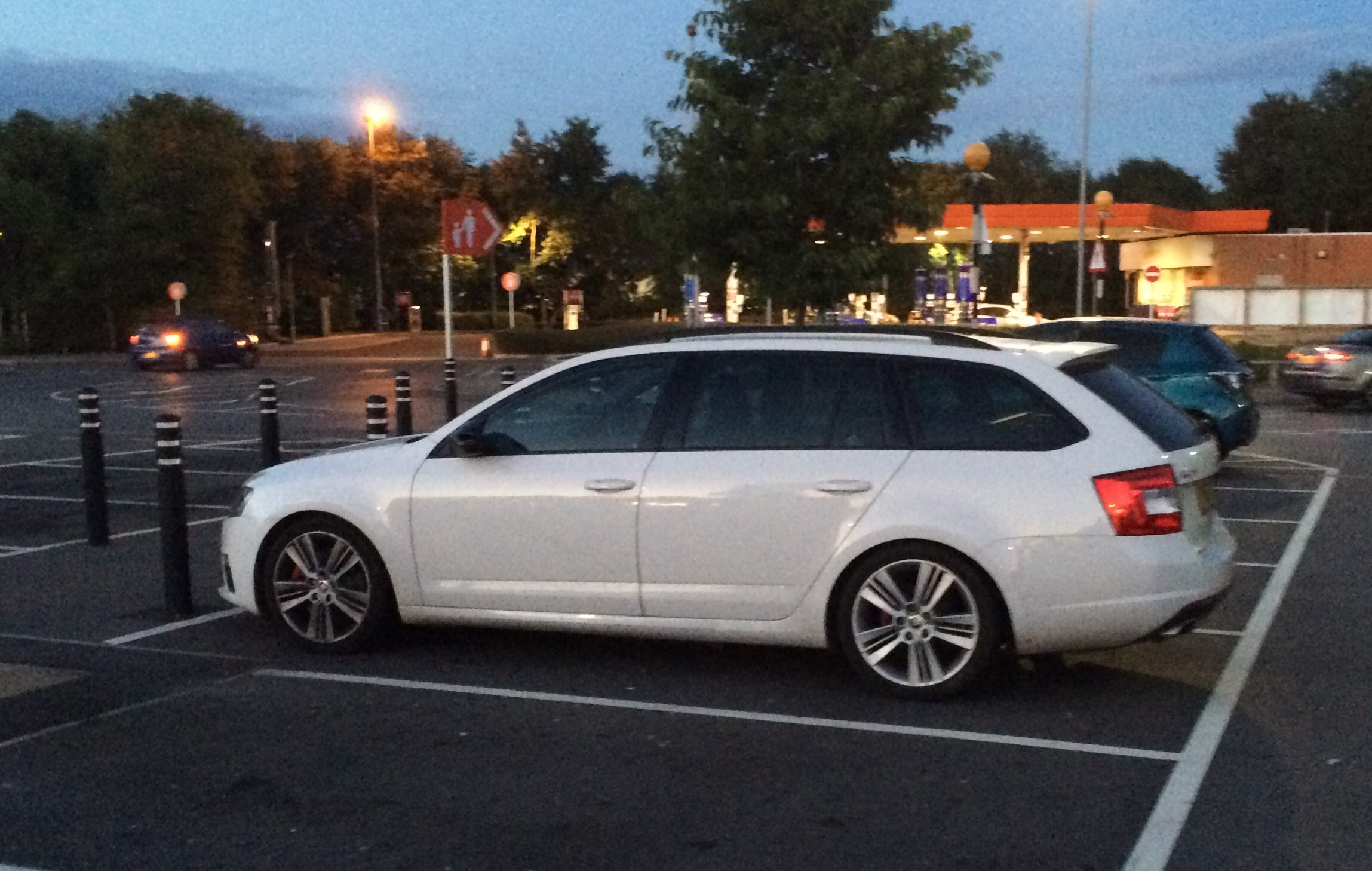

Just get the H&R no messing and they are cheap on eBay.de. 28833-2 I think they are. They are just low enough to fill the arches. Most speed humps are fine and don’t scrape but quite a lot of kerbs in car parks catch the front number when you park head on. You’ll do that twice and then learn haha. I’ve had mine on for best part of 70k miles and no bother at all with shocks. It also rides well when loaded too.
Looks great although a little low for my liking, is that picture fully loaded and what was the drop on those springs?
Ahhh yea that’s fully loaded with ski and board kit and 2 kids and a wife. Drop on a vrs with H&R is about 25-30mm

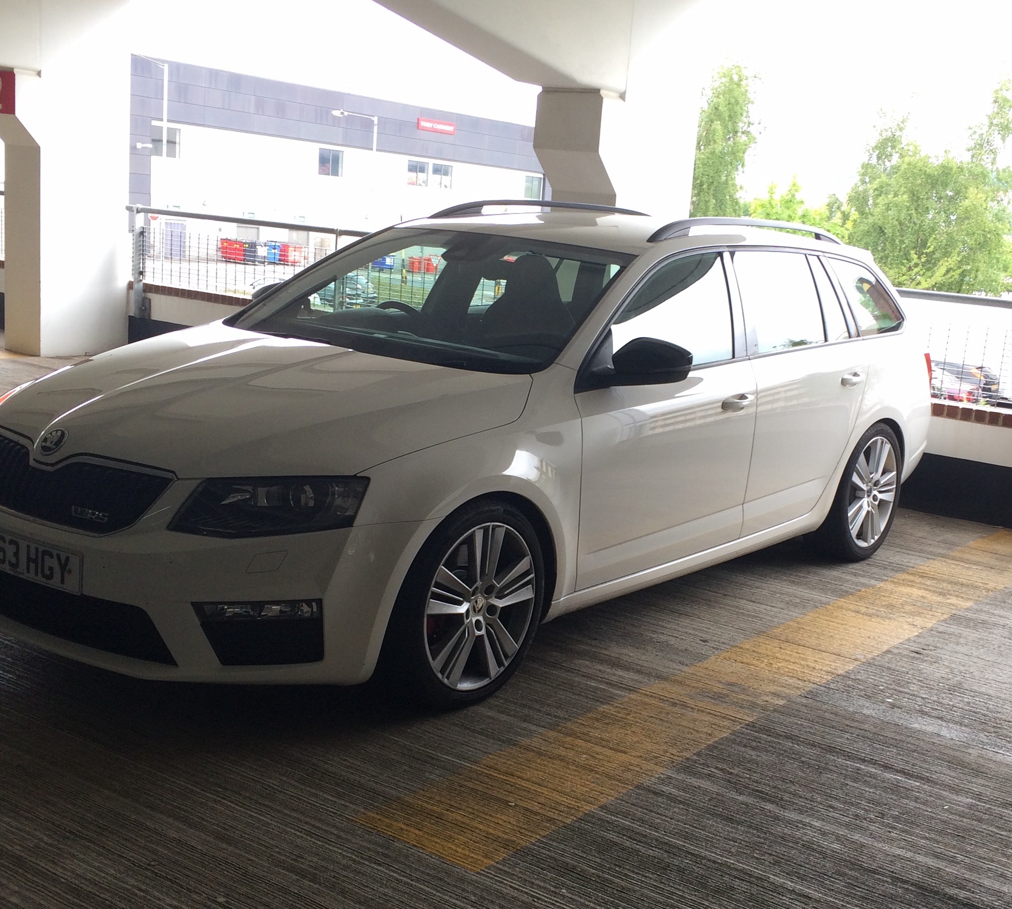

this is with 12mm and 20mm spacers on. Didn’t really like the feel with 20mm on so it has 12mm all round. Bottom pic
