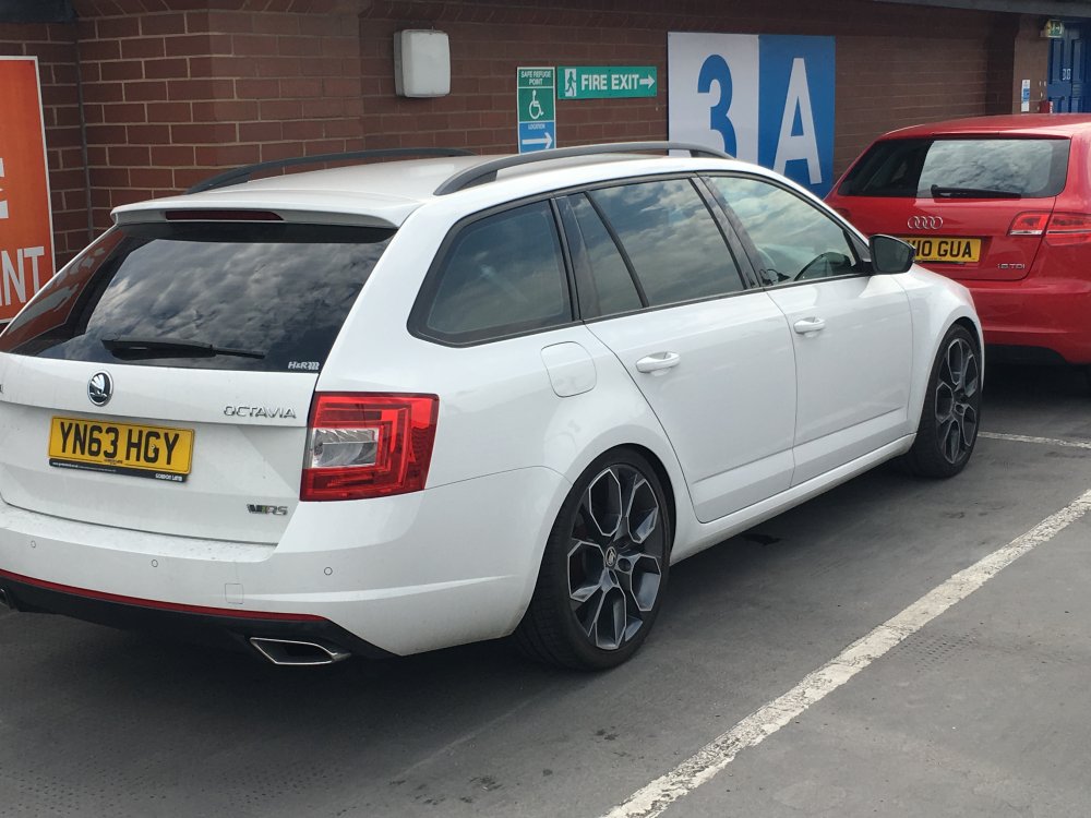

Lowered with H&R and do pretty much everything you have said. Roofboxes, children, snowboard gear trips to car fest, trips to Austria and cannot fault the car one little bit
Looks great. That's good to hear, so no scraping or bottoming out? What drop do you have? And what size wheels?
Edited by Danhod
Looks great. That's good to hear, so no scraping or bottoming out? What drop do you have and what size wheels?
wheels are 19" with 12mm spacers all round and I do run original 18,s with winters on too

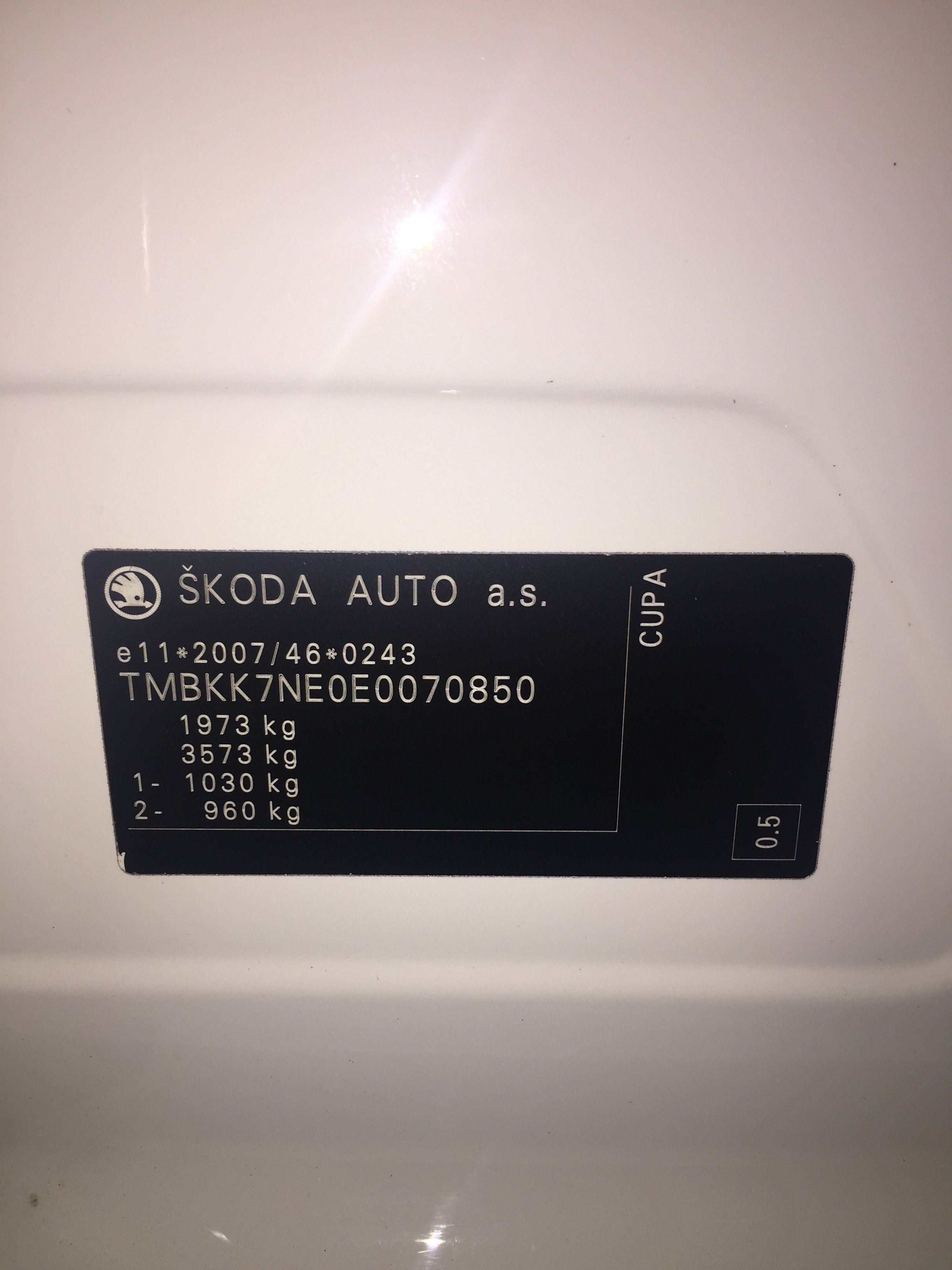

Where do I find my axle wieght to know which to order
On the drivers side B-post.
Yeh got it what’s bit am I looking at the 1- or 2- ?
1 will be front axle and 2 will be rear at a guess.
H&R part numbers are  28833-1 and -2
Yeh both seem to be for same load rating up to 1010kg so am guessing that’s the ones I need as the front axle says 1030kg on the car?
