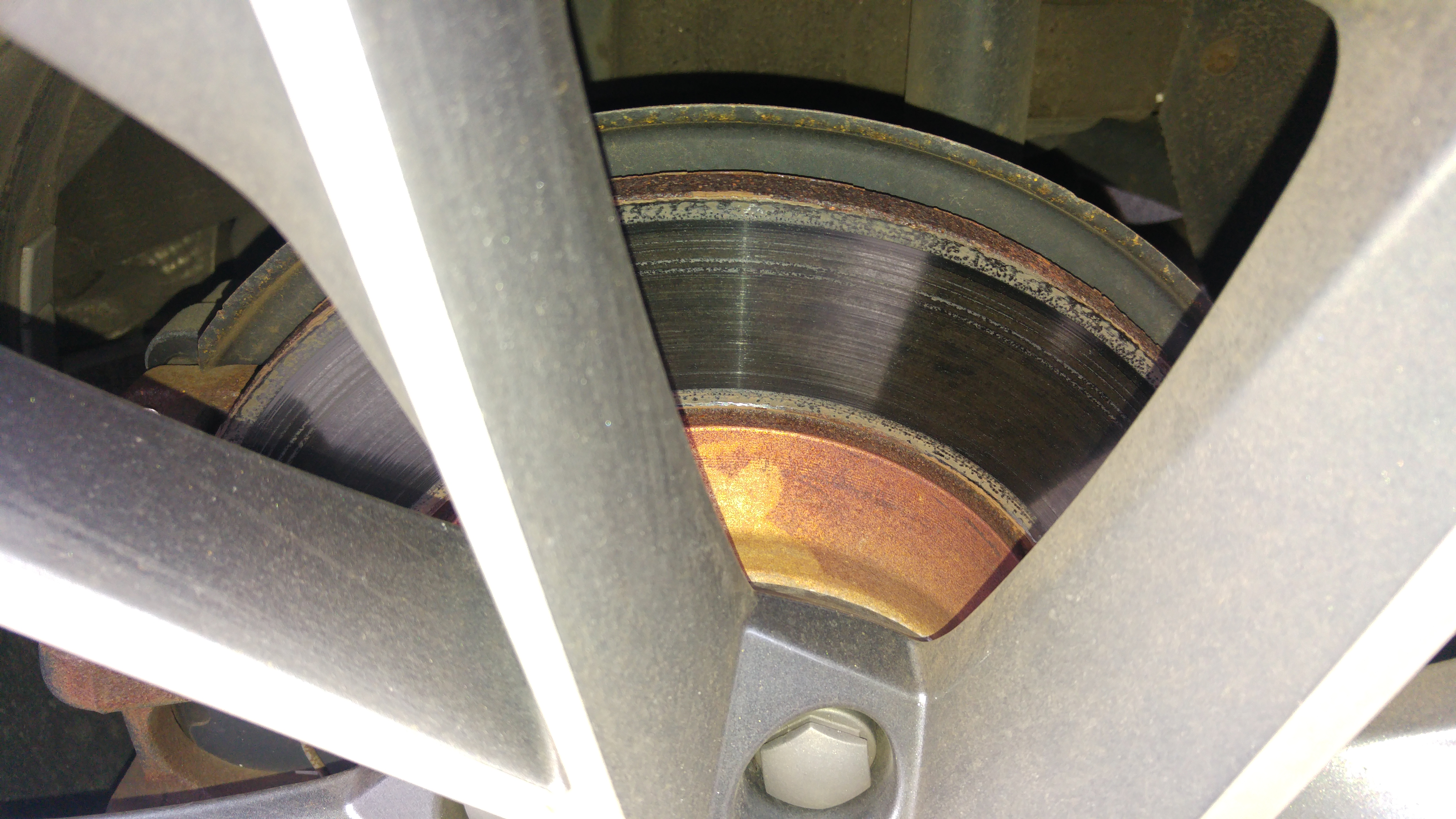

My car is a 66 plate and covered just shy of 9000 miles.
Attached is a picture of one of my rear discs. The other disc is the same. Is this level of corrosion on the surface and disc edge normal and acceptable for the cars age and mileage?
Aesthetically the discs look awful for a car thats not used heavily but aside from this im concerened that once the cars 1st MOT is due i will receive an advisory regarding the deteriorating condition of the rear discs.
Are all other superb suffering the same?
Based on what mine looks like this is not great if I am honest.  I see that this is a Sportline Superb, not that that makes any difference.
Maybe a lack of use hasn't helped on the discs face on the edge, always a good idea to use the brakes hard now and again as the rears never do much work anyway.
I haven't got a picture of mine but mine is a 17 plate and is now 12 months old.  Done about the same mileage, 8.5k approx if I remember correctly.
I'd be a little more concerned why the brake caliper and hub of the disc looks as it does:wondering:
Did you purchase the car second hand, if you don't mind me for asking?  This has tell tale signs of a steam cleaner been used and they have taken off the protective surface of the hub and caliper!
You see many cars second hand that look like this, with low miles from all manufacturers, because of how it has been prepped.
This has been covered before here -
To be honest, as time goes on I have found that the condition improves with use.
Yes it was second hand ex dealer principle car 6 months old.
When the car is used i brake heavily but never appears to 'clean up' the discs at the rear.
This car is just a bad example. Was really cleaned up when purchased but shortly after the corrosion was as bad as it is now. I took the car back and questioned that im concerened about the level of corrosion but was typically informed "its normal for those parts to corrode". I.e. we have your money sir so please go away.
Most modern brake hubs and caliper surfaces seem to corrode quickly and are much more visible now due to the design of alloy wheels.   Your image shows an unusually high level of corrosion mind you for such a newish car and as RGKTSi mentions above , there has possibly been an over zealous use of cleaning product used during previous ownership.   My own 280 Sportline purchased at 5 months old  / 5000 miles was beginning to show some light corrosion in same areas and the swept disc area also does not seem to 'clean up' under use to same level as front discs.  The latter issue seems to be common and difficult to prevent but the hub / caliper issue can be overcome with a bit of restorative work . I have cleaned up the hubs and applied a coating of Silver POR15 paint and have cleaned caliper surfaces and protected them with a light coating of ACF50 , which I have also used to protect a lot of the alloy components in the engine bay which unfortunately seem prone to oxidisation.   The rusty hub / caliper problem is not confined to Skodas  - I have seen same issue on fairly new 'prestigious' brands many times.

Mine were replaced last week due to this issue, 65 plate covered 73k.
Replaced due to the mileage? Or other reasons.

Corrosion. My car is still on the original front pads and discs, so the rears were very lightly used and corroded badly.

My rear discs look worse than that, dealer noted on its first service but lease company wouldn't replace:mad:

Mine is only a year old and my hubs are possibly worse in places. Funnily enough, a neighbour who has a Golf R, also fairly new, said to me the other day, that his discs were the same.
My rear discs were replaced at just over 17k and nearly 2 years old.  They were in a worse state than yours.  Luckily mye parts and service plan picked up the tab for the replacement but I doubt they'll last much longer than the originals.  I put it down to commuting outwith peak times and the DSG box of doing a pretty good job of engine braking meaning I don't have to use the brakes much.  Next time they'll be getting replaced by me for hopefully something of a higher quality/corrosion resistance.

Rust/corrosion on rear discs is not limited to Skoda or VAG. Loads of info out there to support that.
The most common reason given is that since the prohibition of the use of asbestos the specification of the metal discs had to be adjusted and this has increased wear/corrosion rates. I dont know whether that is the case but it sounds plausible.
The fact that not all cars, in a particular marque or model, suffer this degradation at the same rate also suggests that conditions in and of use are more important than the marque or model.
We had personal experience of this with an S type Jag some years back. I had a specialist examination made (metallurgical) only to find that there was no evidence of material defect. (i.e it was to spec)
So I might support an argument that car manufacturers should improve the quality of these components but to suggest that it is a cheapskate approach because it is Skoda misrepresents the reality IMO.
Edited by Sagalout
I don't think the brakes are an issue at all. I bet if you took a sample of cars that were say 5 years and had all done 100K, and put them on a ramp some would be like new and some would have obvious signs of rust setting in.
Its just how the conditions stack up during use.
If you look at the picture in the first post you can clearly see the caliper is rusting and the brake disc surround. If you go look at a car that still has a tidy looking caliper and a fresh disk surround you can bet your life the disc will be in good nick as well.

As I've said earlier in thread , this is not a problem unique to Skoda.  I've had same issue on a VW Golf GTD and a few BMWs plus noticed it on other Marques.  It's purely cosmetic of course and has no effect on performance or safety although I personally remedy matters with POR15 paint on brake hubs and a light coating of ACF50 on the Caliper Bodies.  These areas have always deteriorated with the elements but used to be covered up more with wheel design .

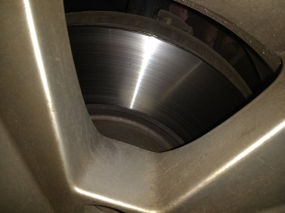

Managed to take photos of the brakes in the dark for what its worth...front nearside

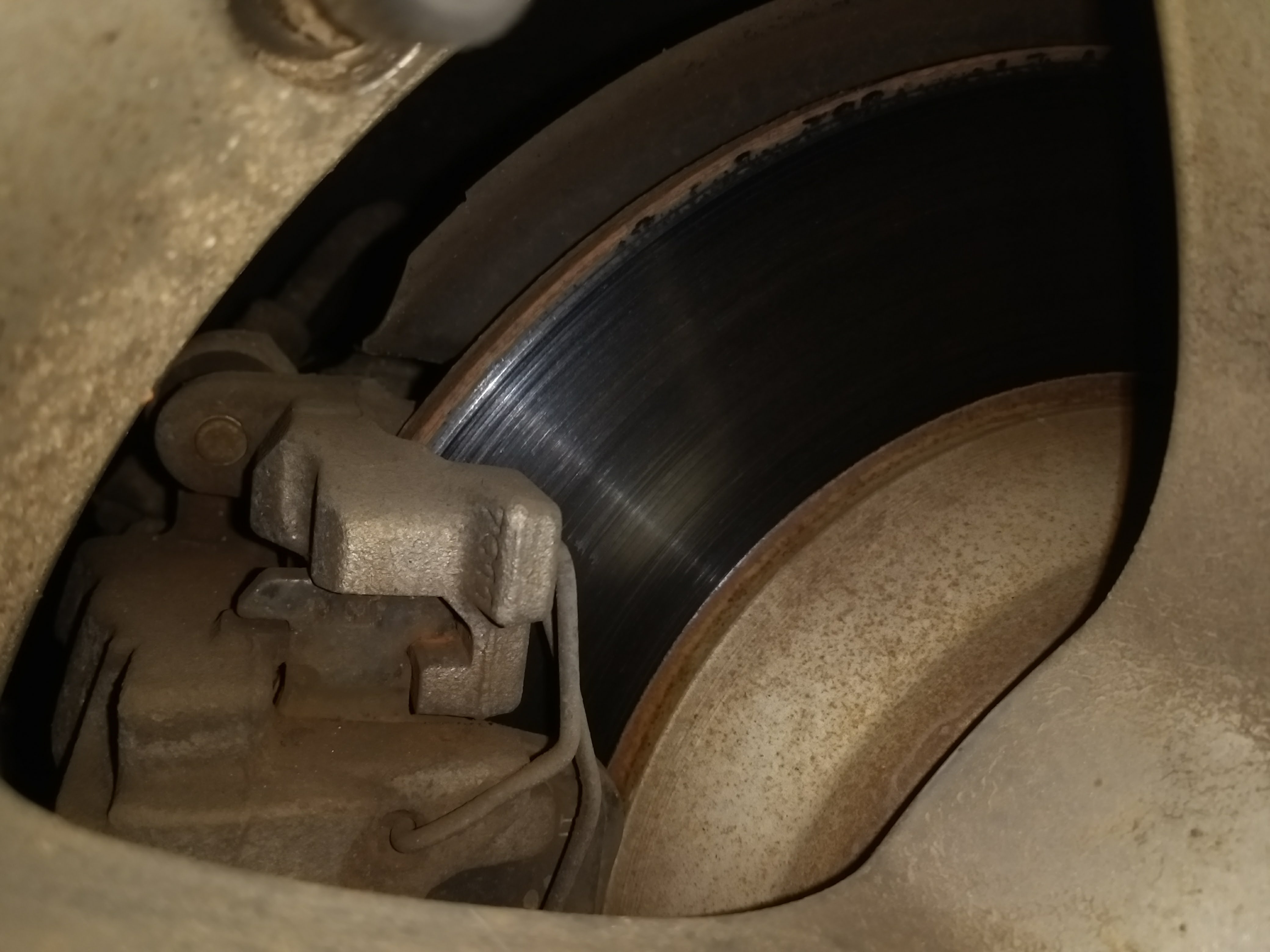

Rear nearside:
