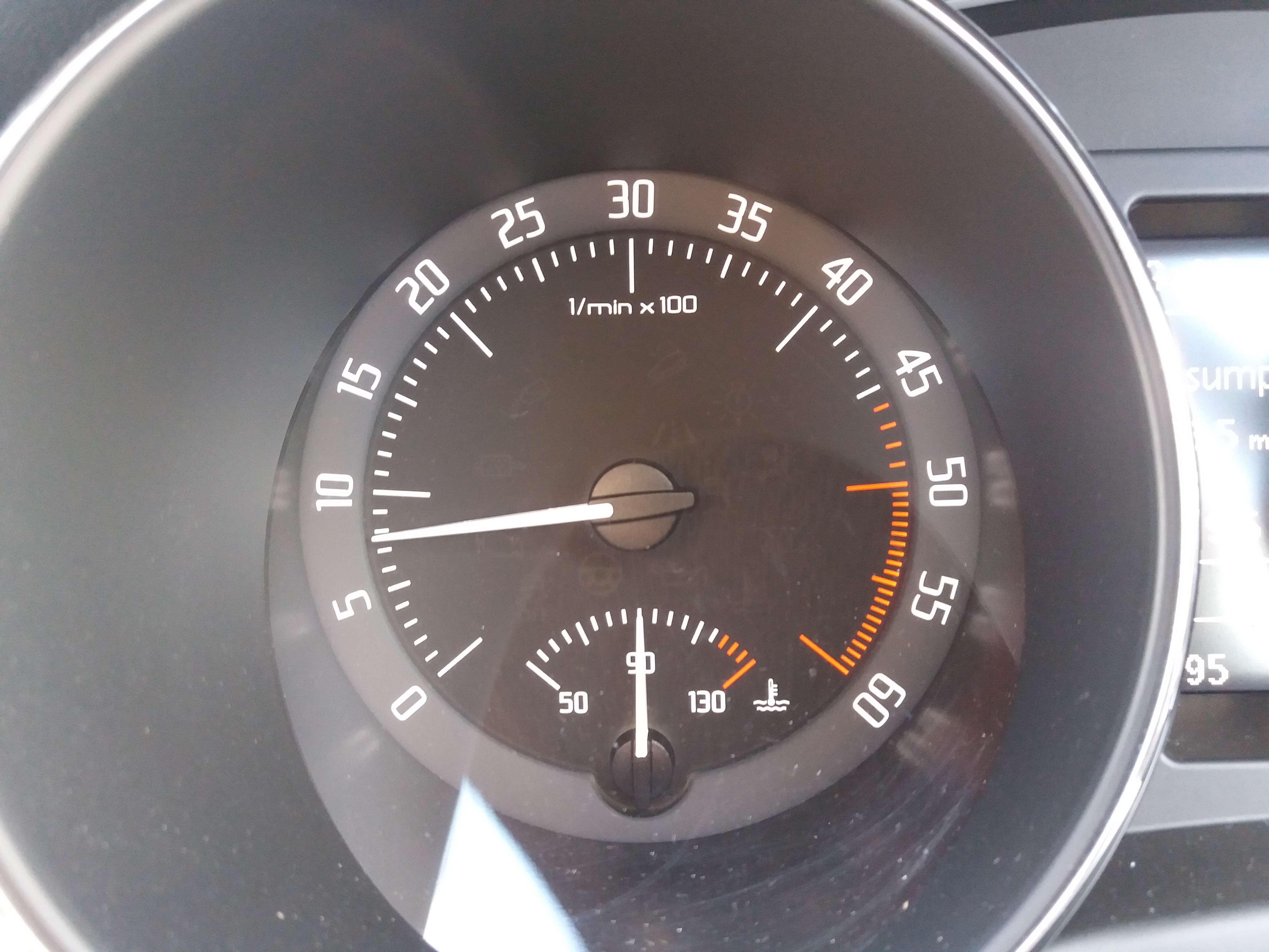

Around 900 rpm, just like in the photo above, slightly faster during low-temp season. I think official figures say +/- 50 rpm, so anywhere between 850 and 950 rpm is ok.

It could be as simple as the needle isn't on straight ;)

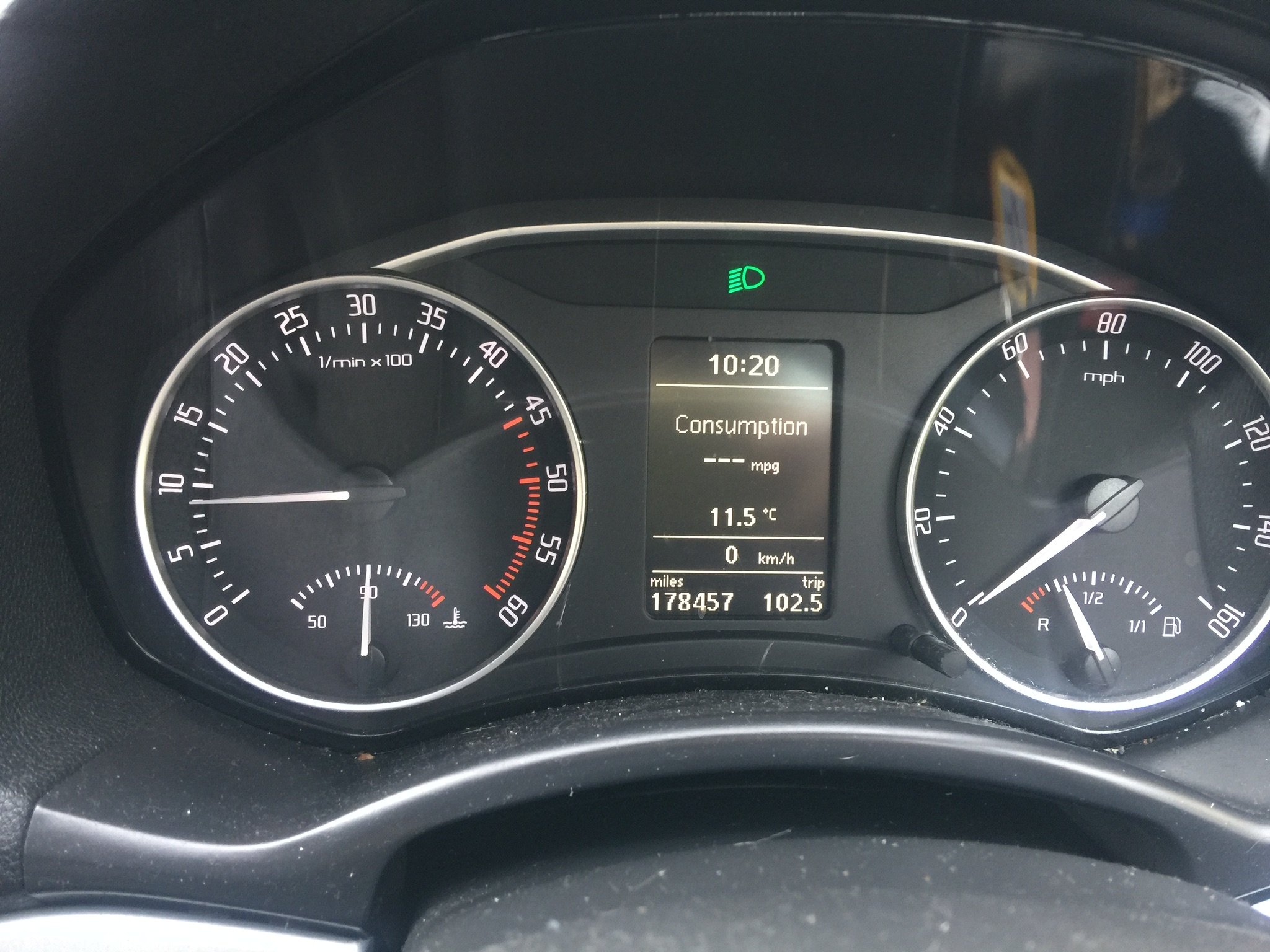

Here is my CR140 2.0 TDI, 2011, 140,000 miles.
The only time the RPM alters at idle is during a DPF regen or if the Climate Control is calling for heat before the engine is up to temperature, or if it begins to pull more heat than the car is generating.
