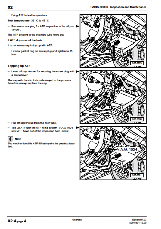

Hi, Not even sure what to say.  I have a 55 plate Skoda Fabia (a poorly one).  My very reliable mechanic wants to replace oil and filter of the automatic transmission gearbox due to various problems I have been having with car.  However, he is struggling to find any info on how and where to put replacement oil? It is a BorgWarner gear box not DSG.  I have been tasked to find info but have failed miserably.  He is wondering if it is a sealed unit and oil cannot in fact be replaced.  I am not mobile so really need this car back on road.....been looking at four walls now for several days.   The mechanic is superb and cannot do enough for me to help, but neither of us can find the relevant info.  This is my first visit to any sort of forum so apologies for my lack of knowledge of what to write!!
It's tricky, you need special equipment, suggest you simply get the mechanic to check the ATF level since an incorrect level will affect gear changes.
Wow that was quick.  Obviously the diagram means nothing to me but  thank you and I will get this to my mechanic as soon as poss.  By special equipment is it something reasonably small, reasonably priced and easily purchased?
No, but your mechanic will be able to figure something out from the diagram now that he knows where to look.

@sepulchrave - Many thanks for your reply.  The problem is now resolved thanks to your helpful advice. @JWvrs25 - You were quite right.  I was a little confused, it was reassuring to receive a response which recognised my lack of expertise but offered helpful support nonetheless.
