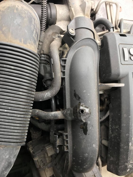

Got a 1.2TSI in a 62 plate Skoda Rapid.
Found this cracked after noticing some oil/dirt deposit by the top of the engine.  Connects to the air intake pipe between the top of the crankcase and the pipe.  Am I right in thinking this is the fresh air intake for the PCV system and not the valve itself?
  • 2 months later...
Yes, it is the fresh air intake, the pcv valve is on the side of the cam cover and has a small hose directly to the turbo.
And its code is PCV valve (Ventil) : 030103175B
