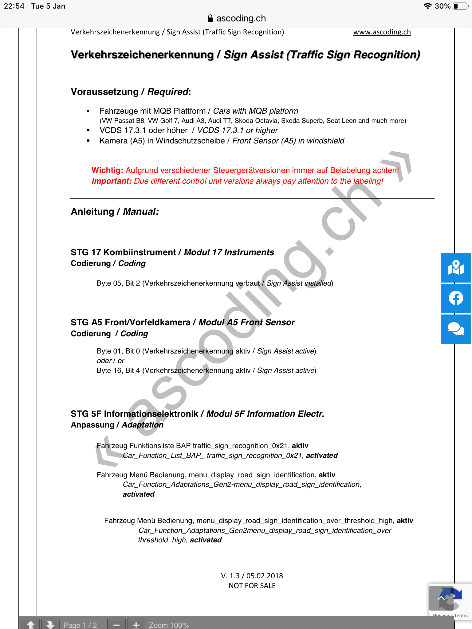

Hello,i have front assist,signs recognation,and back assit..but i dont have lane assist??how can i have it :)

Hove to activate it??i have blind spot,sign recognition,radar,back radar but i dont have lane assit??thanks

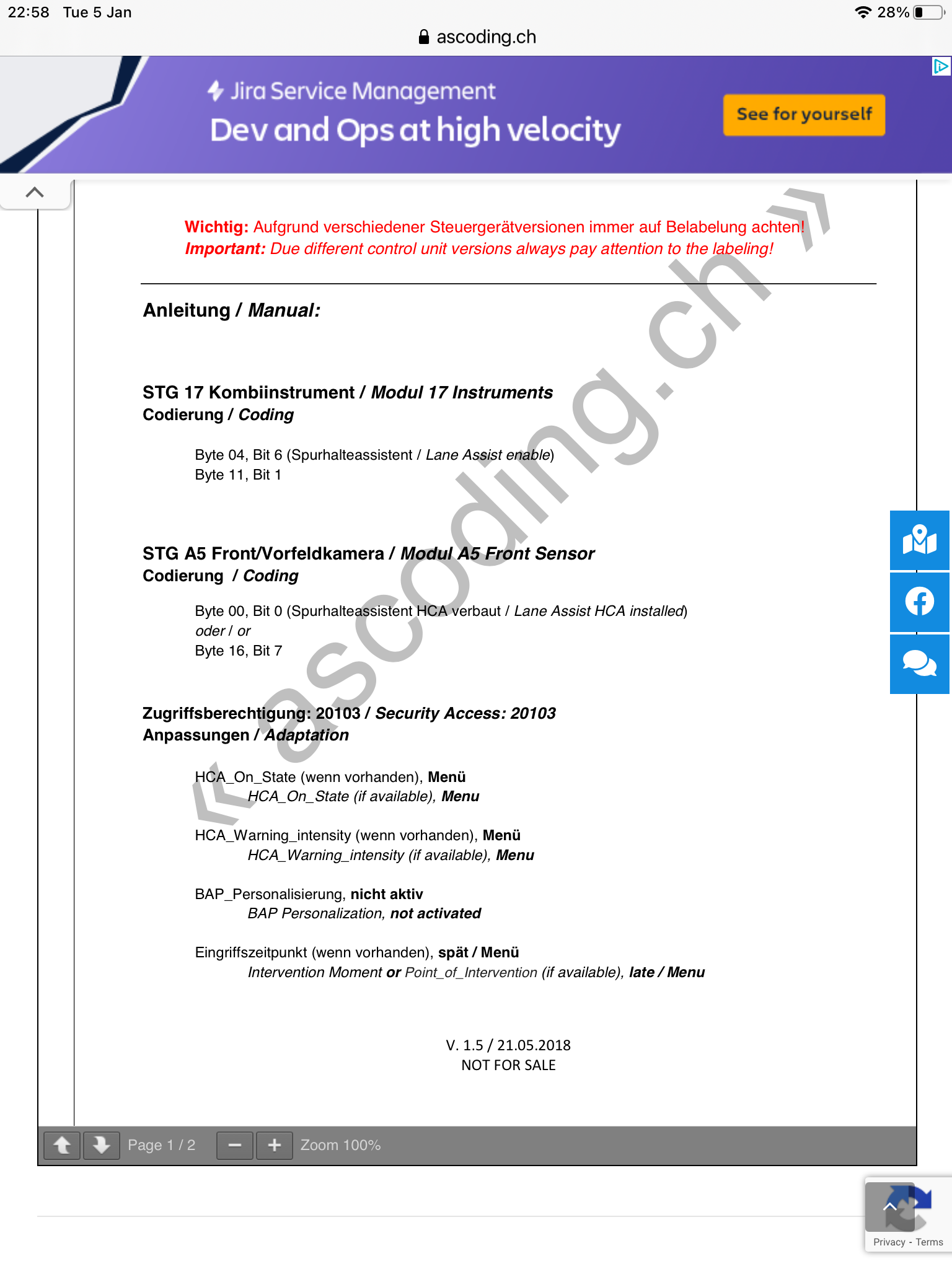

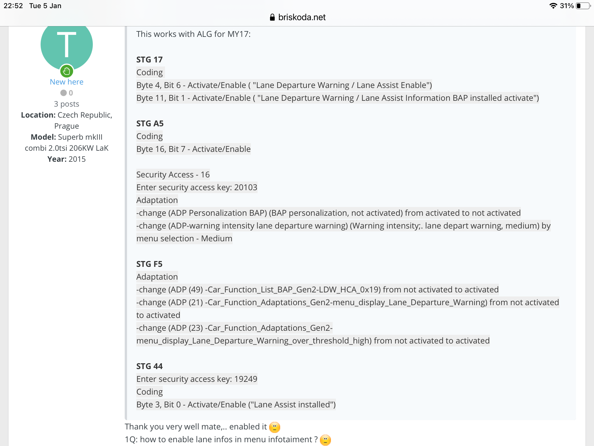

On 01/04/2018 at 16:39, Gy220 said:
This works with ALG for MY17:
STG 17
Coding
Byte 4, Bit 6 - Activate/Enable ( "Lane Departure Warning / Lane Assist Enable")
Byte 11, Bit 1 - Activate/Enable ( "Lane Departure Warning / Lane Assist Information BAP installed activate")
STG A5
Coding
Byte 16, Bit 7 - Activate/Enable
Security Access - 16
Enter security access key: 20103
Adaptation
-change (ADP Personalization BAP) (BAP personalization, not activated) from activated to not activated
-change (ADP-warning intensity lane departure warning) (Warning intensity;. lane depart warning, medium) by menu selection - Medium
STG F5
Adaptation
-change (ADP (49) -Car_Function_List_BAP_Gen2-LDW_HCA_0x19) from not activated to activated
-change (ADP (21) -Car_Function_Adaptations_Gen2-menu_display_Lane_Departure_Warning) from not activated to activated
-change (ADP (23) -Car_Function_Adaptations_Gen2-menu_display_Lane_Departure_Warning_over_threshold_high) from not activated to activated
STG 44
Enter security access key: 19249
Coding
Byte 3, Bit 0 - Activate/Enable ("Lane Assist installed")
Thank you very well mate,.. enabled it :)

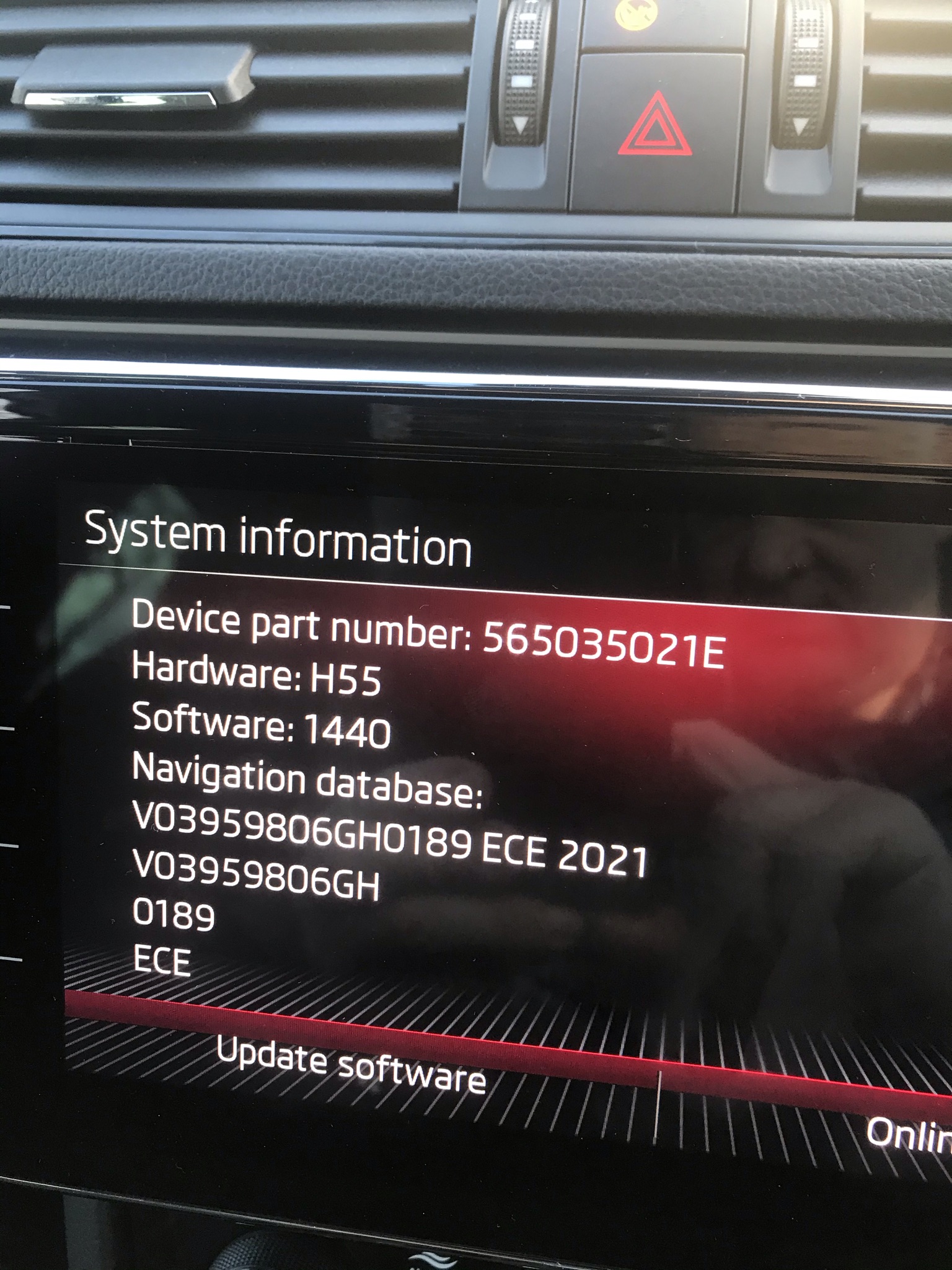

I have a my superb register Feb 2020 sport line 190 . It had the v5 camera for the headlight assist .  I am having a revering camera high line fitted next week. Will these coding on the vcrs activate the lane assist and sign assist.
cheers David
