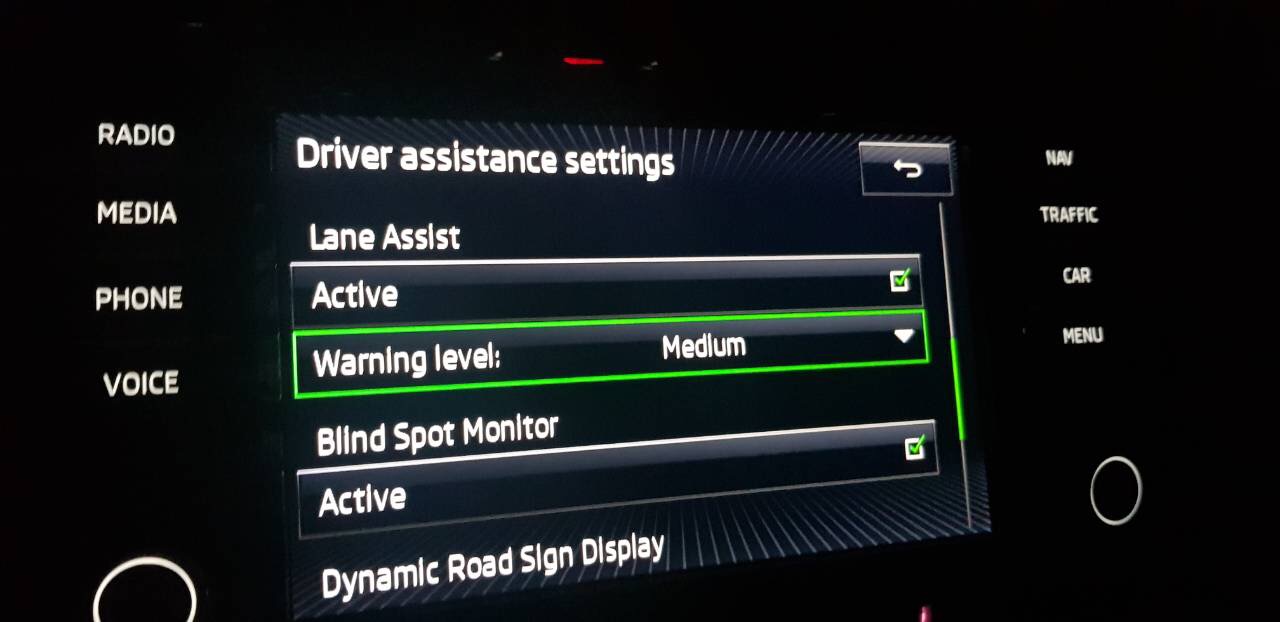

What options do you currently have in your radio for Lane Assist?
you should see a check box like this for ALG.......
As per JR RS’ picture you’re missing some coding.
