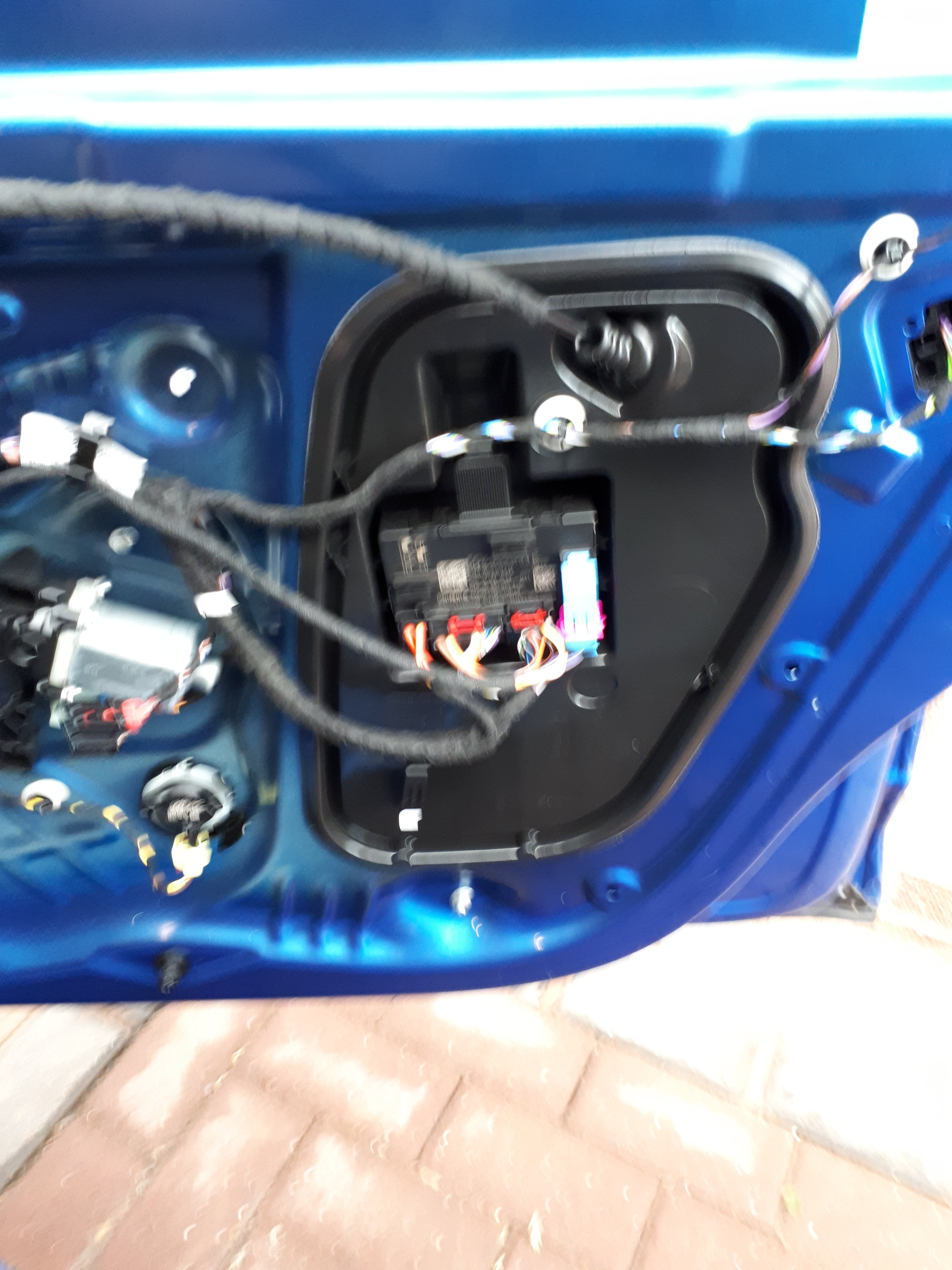

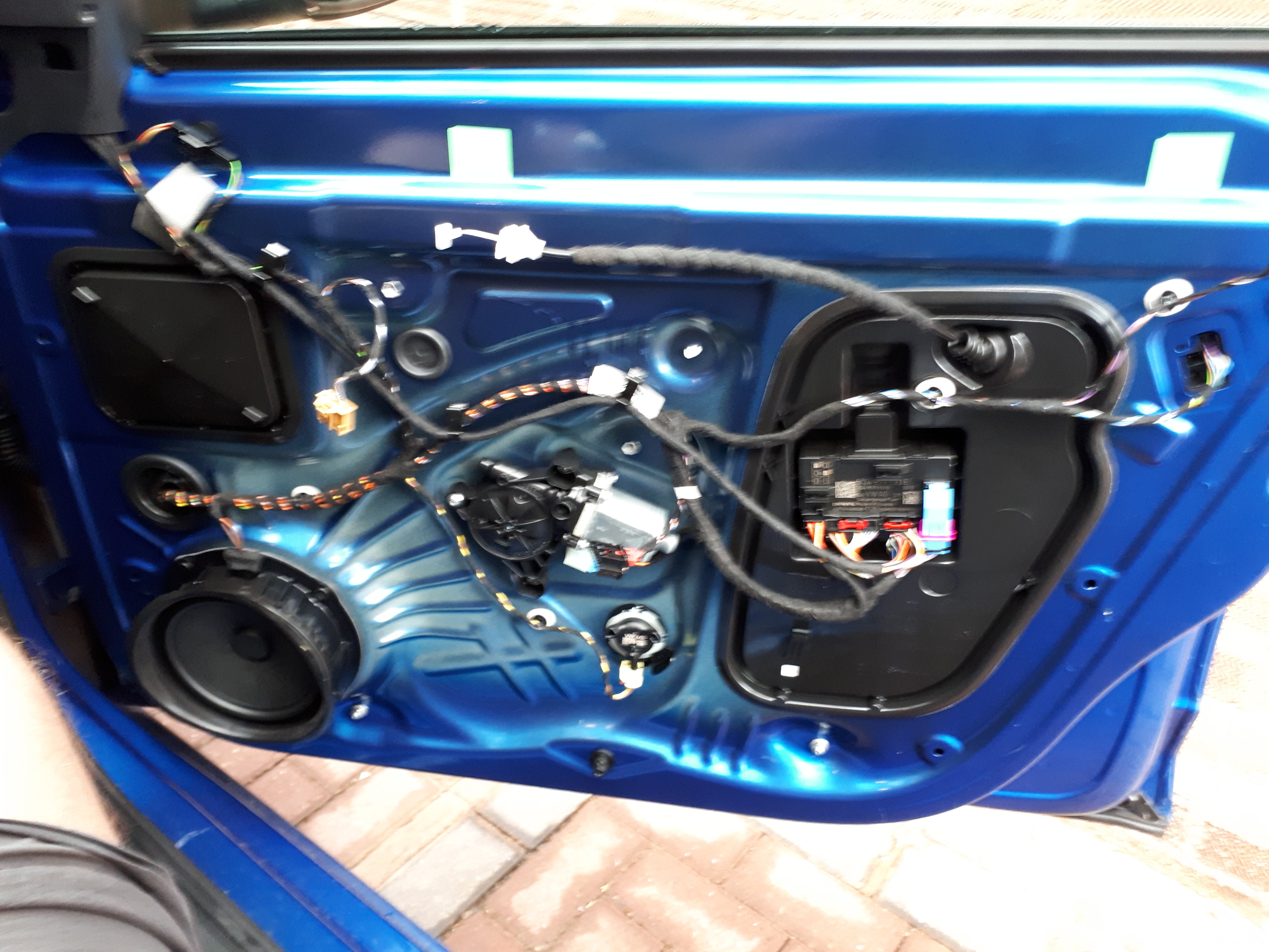

Took the door card off myself to pinpoint the issue and it is defo coming from behind the black plastic panel.
Anyone know how to get this off safely without breaking anything?
yes, you can unclip the wiring and remove the module, it's worth noting that the little box with wiring looms can rattle and the fix is to wrap the internals with Tesa tape. the black panel come off completely once you feed the latch cable through the grommet. I stripped all 4 of my doors down to sound proof them and it was an easy enough job.

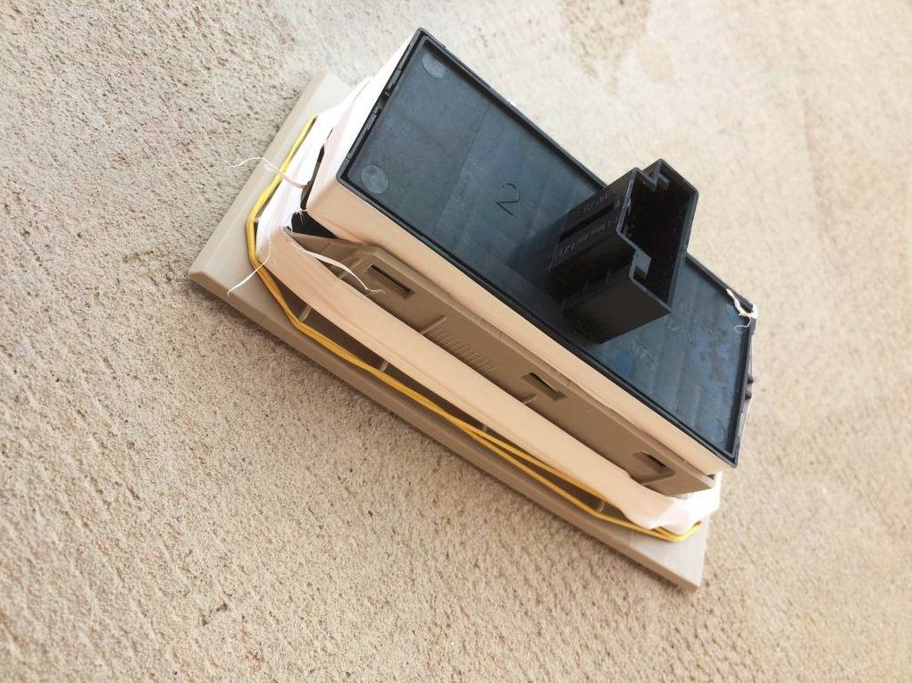

I had the same problem in my previous MY14 O3, and it was even worse (like yours) in my new MY19.
This time I used wire harness (cloth) tape to fix this, I did the previous fix with PTFE tape (as on the pic).
In my new car the switch was so loose that I managed to remove it without any tool. Some extra pull on the door handle and it came out just by hand.
Thank you Skoda.....
Ignore the yellow rubber band, that was my first attempt to fix the rattle which didn't help much.
O3-ablakkapcsol-tuning.jpg?dl=1
