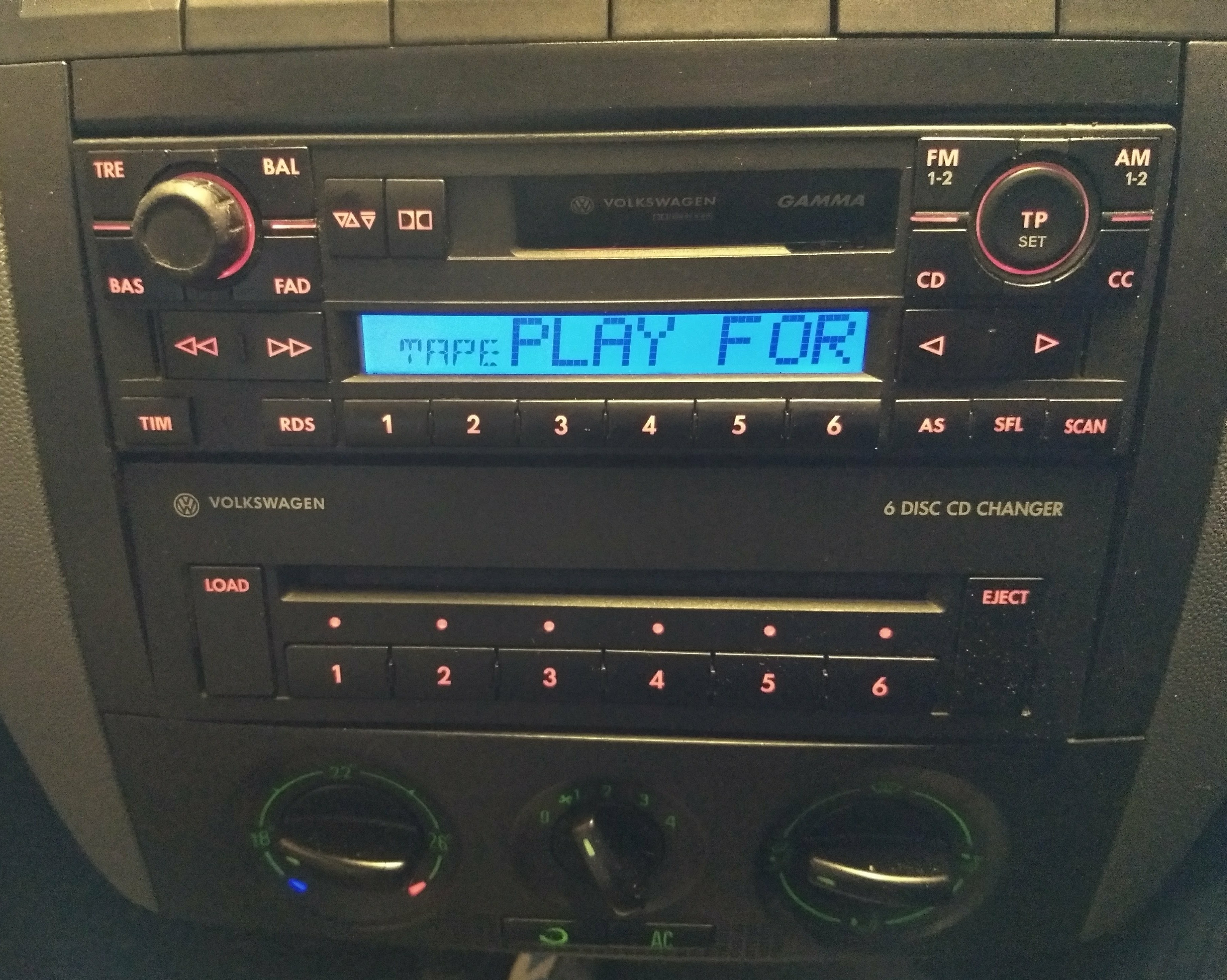

You can see it here on top of my retro cassette player. Notice a dash CD changer. Both are single din and fit perfectly into a double din hole.

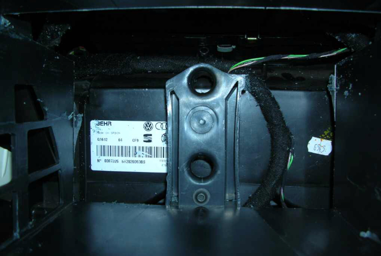

You may also find that you have to remove this support bit to keep the double din depending on how the wiring loom is made up, as I found when I installed one a few years ago.

The hole size if you take both the stereo and cubby out is that of a stock double din. Its only the face on the stock HU thats an awkward size. You have to get hold of the skoda upper trim piece for around a fiver to fille the gap under the array of buttons there.
I must say the black trim is much nicer than the silver in my VRS
Incase you need to remove the rear support in the hole. Its only plastic and can be cut with a regular soldering iron. I had to trim mine as I fitted VW items and needed a little space for wiring. Took seconds to cut and trim.

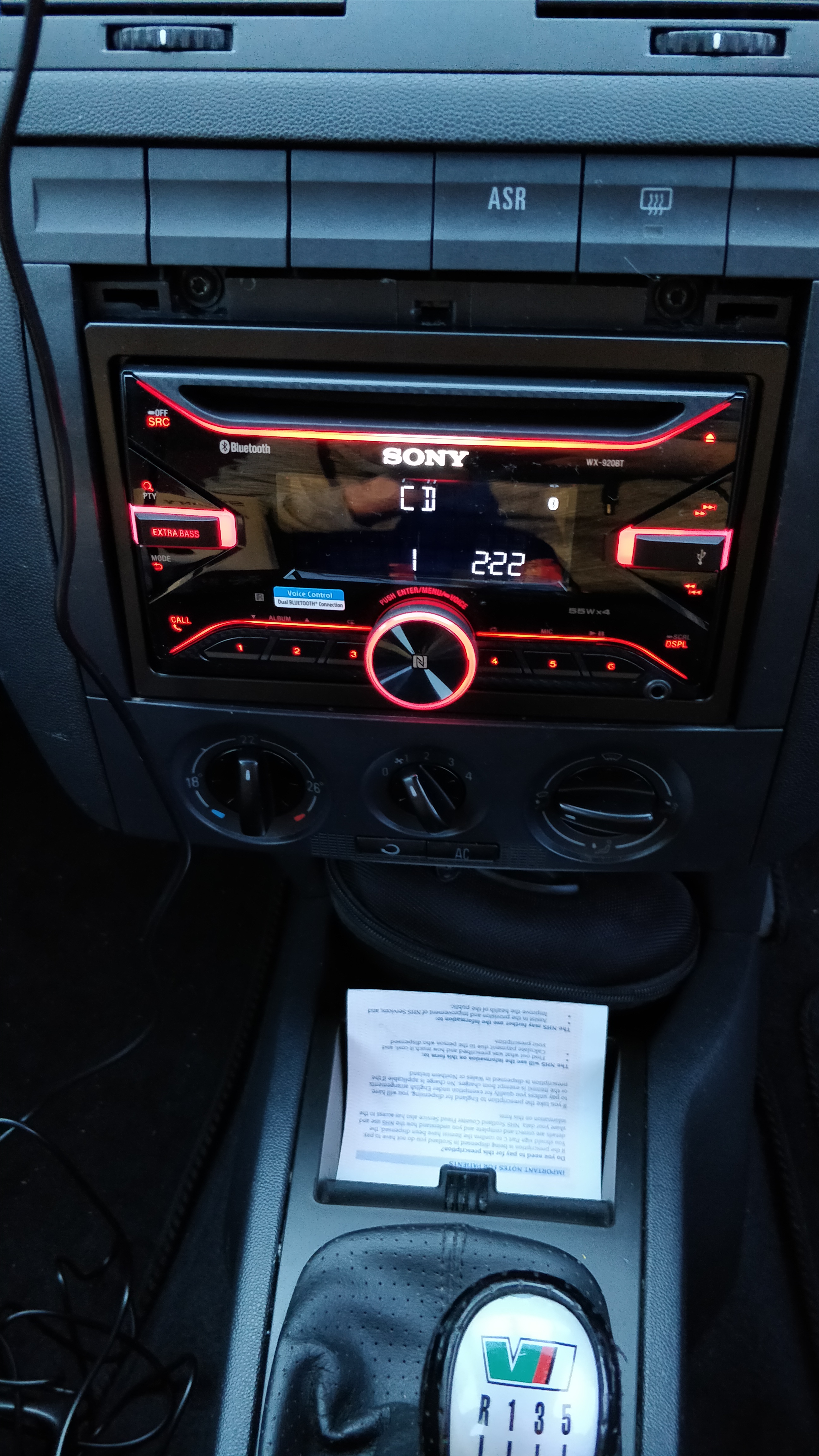

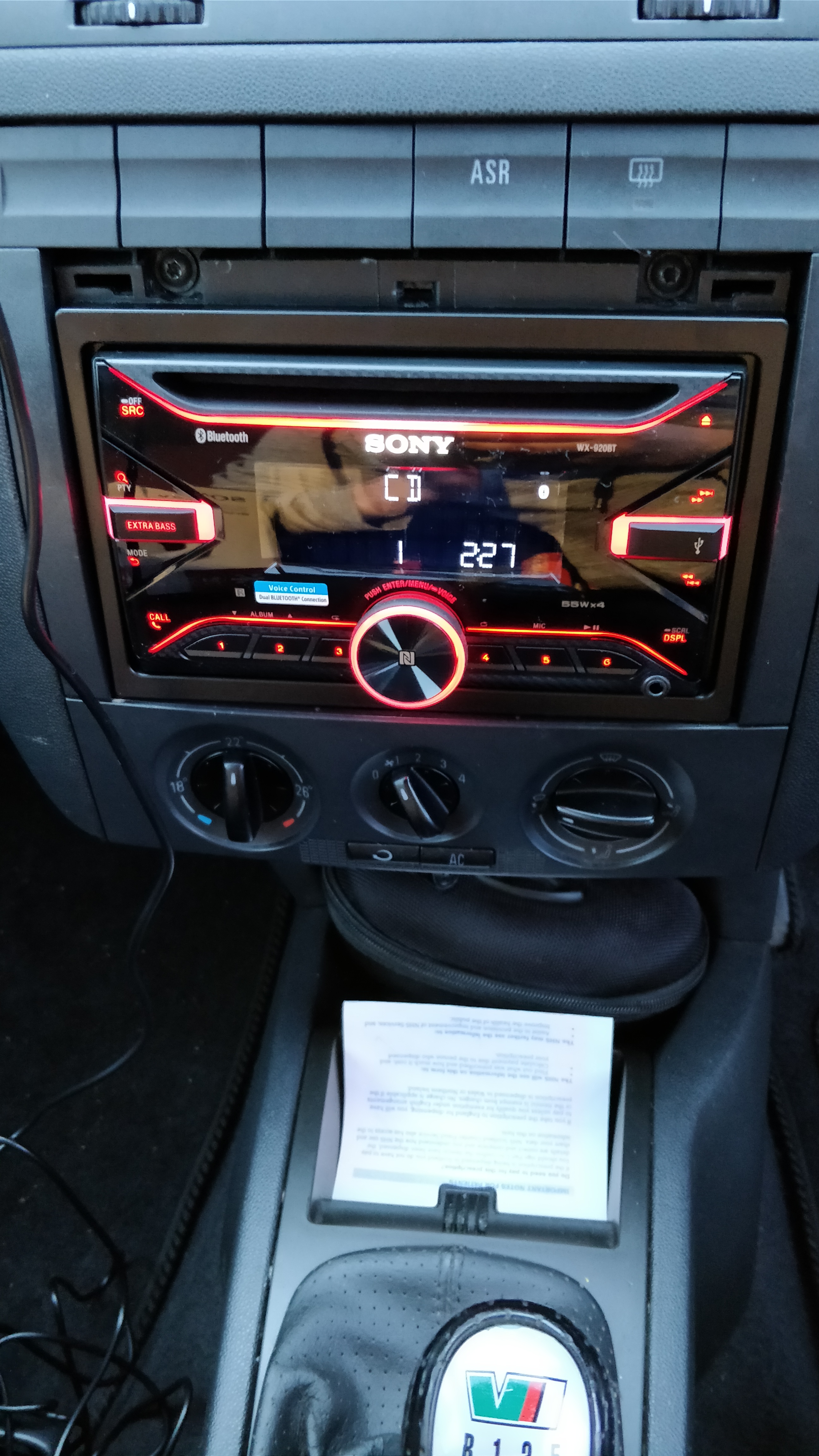

Well earlier this evening I grabbed the bull by the horns and reserved the Sony stereo same as you. About an hour ago I decided to try and install.
You weren't lying when you said its easy/straightforward. Easiest stereo I've ever done. Highly recommend this stereo, it awesome with a lot of techie stuff.
Also ordered the little trim piece to fit that gap.
