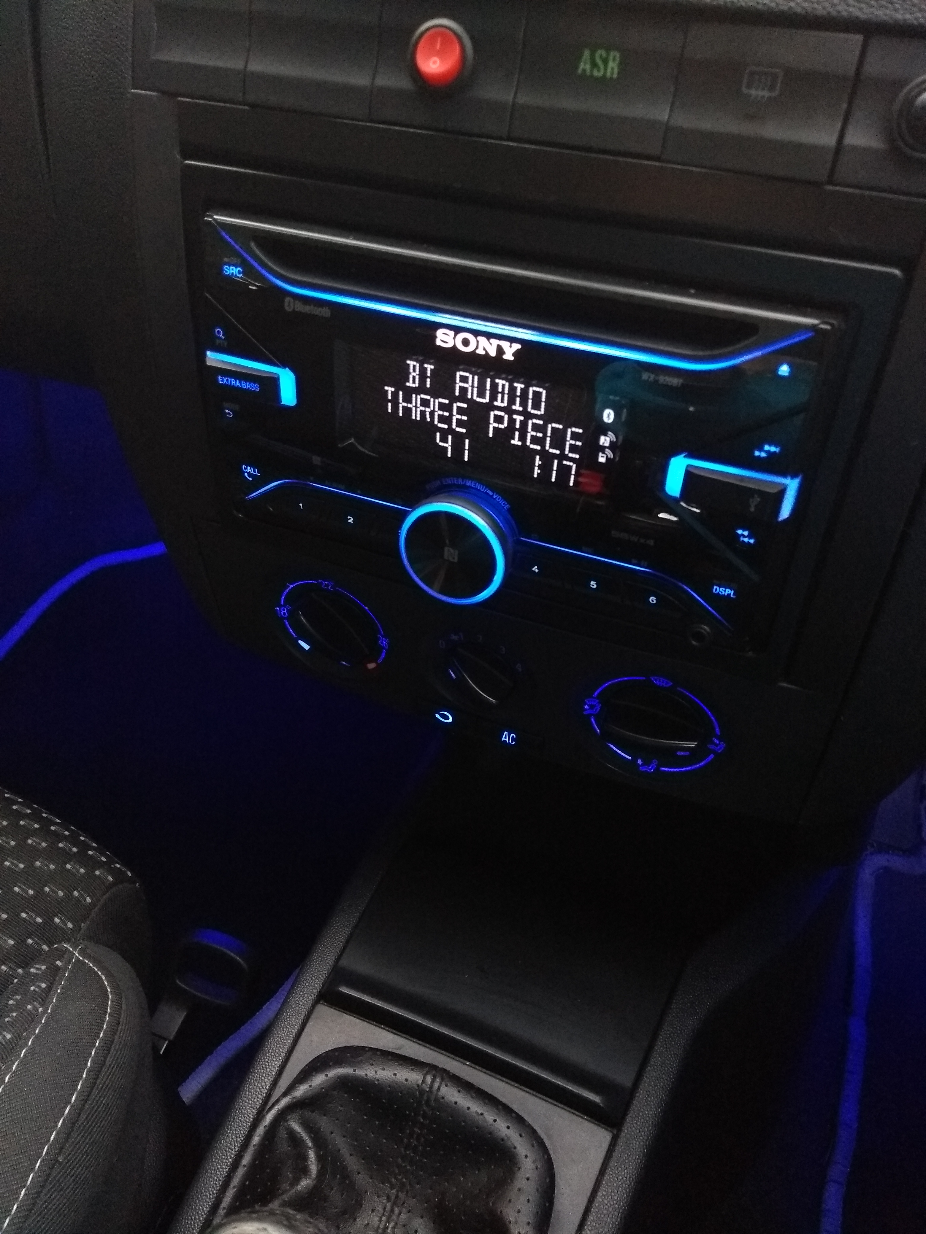

Try swapping over the red and yellow wires to Keep the settings.
Not sure about the crackling part?

Cool I'll give that a shot tomorrow.
It's almost like the signal isn't strong enough or needs some kind of boost. Weird but will settle for the settings being saved. Cheers

Yeah not keep the settings would be a pain. My radio signal is fine so maybe an issue with your aerial?

I did wonder if I needed something like that. Getting it to keep settings is number 1 on the list then tackle the station crackling.
Gonna try the red/yellow swap shortly
I had loads of radio intereference when I swapped over to the VW set up. For me it turned out to be a break in the lead (centre wire) just where the connector plug started on the end of the lead. So just double check that as well, its only a really thin / fine wire and if you bend it too much it can break.

Hey bud, you're a hero! Swapped the wires over and bang it works and holds the settings! Happy days.
As for the aerial, the thin wire looks like it's ok but I'll leave it be until it annoys me. Not a big fan of radio anyway lol

The car is like a disco on wheels with the light dancing to the songs lol
