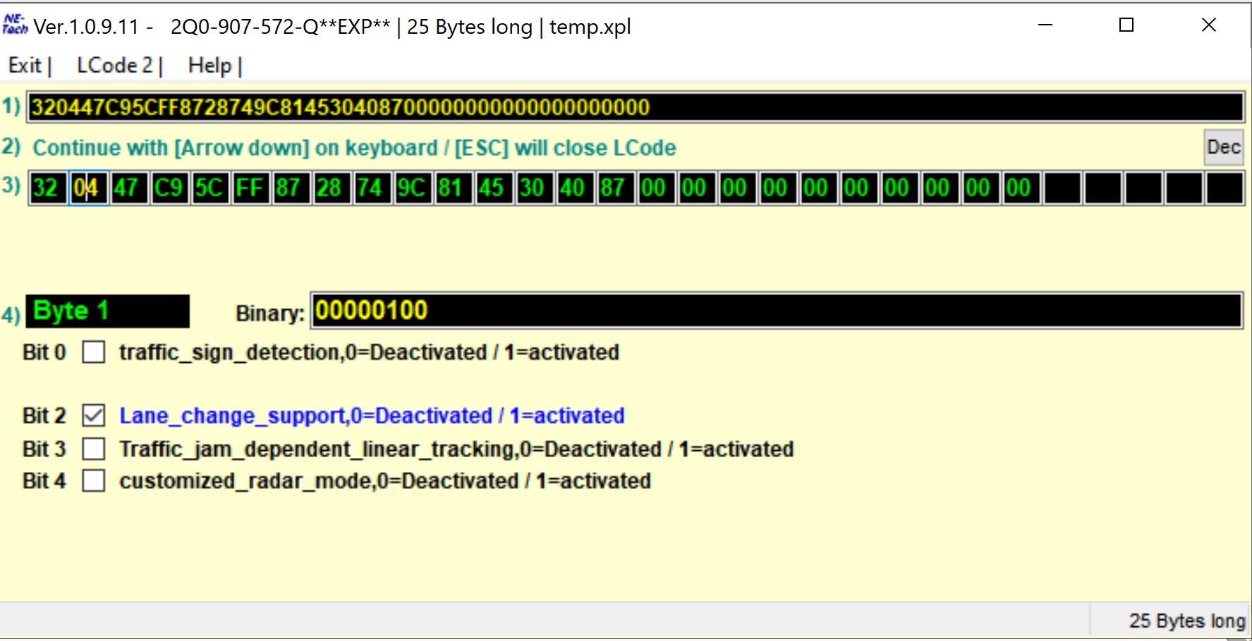

In control module 13 (Adaptive Cruise Control) what are your settings in long coding:
Is Byte 01, Bit 0 (Traffic Sign Detection) activated or not ?
I have found no information on this elsewhere.

Hi @linni thank you so much, for your quick reply. It’s also off on mine. I wonder what it does, as traffic sign assist works fine without it ticked.
I some times I get an ACC error, and it stops working. This error goes away after ignition shutdown, and 30 seconds wait before turning back on. Thought that this might be the reason, and needed to be activated, but I guess not.
Byte 03, 04 and 24 differs from mine, would you be so kind, to screenshot these also. That would be so helpfull. I think it is because you have park assist and maybe also a trailerhook
My default HEX is:
32 04 67 51 5C FF 87 28 74 9C 81 45 30 40 87 00 00 00 00 00 00 00 00 00 04

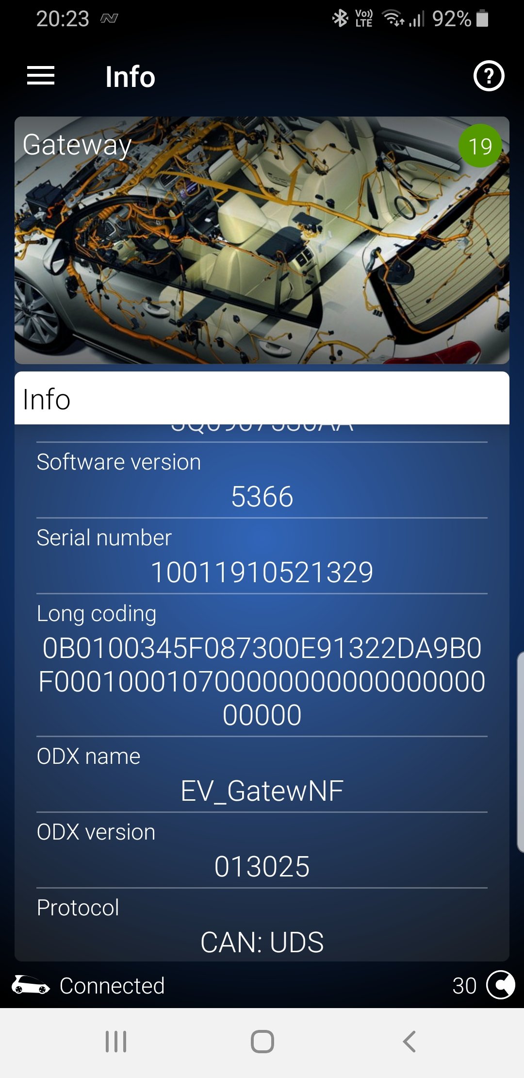

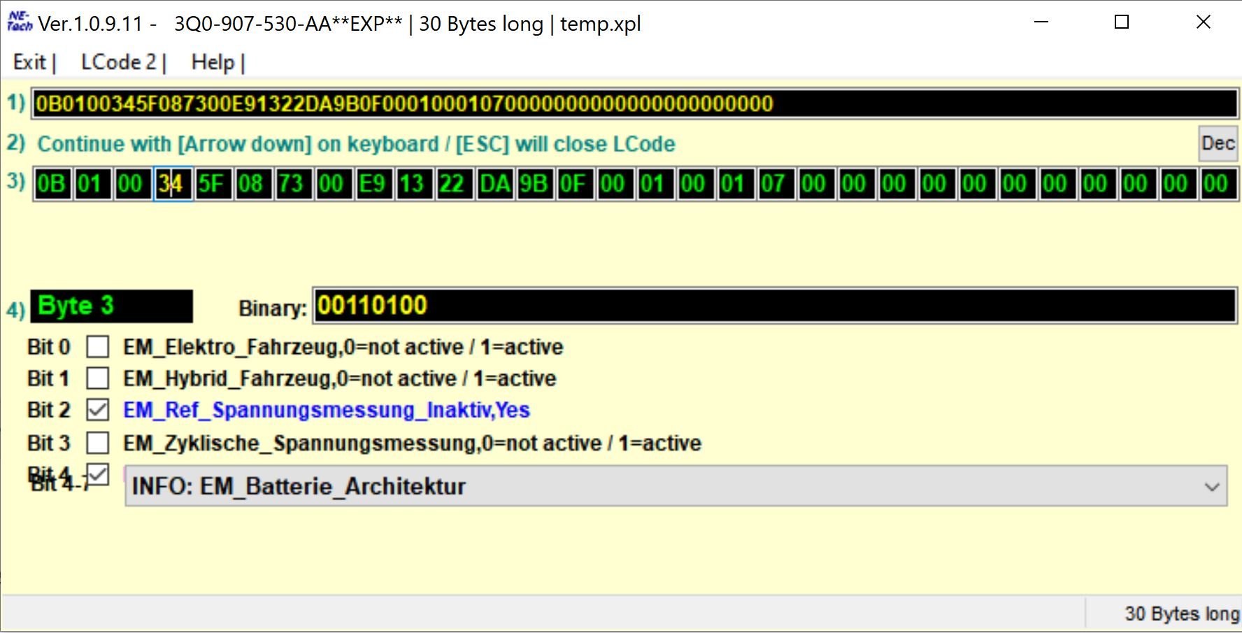

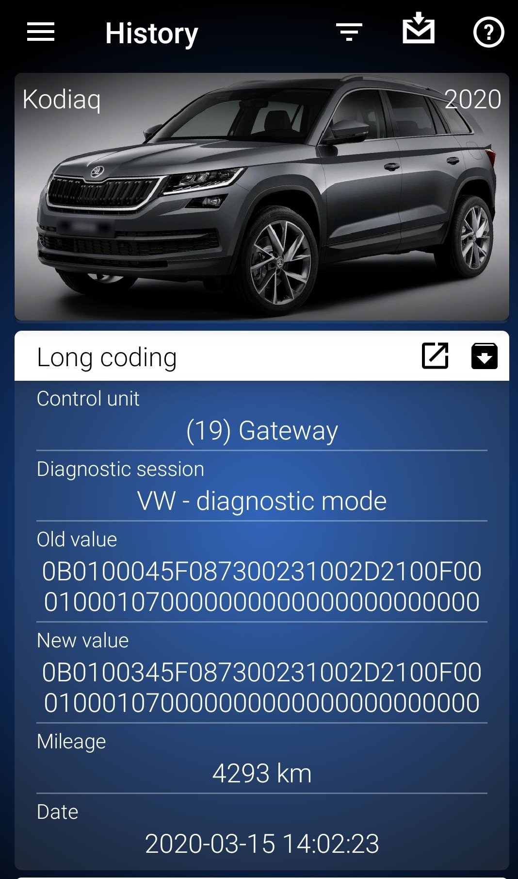

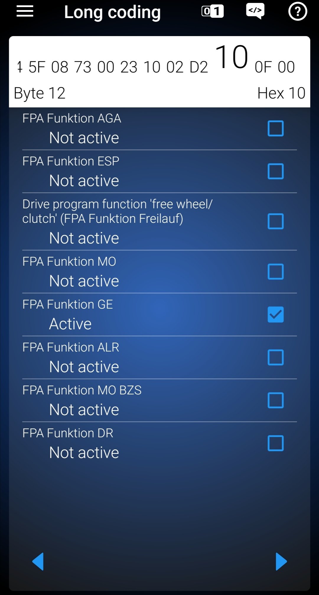

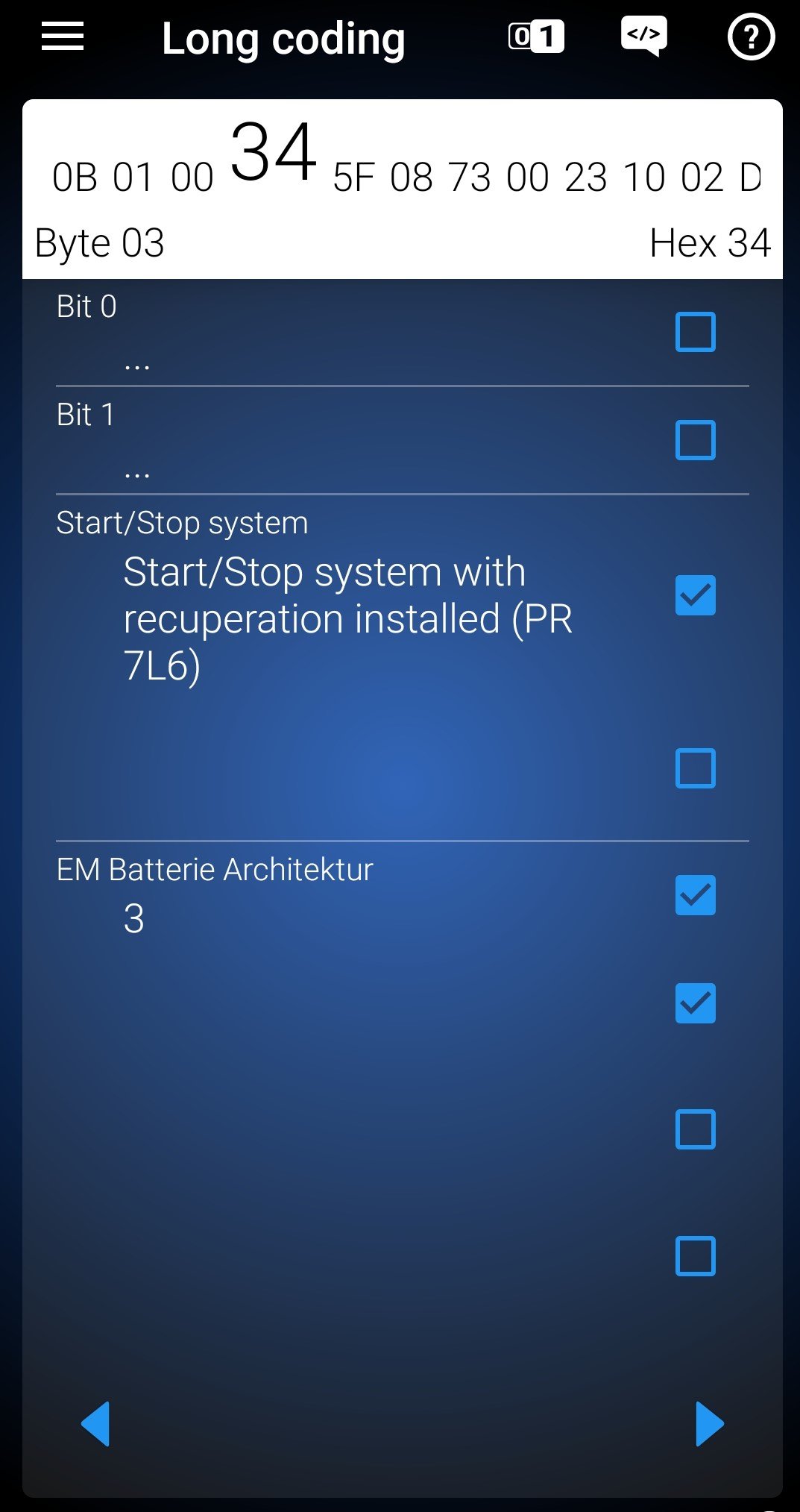

My obdeleven keeps a history log of the changes I’ve made. And I went to look, to verify, and something strange came up. I have never been in this control unit, so I know it is not me. The obd history log says that in Unit 19 (gateway) it has activated Byte 03, Bit 4 and Bit 5. I have no idea what they are, besides to be something regarding battery, I think.
Think you’re getting a bit tired of me asking, but would you tell me, what your defaults are in unit 19, Byte 03, Bit 4 and 5 ?

Strange thing is, that Byte 3 does not have bit 5.
Orinary version (blue background) of coding gives only two bits under byte 3.
This yellow experimental is more complex.

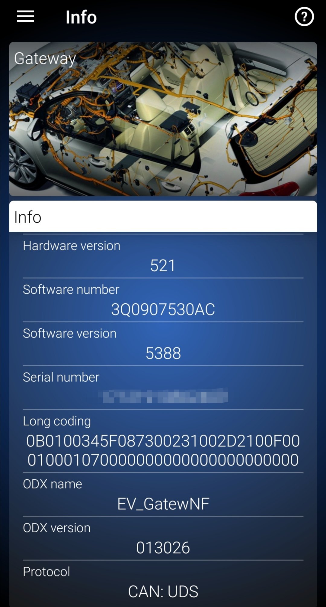

@linni Thank you so much for taking your time to help me.

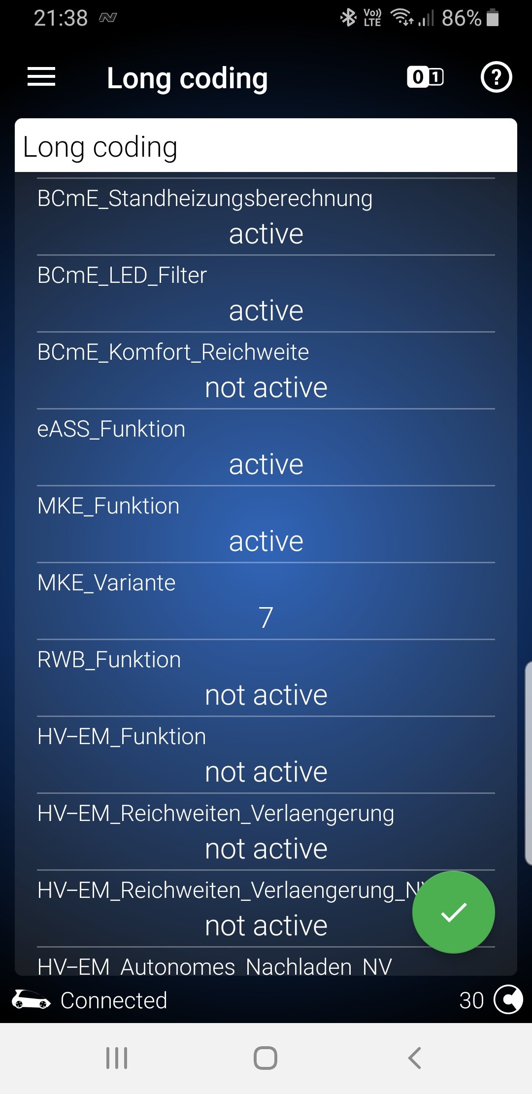

Firstly, let me assure you, that I never use obdeleven's apps. Only manual adaptations and long coding, which then should be more or less the same, following the same guides from VCDS.

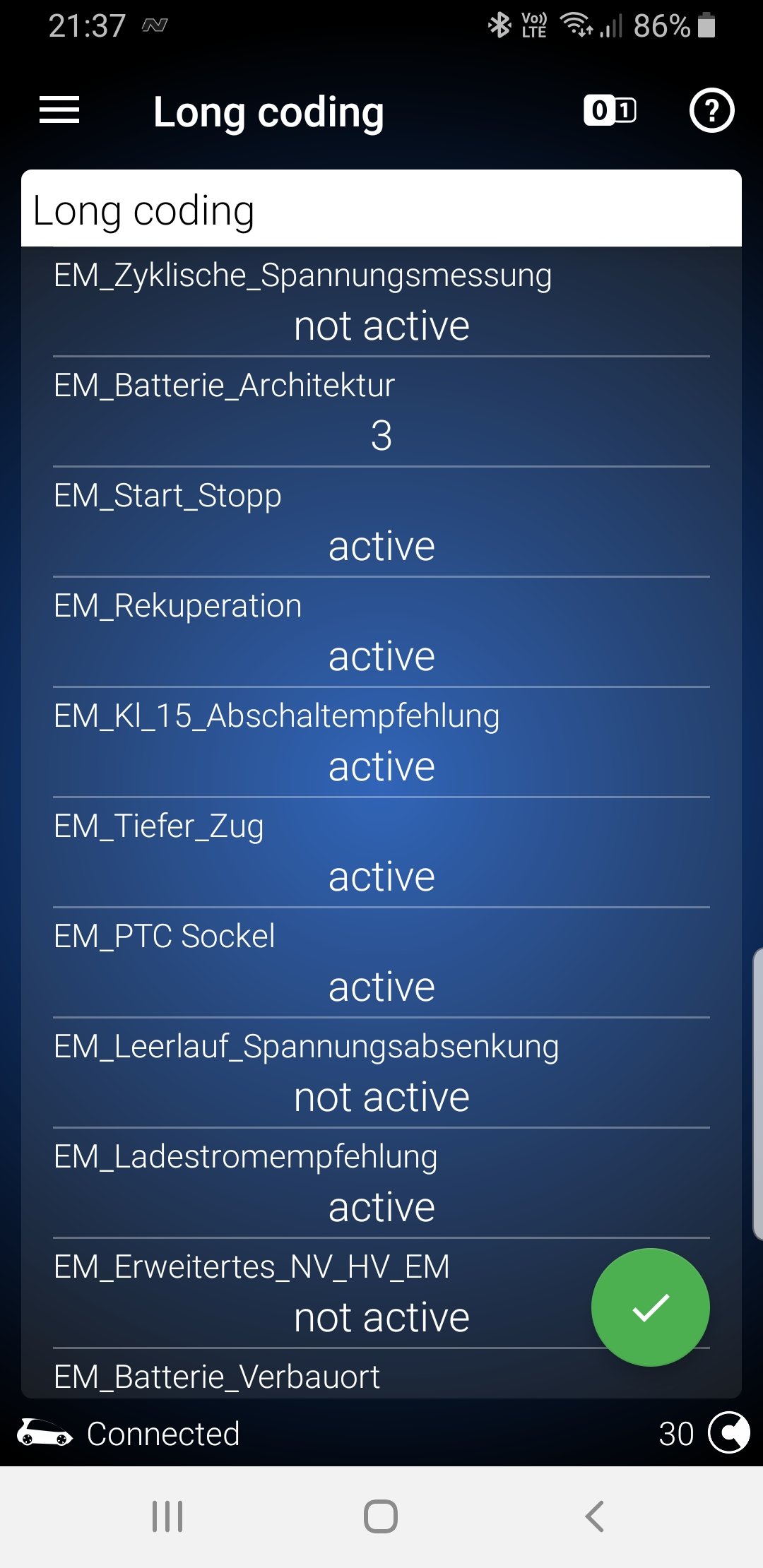

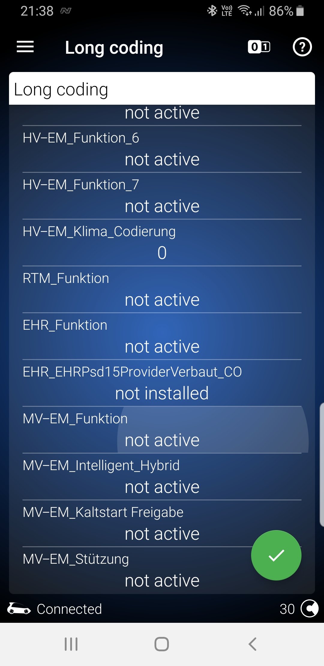

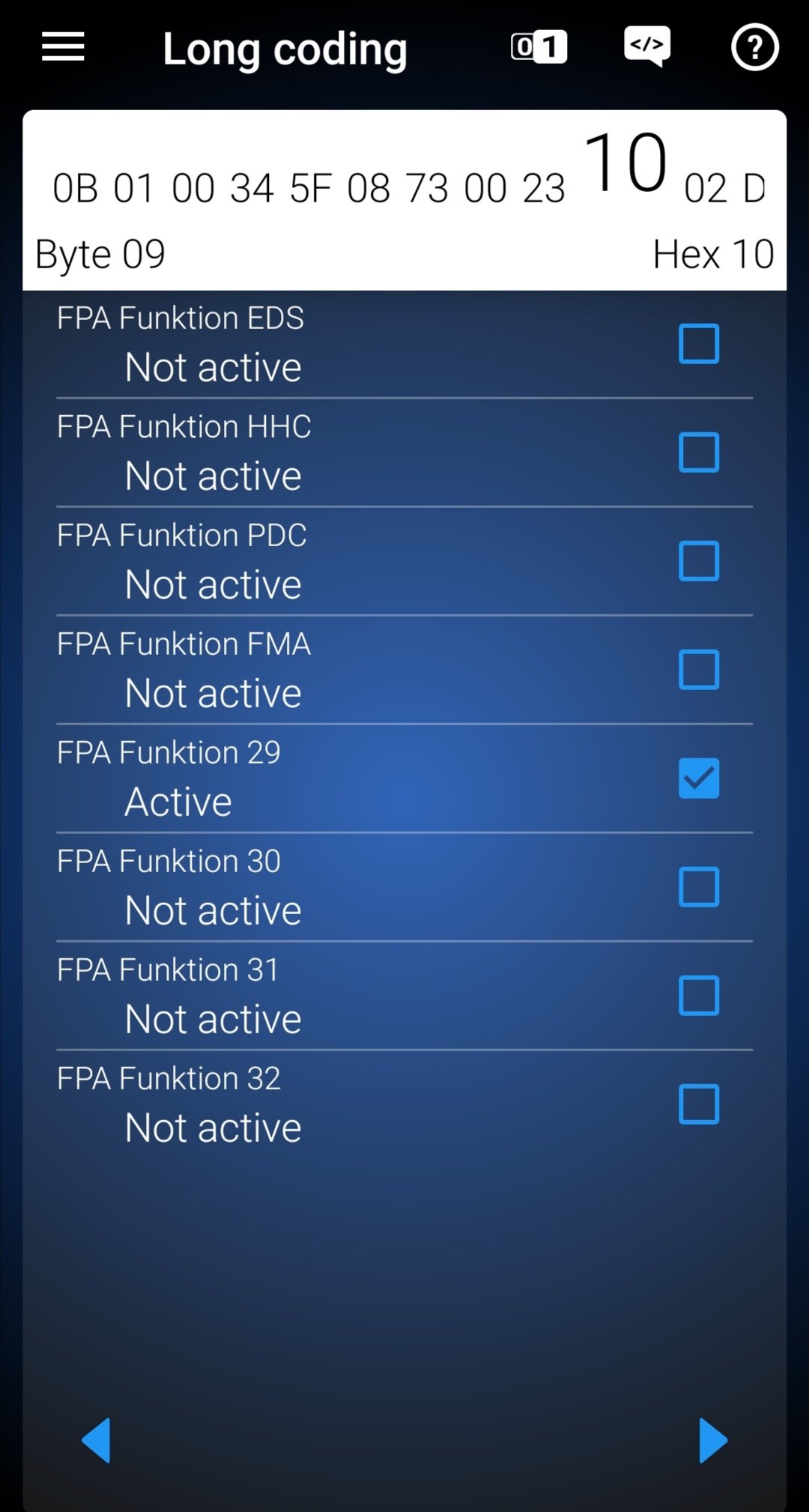

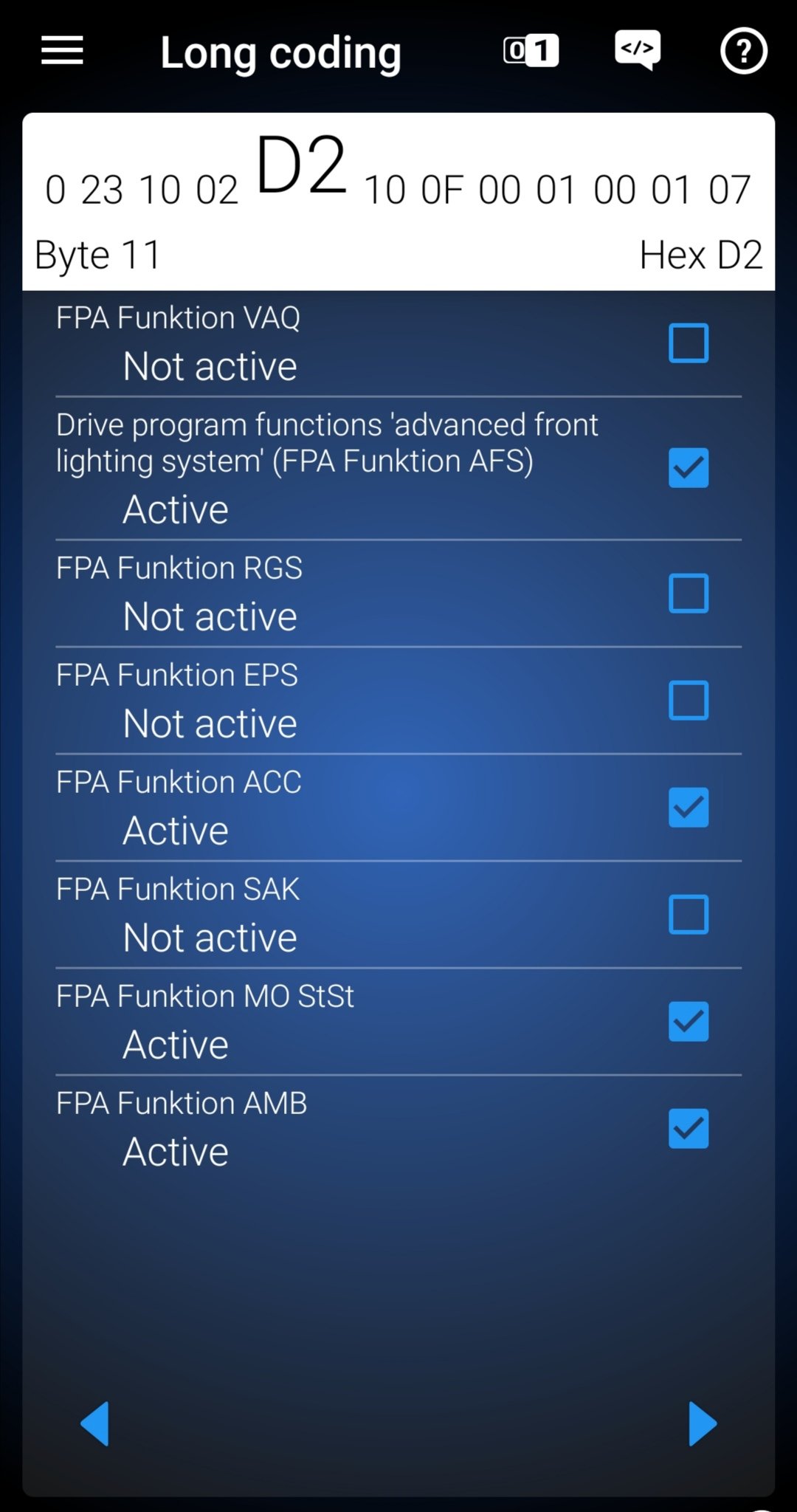

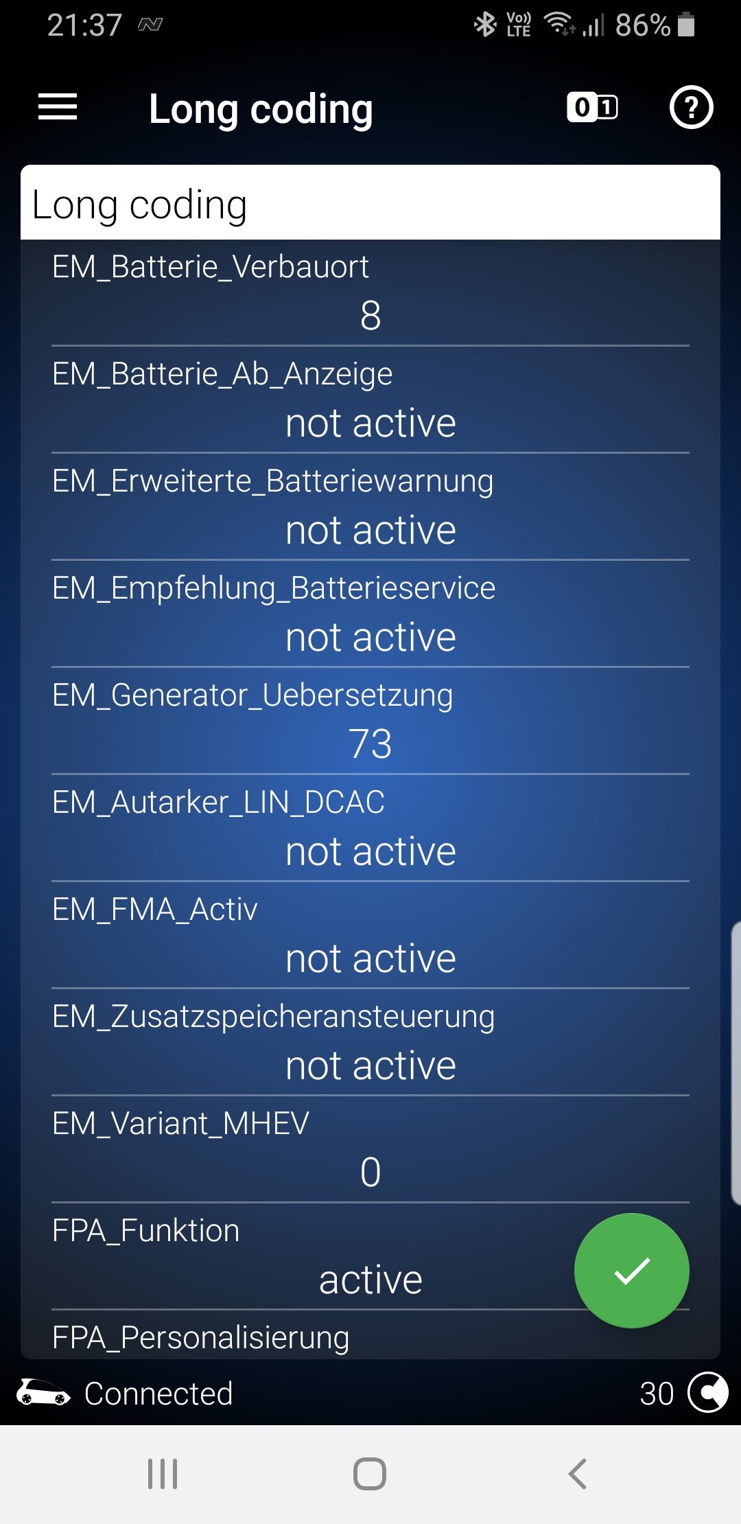

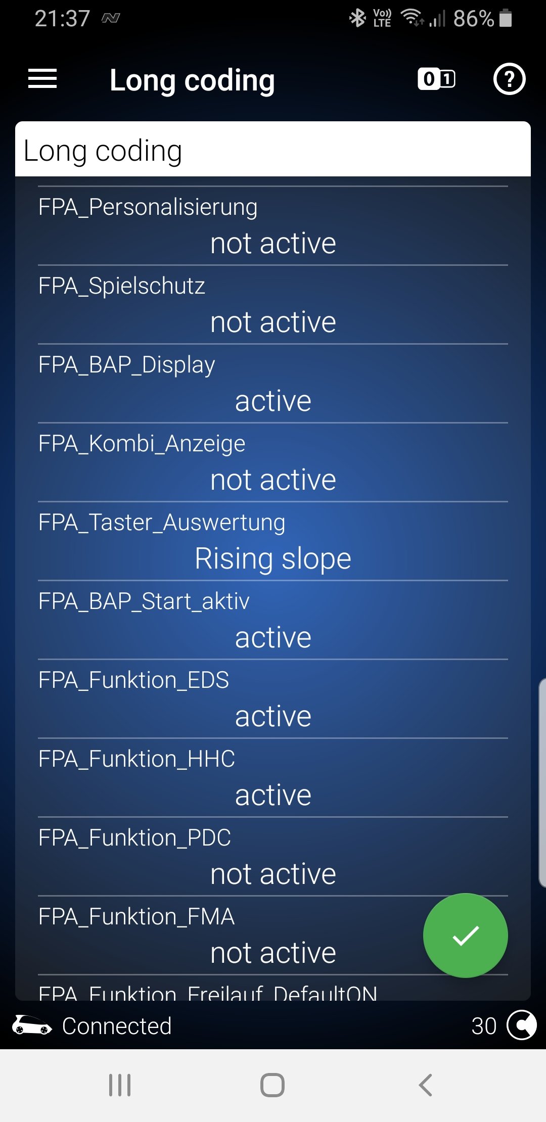

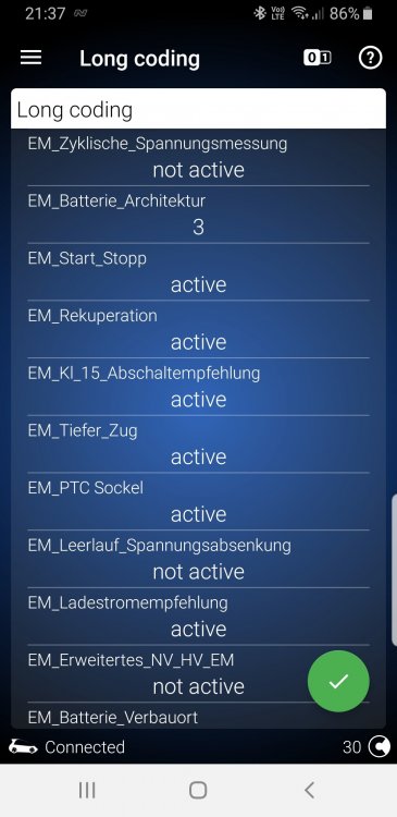

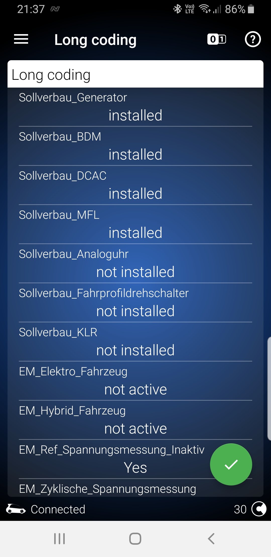

But now it gets a bit more weird. Cause as our image shows, your current settings (hex value is 0B010034), is exactly the same as mine, but what obdeleven history says, it has changed it to. I know I have never changed anything in unit 19. And your EM Battery Architecture seems to be 3 (in regards to your hex value). So maybe mine has also always been 3, but for some reason obdeleven chose to make a wrong history log. - OR obdeleven is correct, and my EM Battery Architecture was actually 0, and now 3. I'll think I'll leave at 3, seeing your setting is that, and also, I have no idea what EM Battery Architecture is ;o)
Please see my obdeleven images for reference.
@snowatom
Checked the history, I have a list 2 kilometers long there. Added, removed, again added, again removed (ACC for example) etc etc. Complete rubbish. Granny, give me some bullets.
Checked for faults - found some in couple of modules. At the same time VCDS found zero faults.
I think we can (or must) stick this obd11 as deep as we can.
P.S. I have the same EM Battery Architecture nr 3.
Just in case my long coding. There are some differences but I guess it?s due to older version of the hardware/software.
Edited by linni

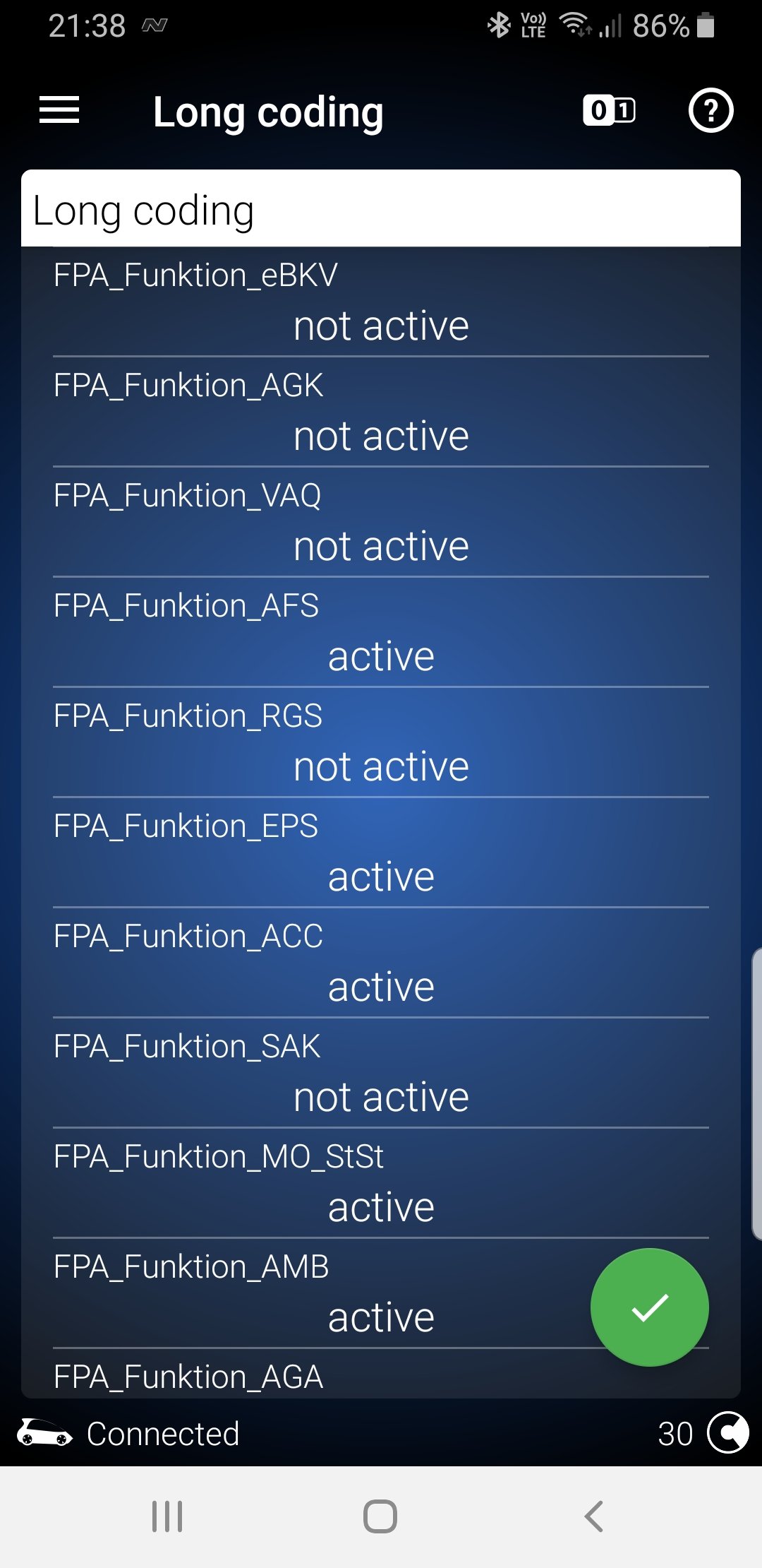

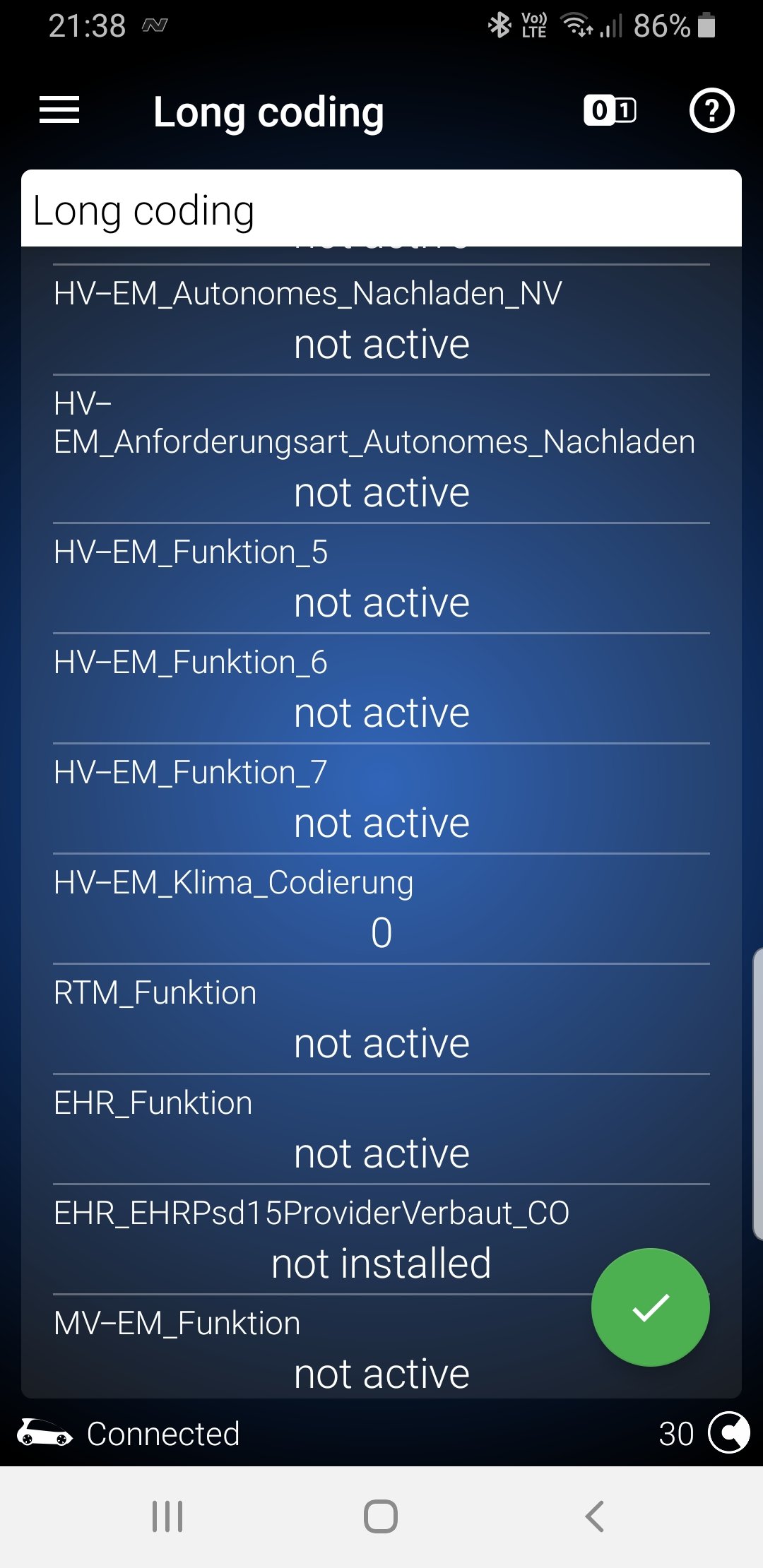

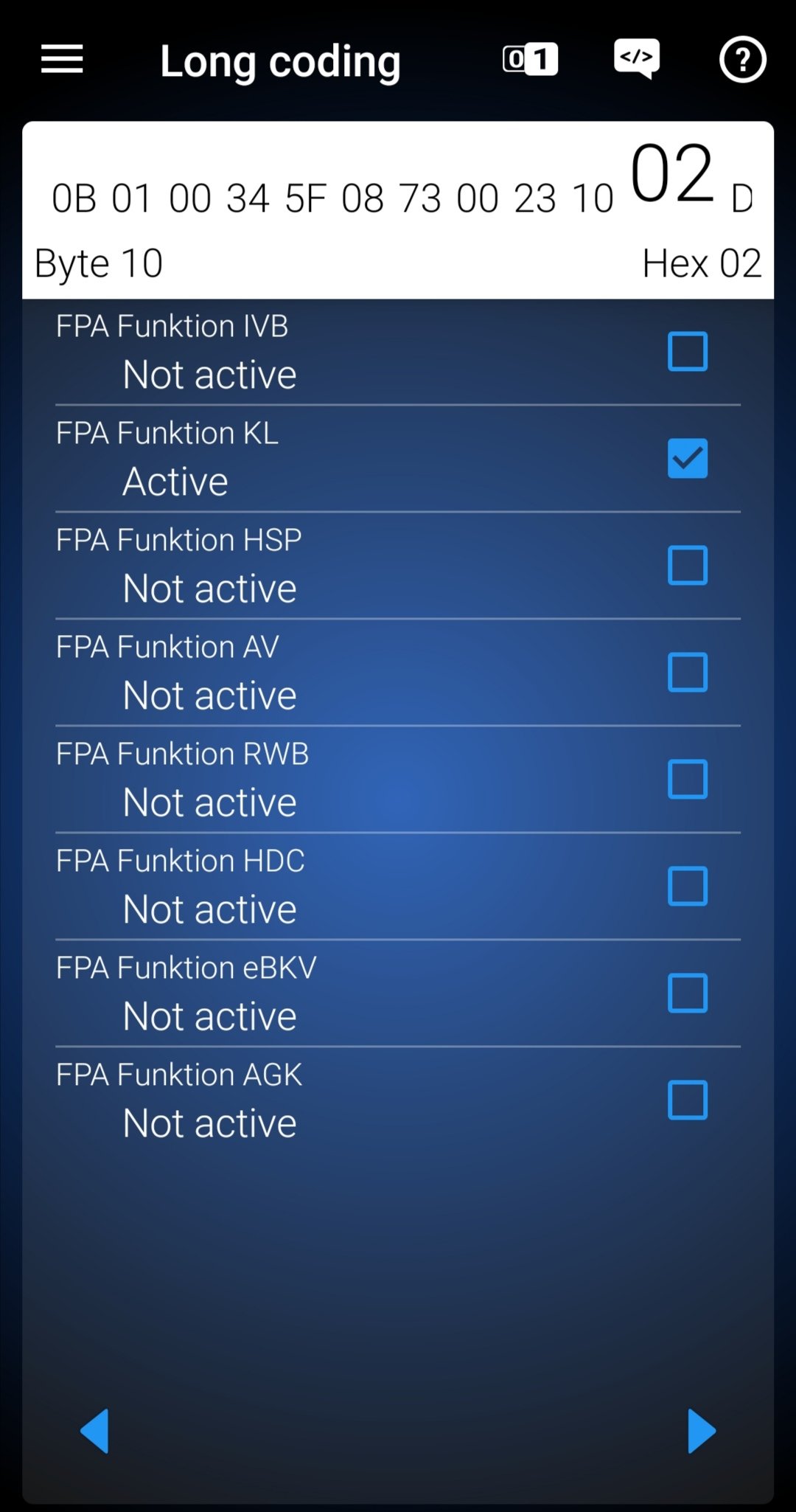

Your version of OBD11 seems slightly different, but here it comes:

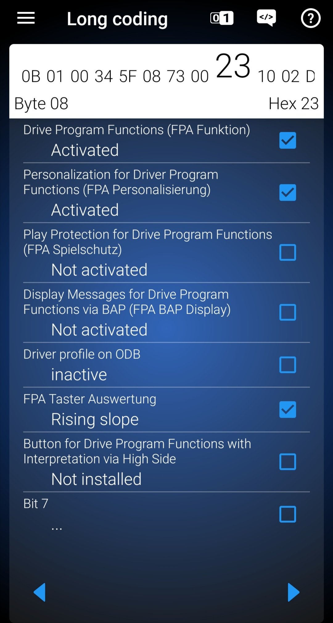

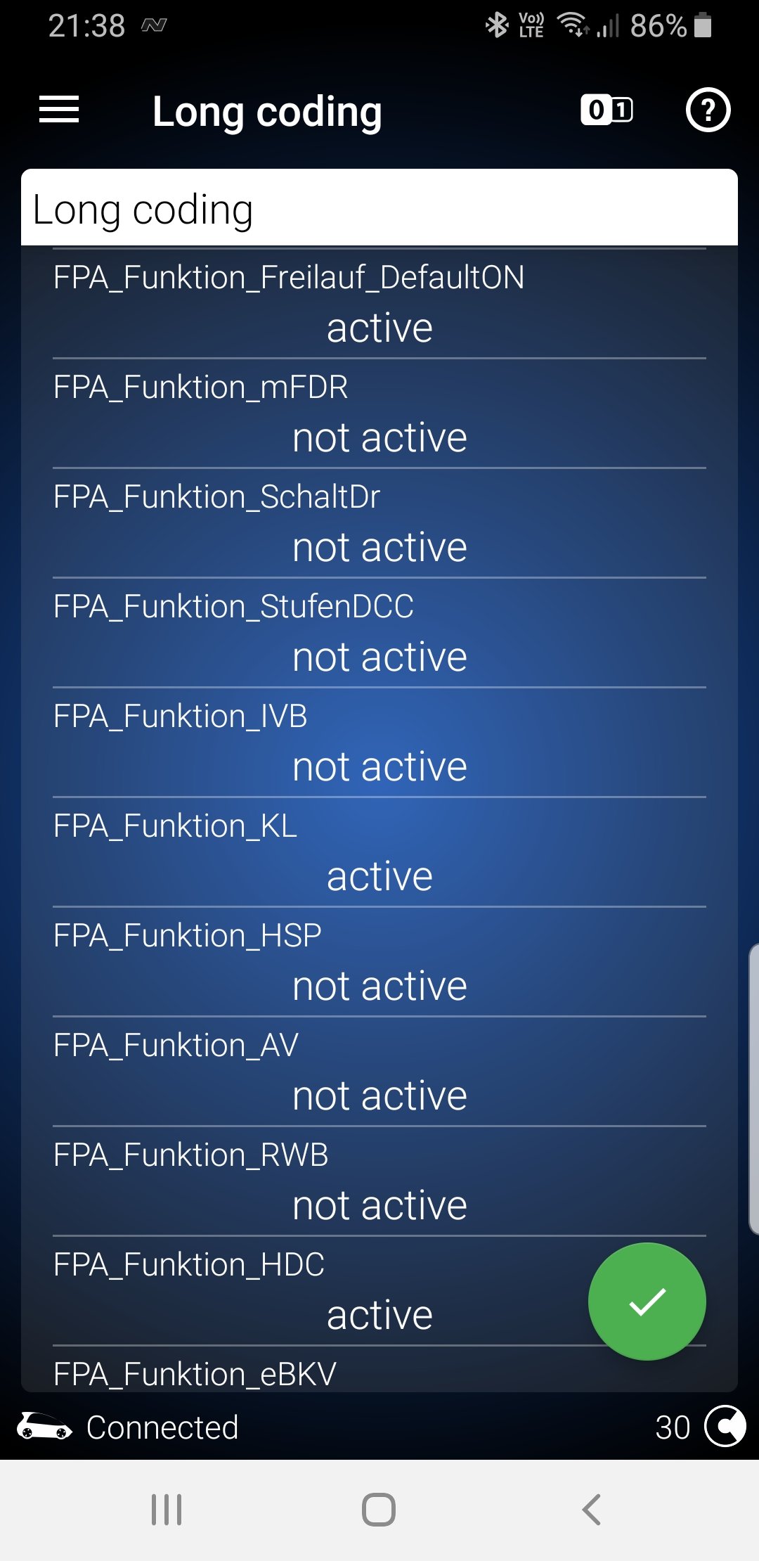

703405990_2020-03-1521_37_42.thumb.jpg.639860447d7f95a561c530b55541d7cb.jpg1832664540_2020-03-1521_37_51.thumb.jpg.bfebb4c04b28dd083c483c994f35fcc1.jpg1562995728_2020-03-1521_37_58.thumb.jpg.d27cbb67a2fb69530019f20b4bb95df8.jpg
439275906_2020-03-1521_38_05.thumb.jpg.6d10885148ccebc92fa1f340cba17139.jpg214072445_2020-03-1521_38_13.thumb.jpg.0cf4dd5ad199494dd9736cb48af9f475.jpg493893071_2020-03-1521_38_20.thumb.jpg.347ed19a1c21292f3fd5e2c6df5d66c0.jpg
730736672_2020-03-1521_38_28.thumb.jpg.2824309681ef6bdb3600588ae9910ccc.jpg1382015563_2020-03-1521_38_40.thumb.jpg.656d502a786d1ef4cb87da5b156bc953.jpg1132087414_2020-03-1521_38_44.thumb.jpg.197f08c84b58d8143d118c27f30cb237.jpg
