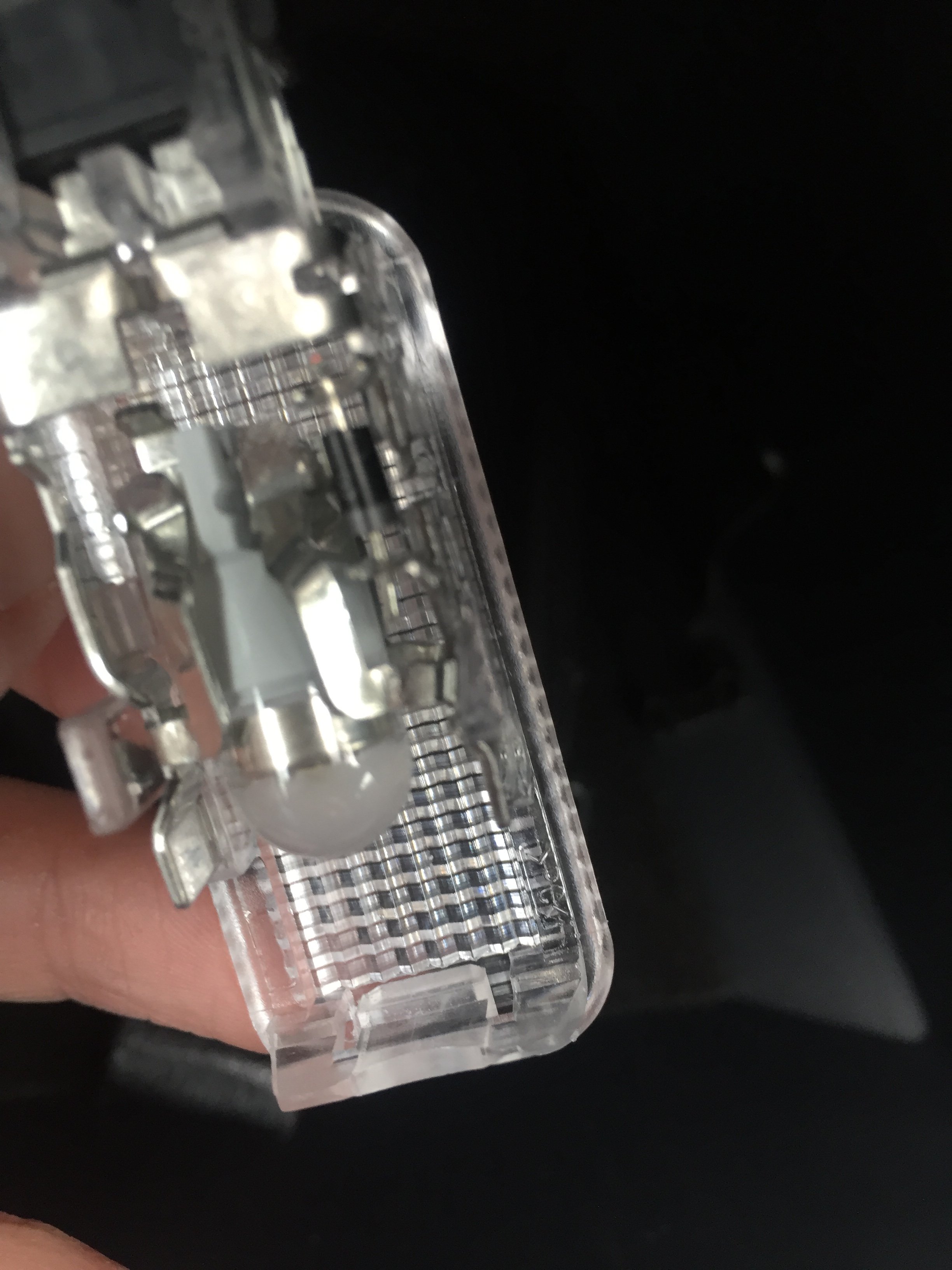

Hi all. Pretty sure I managed to blow the tiny fuse (?) that’s in the glovebox light. Does anyone know what they’re called and if somewhere like Halfords would sell them?
symptoms: tiny puff of smoke and now bulb isnt working.
Little black and grey thing on the right of the attached:
Edited by uchuff
That's a resistor I think...
Will need soldered replacement :sadsmile:

That's a diode. There might be a number on it to help find a replacement.
+1
That's a diode, probably 1N4007, you can buy it cheap.
Looks like your LED bulb is shorting out the contacts? I can see a metal ring on it.

Thanks, will have another look and see if there are any other markings. Only one I saw was a big “3”.
Unplug the lead from the housing, get a normal bulb & plug it in, then re-plug the lead back to the housing & see if that works?
It does a bit but the silver ring is behind the lense. Not easy to see from the potato pic.
So it turns out I’m a ****** idiot. I’d actually managed to put the bulb in the wrong way round. Removal, 90 degree rotation and reinsertion was all it took to get output. In my defense I was rushing to get it all done before we went out for lunch.
