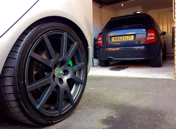

I can just about put my fingers between the wheel and wing and I’m good on most speed bumps. There’s always somewhere you’re gonna catch your splitter, so drive and park accordingly.
