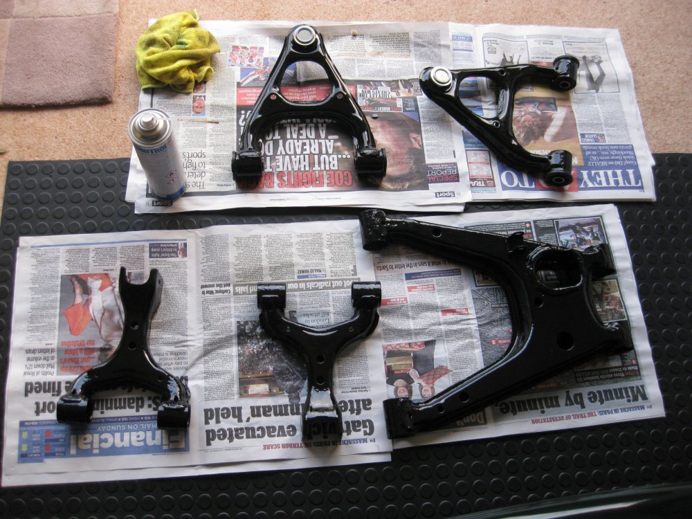

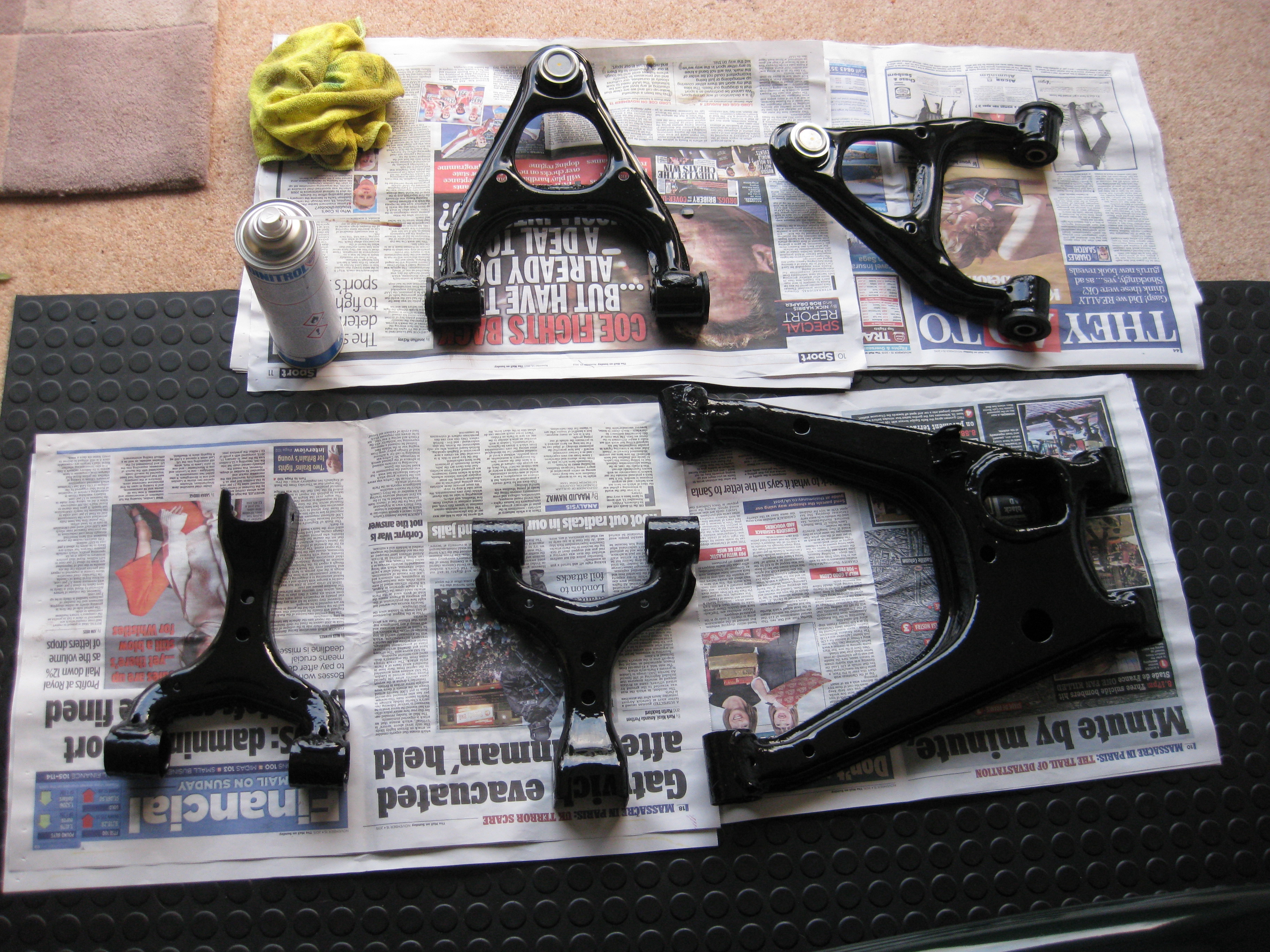

I did actually lightly sand off and then apply some POR15 metal Prep which further enhances the future protection once the actual POR15 paint has been applied.  Marvellous stuff - I also used it (albeit the black version) during a refurb. on my old Mk1 MX5 suspension arms .....   application by brush really is quite straightforward with a steady hand and appropriate brushes e.g. short handles !!

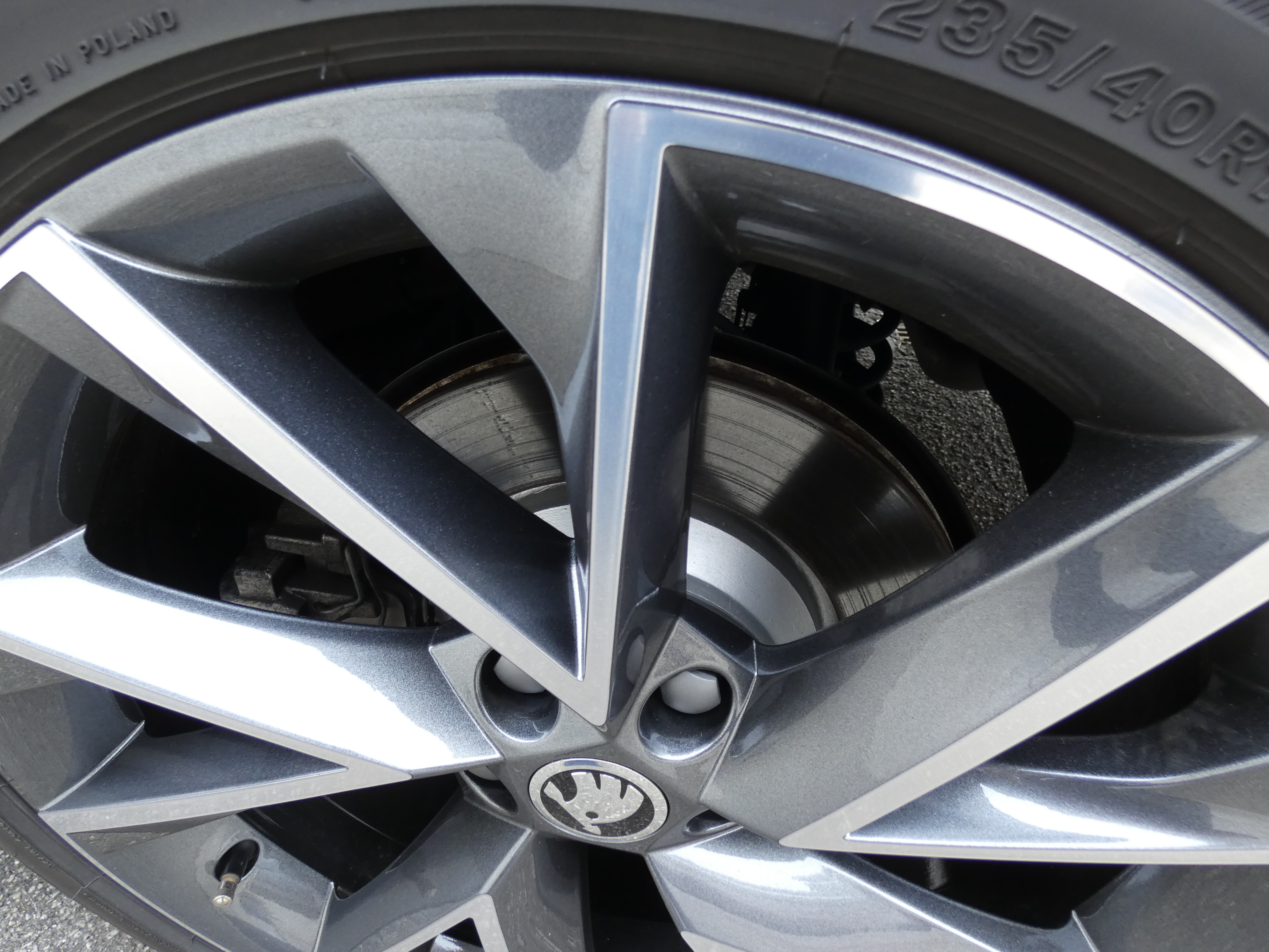

2 hours ago, skidpan said:
Like I said, its only they shiny bits that matter and they clean up the moment you brake. Look at any brand of car, they all have rust on un protected brake components.
That's not always 100% true. There are many  cases reported where pads are reshaped via rust. See one example (the brake surface is diminished):
Related image
This did happen often on older cars or cars that were not used for some time. But truth is also that this probably wouldn't be solved by paint ^^.
My girlfriend had exact same issue on VW Jetta 2014. It diminished the brake pads so much that u could actually fell difference in performance.
