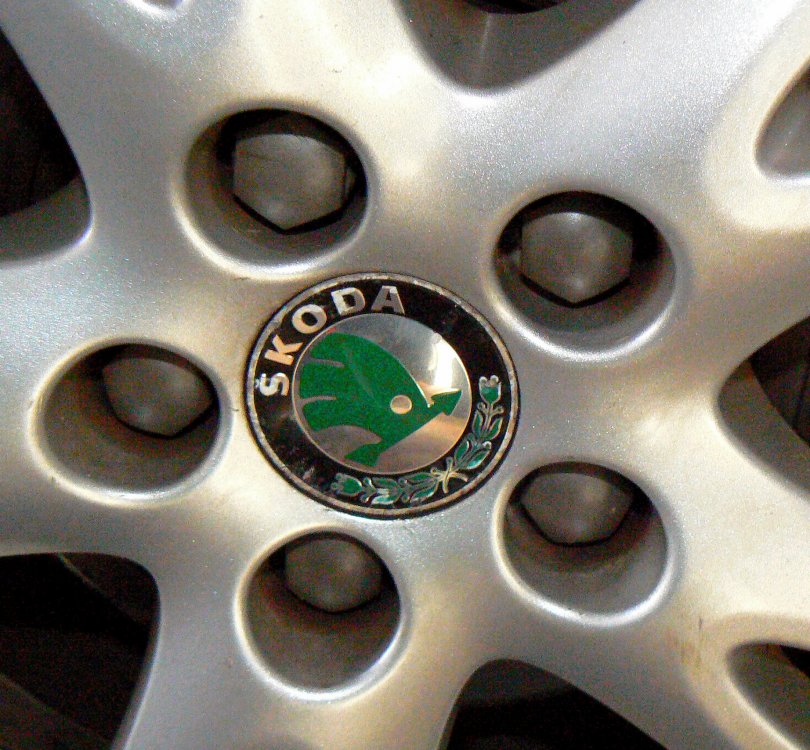

  • No No No, don't go tapping, they all have plastic covers, and my money is on the bolt adjacent to the OD of SKODA in your picture, is the security bolt!   My amazingly clever plan would be t
  • Castrol R - was that not a veggy oil, that was quite a pleasant smell, even more pleasant when smelt at race tracks when it was truly lovely and hot!

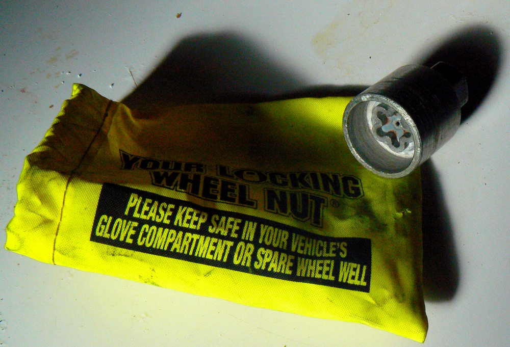

  • Yep they're just caps   You should have what looks like a black tweezer type of tool in the boot, it slips over the plastic cap, give it a little tug and it'll pop off. If you don't have one

I think the "pattern" on the top of the bolt, or the corresponding pattern on the adaptor key gets distorted/damaged/broken - the threaded section of the bolt will survive, but you or the next unfortunate person dealing with that security bolt and/or maybe all the other security bolts on that car will now be faced with a problem getting these bolts out.
Edited by rum4mo
It’s the other way round in that the key gets distorted. You can buy new keys but they cost about the same as a new set of bolts and key.
I’ve just had to go through the same situation and had the locking wheel nuts removed by a professional at £10 + VAT a wheel. Then had to buy replacement locking wheel nuts.
