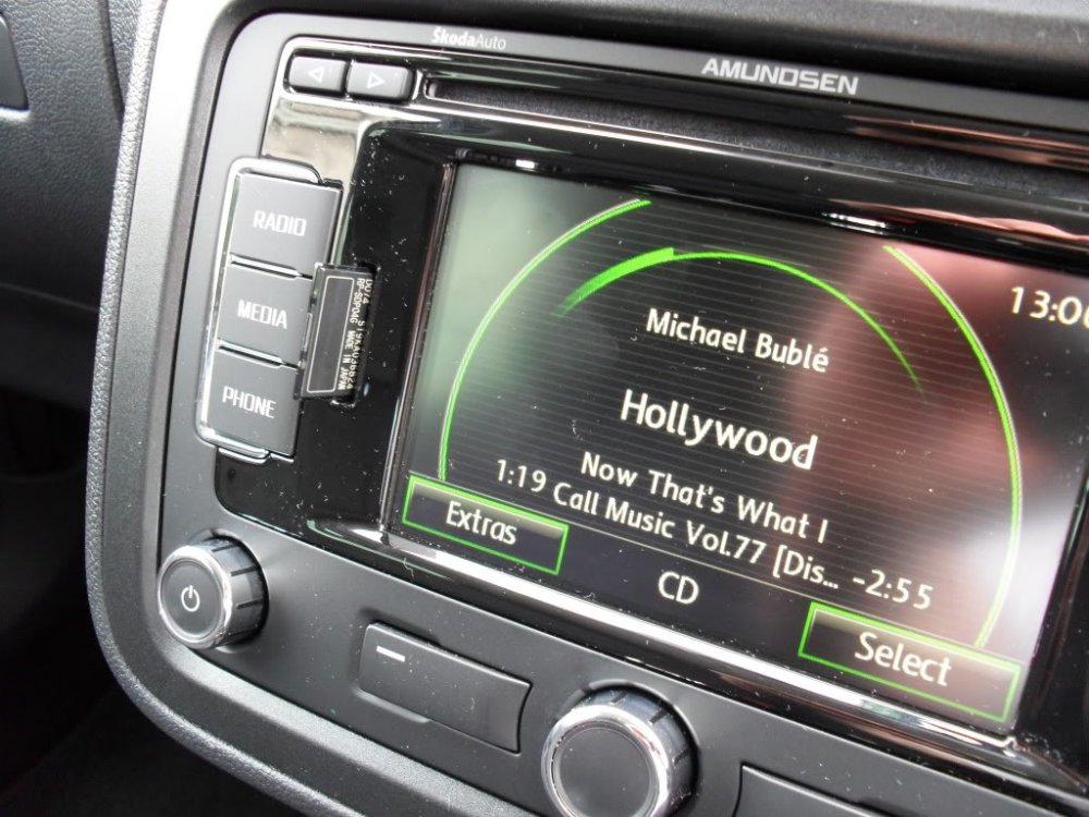

Need some advice here. Went to drive the Black Edition Fabia yesterday, beautiful little car but there are two items I need advice on please.
The Amundsen system has no sd card in the slot which I believe is required to update/operate the sat nav.
My system is this  shown and I believe its called the Amundsen+   which I think is classified as  (RNS315).
Can I purchase this SD card and be guaranteed it'll work?
2018 VW SKODA SEAT RNS 315 AMUNDSEN V9 SD CARD AZ WEST EUROPE NAVIGATION
Thank you in advance, any info would be appreciated.
Your unit is an Amundsen, not an Amundsen +. They look the same but are very different, the Amundsen is based on the RNS310 and the Amundsen + is based on the RNS315.
Maps for your unit as you say will need to be in the unit for it to work, but the maps are specific to the Amundsen, and the Amundsen + maps won't work.

Thanks for that Rusty. This has given me a solid headache since I first saw the car. How can you tell which is the Amundsen or the Amundsen+.
Amundsen + has  "Amundsen + " printed on the front fascia where yours only has "Amundsen". Also, the Amundsen + unit stores the maps on the internal memory so sat nav will work without the sd card in it. Did you try the sat nav?

Just to clarify, the pic you posted is the actual system in the car which you took a picture of?
Hi Rusty, no, that is not the actual unit in my car, I copied that from the net assuming it'll be the same. Never thought about a CD.
Ah. In that case you might well have an Amundsen + unit and the maps will be saved internally.

If it is a Amundsen + (RNS 315) then the maps are stored on the unit. However they may be out of date and you would still need an SD card if you wanted to update them. To be sure, when you get the car, Press and hold setup for 10 seconds, select versions. Amundsen (RNS 310)  will have 3 data lines "part number" "software versions" "system hardware version". The Amundsen + (RNS 315) it will have an extra 2 data lines "Navigation data: part number" and "Navigation data: version". Option 5 "Navigation data: version will tell you how up to date the maps are. I think the newest is V9 or 10. There was some issue with V10, but I don't know if it was rectified.
