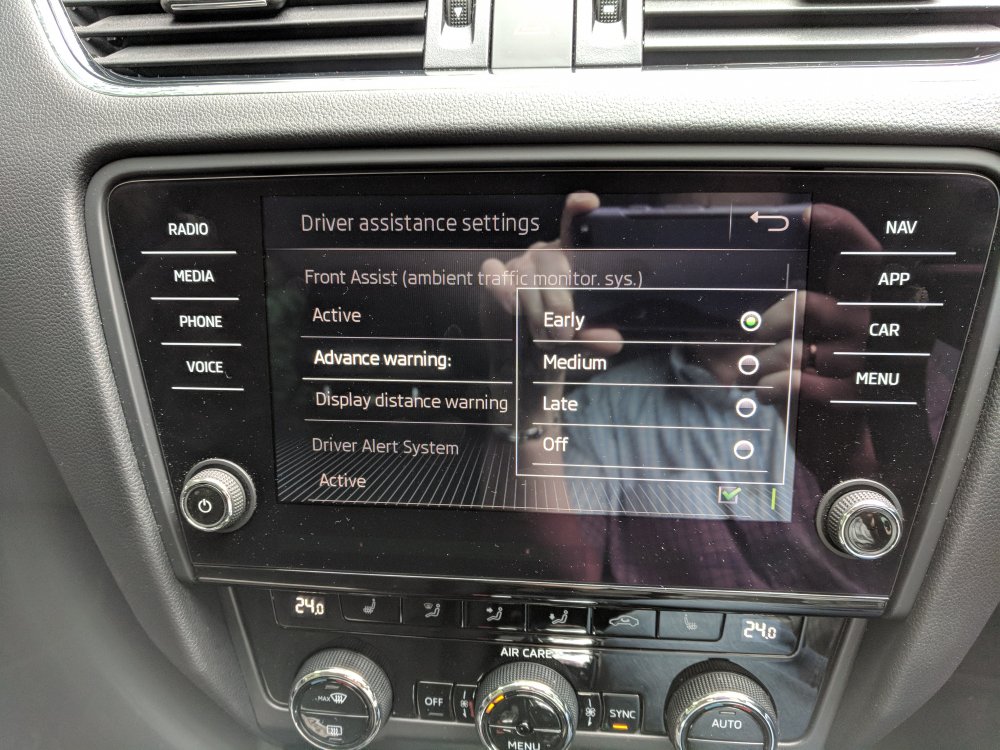

It’s programmable in the infotainment menu, you can set it to early/medium/late if you haven’t already.
must be related to the cars firmware versions , as mine does not have any settings in infotainment .
Don’t know, my car doesn’t have it but the courtesy car I had from Skoda when mine was being serviced did have it and I toggled it to early activation to see if it did anything. It did :o

My 67 FL Octavia has adaptive cruise control, this can be set at early, medium and late. I'm not sure if this is what you set Sasha? Unless this is going to be another feature I'm about to discover :D
FL SE L with Front Assist but not Active Cruise Control and I don't remember seeing that setting, pretty sure it was just an on/off checkbox.
No the car didn’t have the ACC, was deffo for the front assist. I don’t have it on my car so I can’t post pics of the infotainment system to show where I found it.
I'm tempted to nip out now and take a look, see if I can find it?

Yes Sasha, your right. The option is there for the front assist distance setting as well as on mine, for the adaptive cruise control :thumbup:

It's come back to me now I remember seeing the "Display distance warning" in your photo - a nice feature as I've always said the missus tailgates so it was nice to have the car back me up on that.
