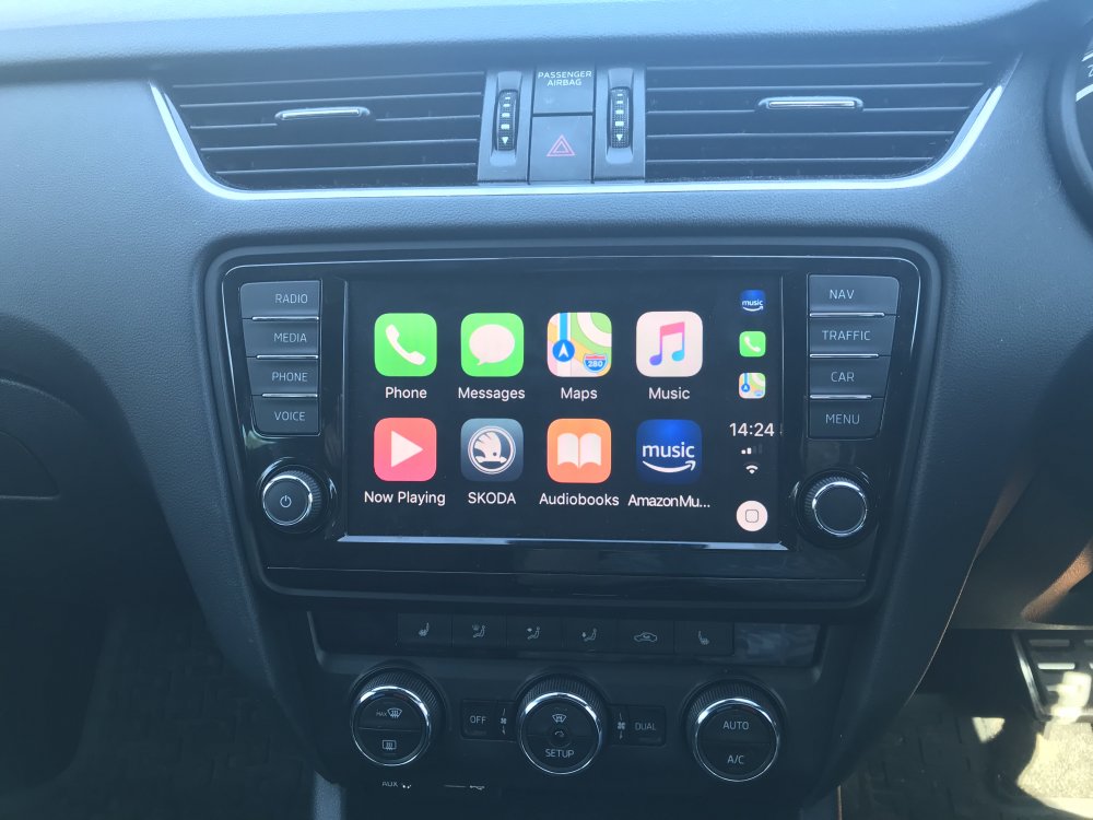

There have been a great many people that have struggled with the swap, but I have to say, my experience couldn’t have been easier. I think I’m done messing with the audio system in my car now haha
Just to show you what you’re missing if you’re an Apple user...
I should note that I’ve relocated the USB to the centre console, as standard you would have to have a wire plugged into the socket on the bottom left of the image.

I bought an Amundsen radio and screen from a crash damaged car and had the component protection removed by my local Skoda dealer. This seems to be a sticking point for some, but my dealer were game to do it no problems. Once that was done, I sent the unit away to a forum member in Poland for the coding to be done to activate the voice controls, nav, SmartLink etc that weren’t working once the CP had been disabled. After a month or 2 of loving the new radio for its extra features/better sound/updated UI/faster processor, I took the plunge and bought a Columbus 8 inch screen to complete the package, as all MIB2 radios can support an 8 inch screen. The relocation of the USB is also detailed in the thread, that’s just a case of removing some trim, drilling a hole and routing a cable.
I used my car happily without the CarPlay for a bit, but I was given a courtesy car with SmartLink on it and I really saw the benefit so I went for the upgrade. I would say the Bolero radio is OK if you’ve never had a car with CarPlay/Android Auto on it and you don’t regularly stream music from your phone and you don’t want/need full control of the collection. Via BT you can only play/pause and skip tracks in a pre defined playlist rather than access full browsing facilities. The BT music connection was as crisp as the DAB/FM/SD music and having those extra features as well as a CD player may be enough for you (as I have an Amundsen, my car doesn’t have a CD player anymore). For me the biggest issue with the Bolero is the screen. Very low res and bezel heavy. The 6.5 inch MIB2 screen looks much better but the glorious 8 inch screen from the Columbus (or indeed the FL cars as it’s the same sort of thing but with touch buttons instead of physical soft keys) is really the one to beat IMO.
