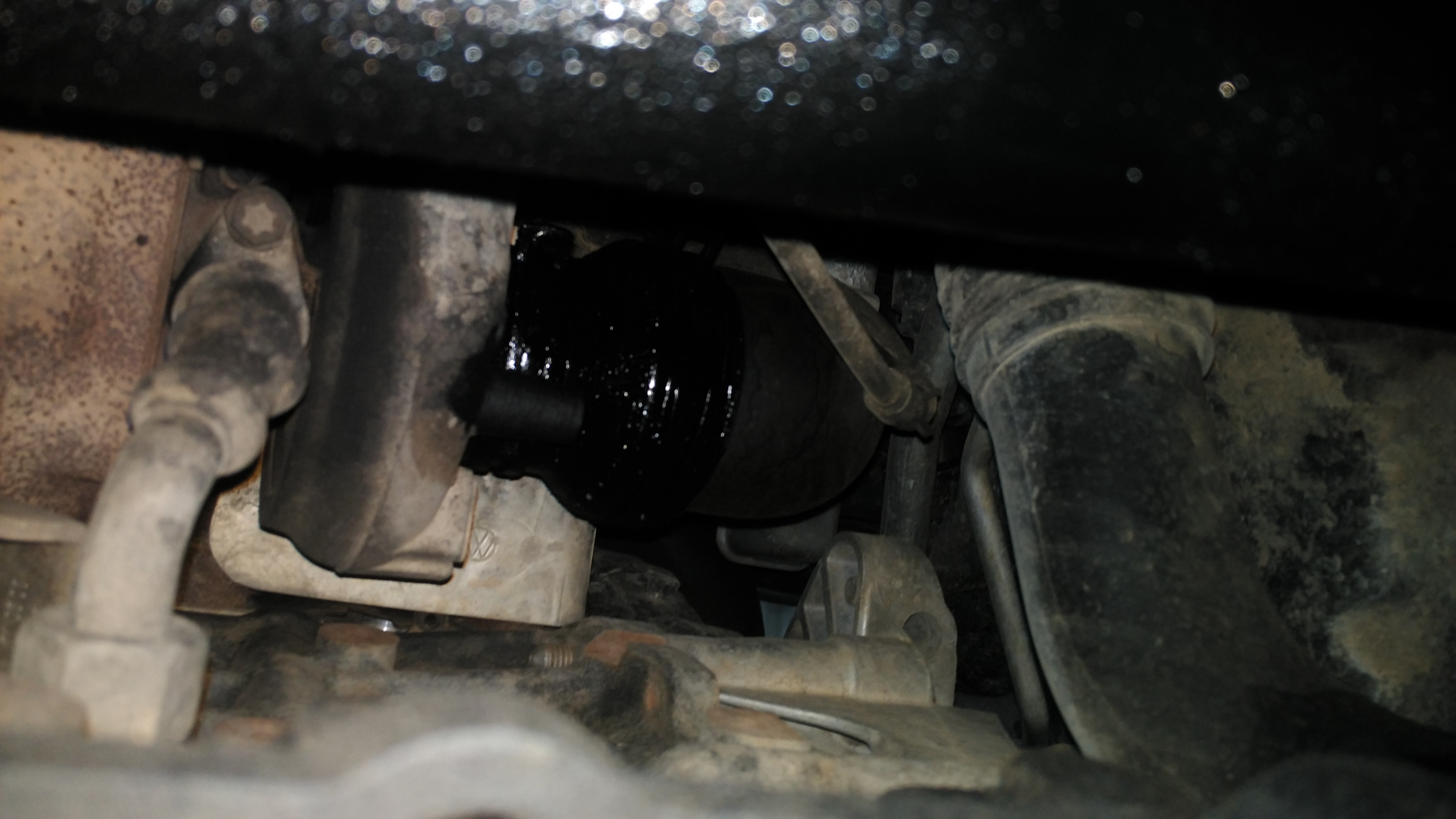

Possibly just PCV residue not uncommon on couplings on intake tract and intercooler connectors.  Depends how severe the weeping is on the turbo.  Need some photos to go with their description. Is it using oil?  A PCV replacement could also help if it is passing excessive oil into intake pipework.

Hi ,
I also came across similar  situation where there was a Oil was leaking from turbo unit (Picture Attached) and Skoda ASS told i have to go for Turbo Replacement .. I took my car to local mechanic and lifted it up and opened and inspected.. the PVC Hose pipe which is connected to Turbo was weak , so the mechanic opened the pipe and Put some rubber kind of stuff around it and heated and fixed it back (he didn't had a stock to replace ) and its fine now :) S
