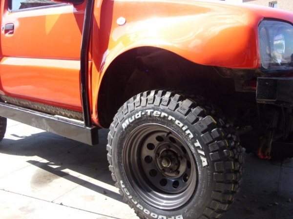

I have run plenty 4x4 offroaders over the years, and used them on road as well, and keeping balance weights on can be a problem, hence i use Balance Beads and have done me well even with BF Goodrich (Michelin) tyres.
You certainly know when you lose a balance weight when wheels / tyres were fitted with them.
As to 4x4s and tyres spinning on rims, that is why people use rim (bead) lockers, as we did with motor bikes as well, trials etc.
& Dyna balance beads are perfect for motorbike wheels / tyres.
http://dynabeads.co.uk
Simpy clever to use them.

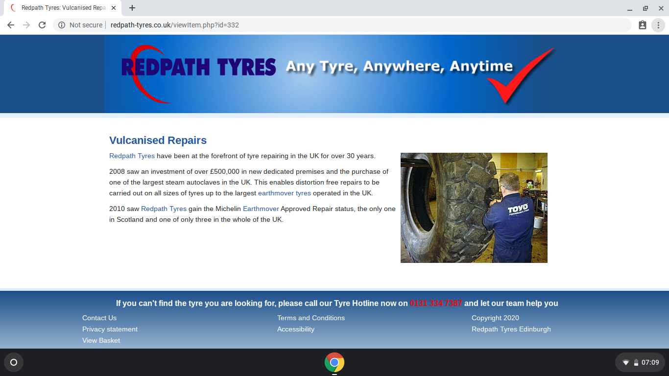

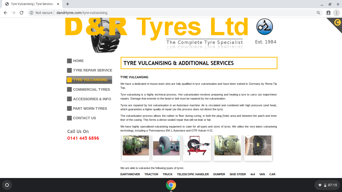

Valuable tyres can get sent for hot vulcanised repairs and the turn around can be 2 days, quicker if you have someplace near you that does it.
http://candstyres.co.uk/tyre-vulcanising
