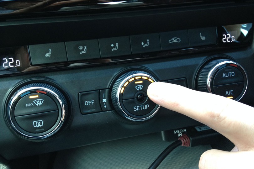

does anyone know if I can retro fit a heated screen?  as my cracked one is not heated, I realise I will need to pay extra,
will the wiring loom be in the car, anyone know?
cheers
I think the chances of getting your insurer to replace your non-heated screen with a heated one are zero. They’ll replace like for like. They won’t be interested in retrofitting anything.
The wiring isn't there, to the screen or the CANBUS, or the dash switch.
It'd be cheaper to sell the car and buy one with the heated screen.
Ok thank you Silver1011 that was the info I was after, I was willing to buy the screen myself, not expect my insurance to buy it, but now I have been told wiring isn't there, it's not going to be cost effective.
cheers
Edited by andyasjl
Whilst the windscreen itself is likely to be the most expensive component in a possible retro-fit, I'd imagine the wiring, coding and compatibility with the cars CANBUS will cause some significant headaches.
Then there is the new Climatronic panel...
