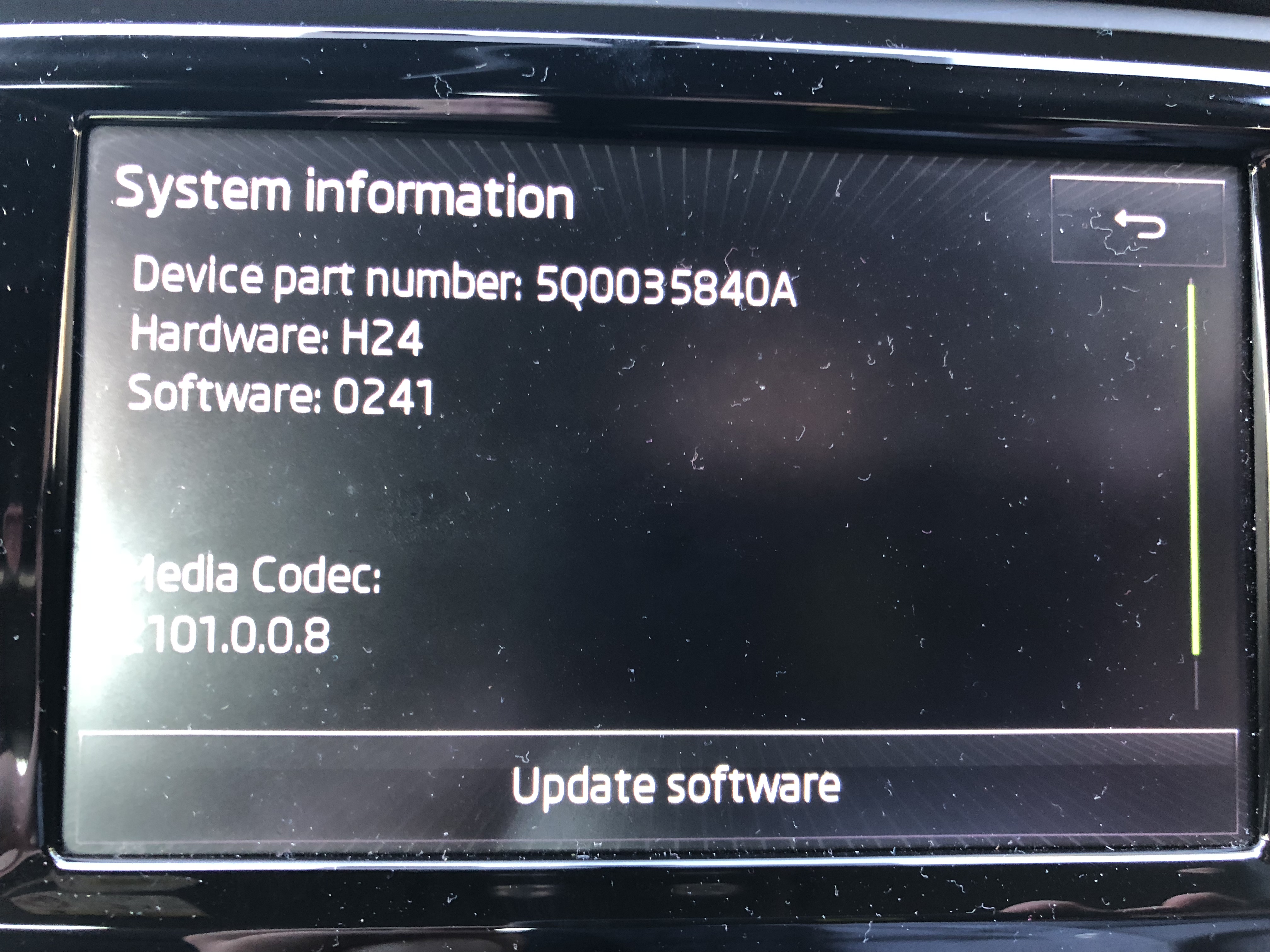

I’ve had the iPhone X since it launched last November and never had an issue, my vRS is 2015 MY16 with Bolero Hardware H24 and Software 0241, to the best of my knowledge it hasn’t been updated since it left the factory. If you are running older firmware it might be worth upgrading or you could remove and re-add the phone or finally a last resort reset the system.

I can see that there is an update to the bluetooth software - I will try that.
The update of the bluetooth software unfortunatly didn't solve the problem.
