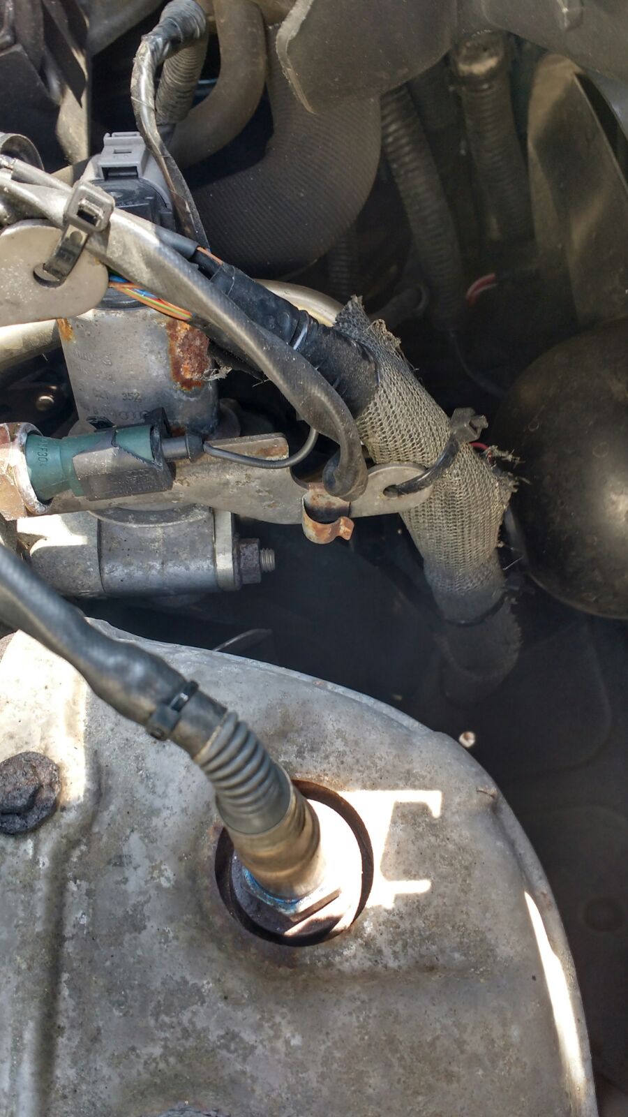

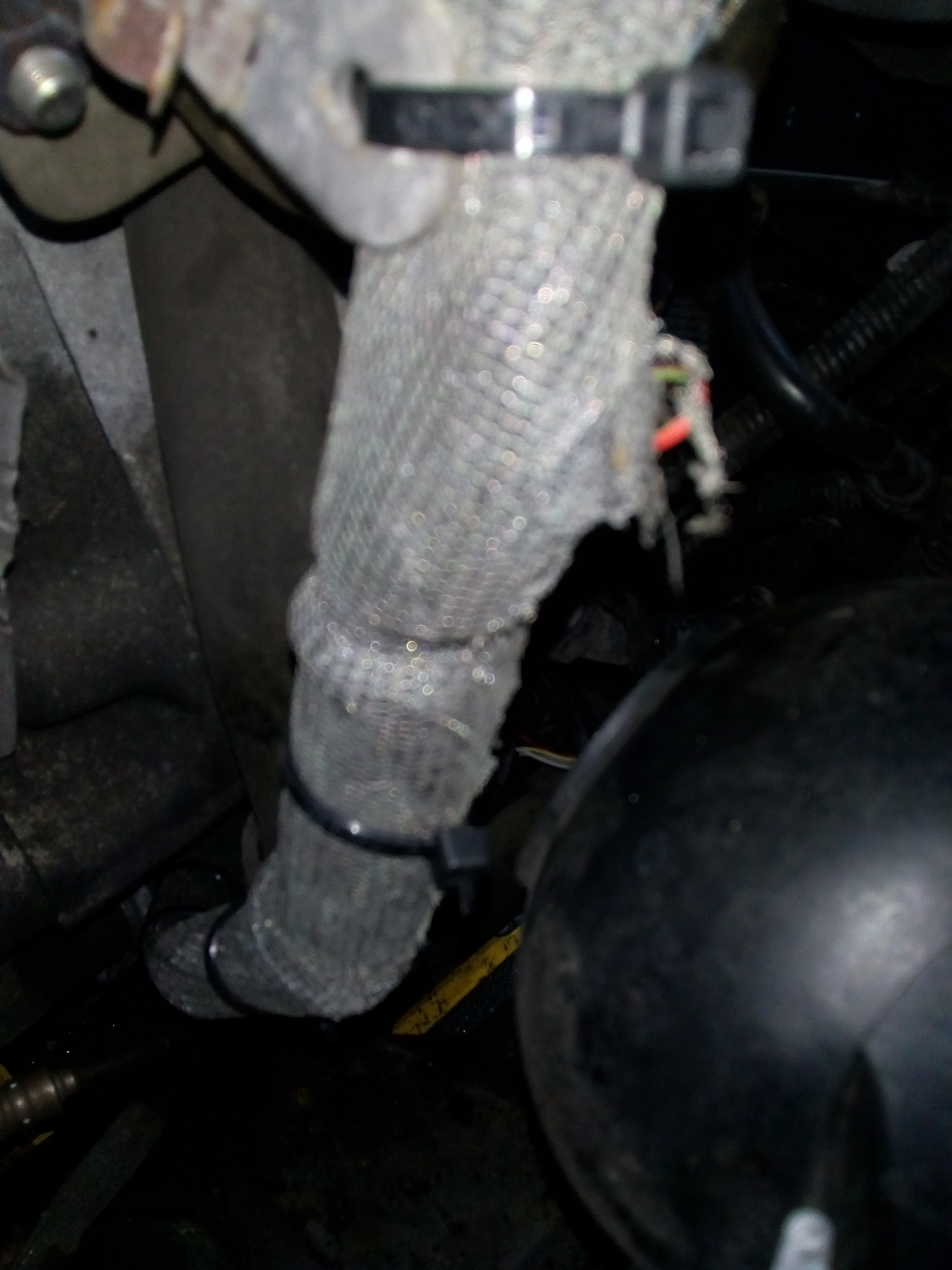

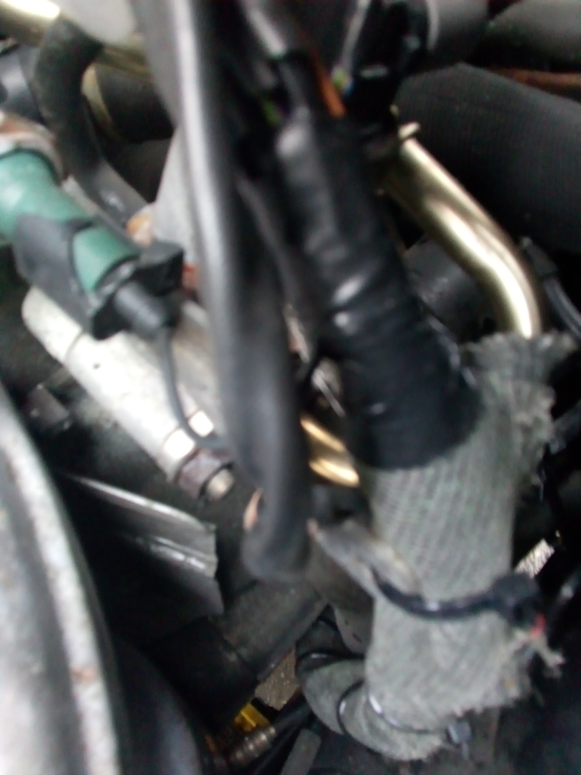

When I had the AA patrolman out we had a kook with hte engine cover off and found the following . looks like someones been messing around with the wiring there !

Some of that "rewiring" will have been done to fit a new Lambda probe B1 S1, but normally if you buy the correct Lambda probe it comes with its own heat shielding, so I'm guessing that someone has just fitted a "sort of suitable much cheaper works with any car maybe, for a short time if you are lucky" Lambda sensor?

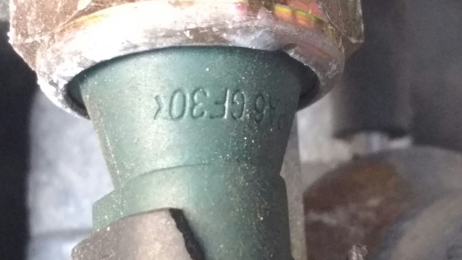

As Ken says 'real' low oil pressure (as opposed to false warnings because of electrical/sensor issues) is a very serious situation, so not to be ignored.  Try to eliminate false warnings by inspecting the wire closely, and maybe splashing out a few quid on a replacement sensor - the green one in your photos - (and connector by the looks of it). No UK Mk1 Fabias have oil level sensors as far as I know, so it won't be that.
For the engine warning light, scan it with a handheld scanner, or hook it up to VCDS for better info.  Adding an approximate location to your profile may help match you up with a VCDS owner.

Fantastic responses thanks. I bought the car due to the low mileage and FSH which included annual oil changes. Engine oil was as clean as a whistle and my strong feeling having read the handbook is that it it is a wiring fault maybe caused by the butchery with this lamdba sensor replacement.

See if you can see any part number info on that lambda sensor,  it may not even be the correct type.

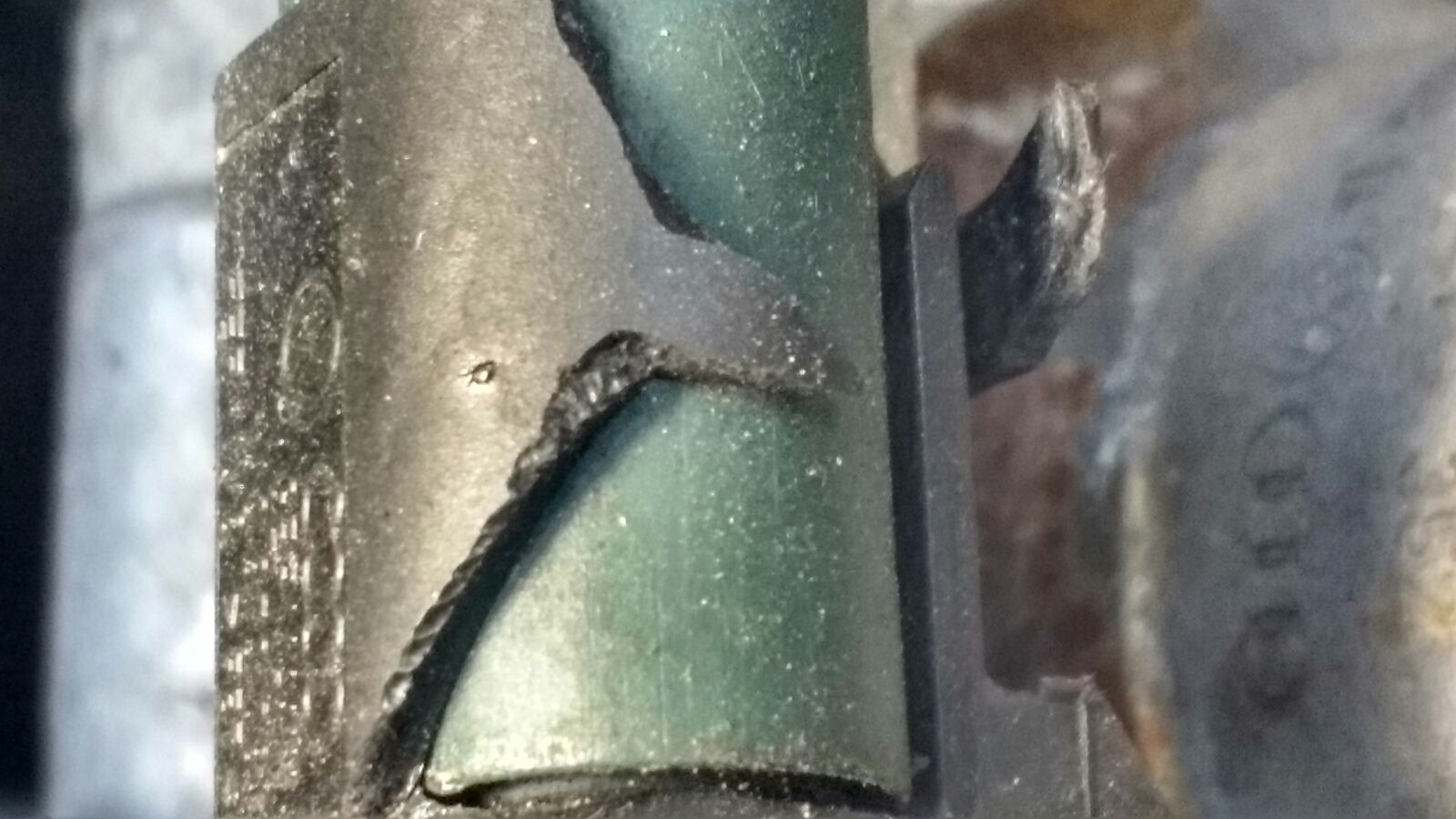

sorry for taking up so much bandwidth everyone ! Heres some more photos I took this morning if it helps at all . what i understood from the code read was that it was an intermittent fault. Im new to these cars but it seems that some one has buggered around with the EGR valve and the wiring pretty inexpertly. whether the lambda sensor is original or not I dont know . Im going from Haynes which is not the most reliable of sources I have found in  past.

An exceedingly rude picture of a connector there, showing too much of parts that are normally hidden!
