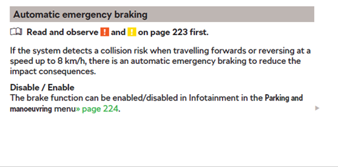

It's explained in the manual (p226 of my pdf version). Essentially at low speed, forwards or backwards, it will do exactly as you saw.
How it works is explained a couple of pages earlier.

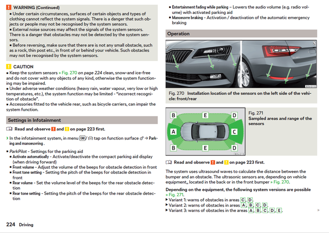

I have read (skoda site iirc) parking assist, manoeuvre assist, and low speed crash avoidance (front/rear) rely, at low speed, on the ultrasonic sensors rather than the radar units, which are probably not fitted on cars without blind spot detection.
On a more serious note, I think you are right @xman in that at least some of the assist systems are driven by the sensors. For example I have the side sensors and I'm told they will detect cars approaching from the side if I am reversing out of a car-park space. Never had them trigger (yet) as I tend not to park nose-in. But I also have the blind spot / rear-end radar system so don't know if that is also involved in some way. I agree it is unlikely the radar units are included in cars without blind spot monitoring, otherwise I'm guessing it could be enabled through vcds.
Front radar (in the grille) is included on all Superbs, and is used for Front Assist  (the ‘front braking thing’). Can also be used for ACC (optional).
Side sensors (two front, two rear) are used for Park Assist.
Front and rear sensors (optional) are used for Optical Parking System and Manouver Assist.
