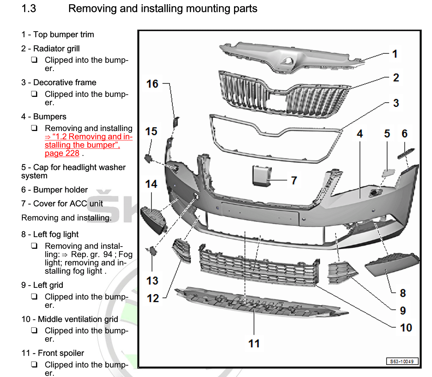

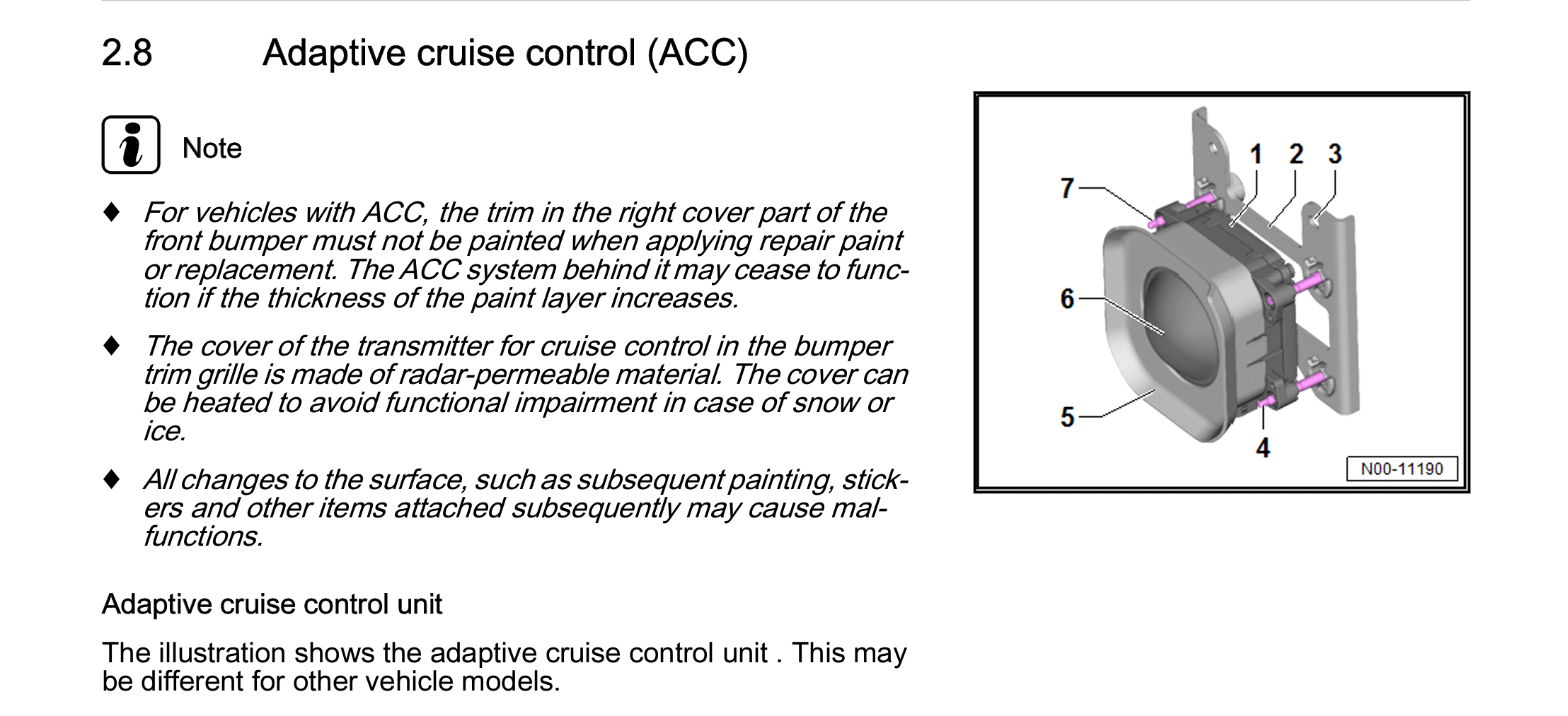

and for illustration purposes, so people know where the ACC unit is and what it looks like.......
Item #7 = ACC Cover.
Hello
Can the acc cover be removed? How to take it off , i need to see how many cables the plug has .
Thank you
7 hours ago, Camarao69 said:
Hello
Thank you
The ACC cover is part of the bumper/grille.
It's not clipped or connected physically to the ACC radar itself.
I don't know how to take the radar off.
I personally wouldn't do it, let alone touch it!!
U risk upsetting it's calibration, and will b very expensive exercise to get the workshop to re-calibrate the radar for u again.
I just  want to remove the cover (plastic thing in front of it) if it ispossible , i'm retrofiting a5 camera  and there has to be 2 wires conected direcly from camera to radar , some people say that the cables are already there  and e need to confirm, if yhe wires are there i jus need to tap them inside the cabin.
Is thera way just to remove cover (7) without braking it ?
As I said before, the cover is part of the bumper/grille.
So if u remove the bumper, the cover will b off.

3V0853655ACLL  chrome
3V08537612ZZ Black
It comes off   but maybe the bumper has to come off to. It has 4  pins\fittings that secures it in place.
Here is how to do it
