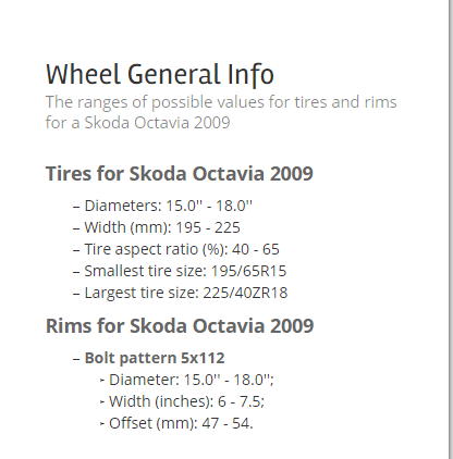

Max Diameter = Well, Max Diameter, which I guess would be maxium size of wheels, which can be fitted, which I know is wrong, since I've seen a 1Z5 rocking 20 inch wheels.

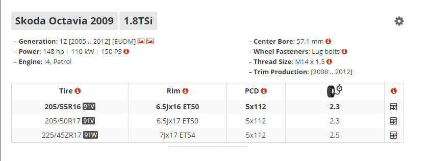

The next 2 screenshots are from Wheelsize dot com, which shows different measurements, which confuses me even more.
So if somebody could make a dummy like me understand the appearant science behind this, I would appreciate it very much, thank you.

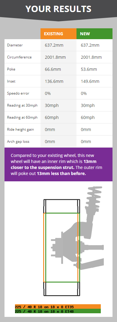

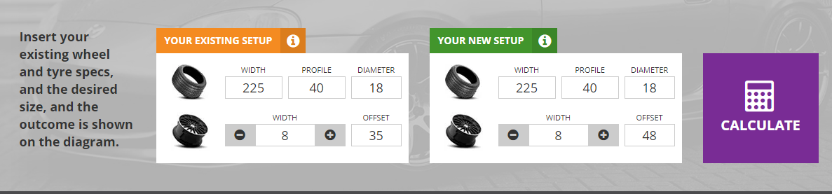

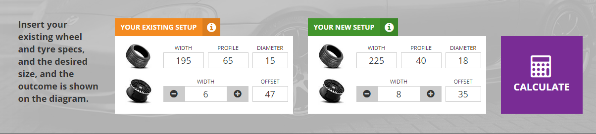

There are plenty of website that allow you to enter the old/new wheel sizes to see what difference it'll make to help you understand this: https://www.willtheyfit.com/

Which is why I didn't get willtheyfit at first because it just showed me numbers instead of actually telling me why the ET number differentiate depending the inch width.
Have found a possible solution though so this might not be total disaster afterall, since I found a similar pair with an ET48 compared to the ET35 I currently drive with.
