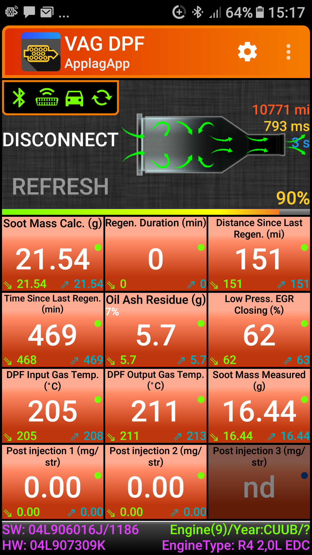

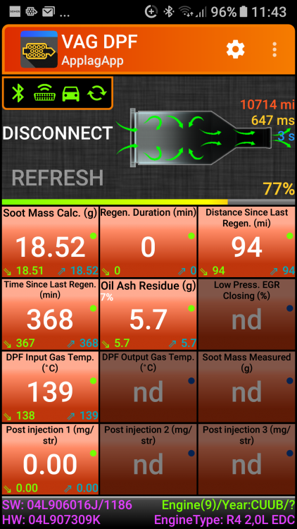

Here I go again. Can anybody interpret these 2 VAG-DPF  screen grabs taken this morning. The first pic ahows readings before a 55 mile non stop dual carriageway run at 2000 rpm in 4th & 5th and the second when I got home. Costantly checking the DPF reradings as they went up and up and no regen happened.Do not want the car to go into unwarned limp mode again as it has done 4 times before because I have a 6am start on Friday June 1st to get to Manchester airport for a 2 week holiday in USA. (70 mile motorway trip)
5b0c269f4ad07_2Screenshot_20180528-114353.thumb.png.e29f39914263b3764338b6af7e6bdcd8.png5b0c26a395576_1Screenshot_20180528-151710.thumb.png.0bc3ab269eeff17f67d74e9fa164bb6d.png
Help wanted as to whether I should try another long run to try and get a regen to happen. The photo shows 21.54 soot mass and 90 % full filter.

The bar graph across the top indicates how full the filter is with soot, not ash. when it gets to 100% the ECU should start a regen which will (in my case) take it down to about 23% so at present nothing to worry about. the figure that is important is the oil ash residue this tell you how full of ash the DPF is.
you do need to tap on all the squares to activate them as some are not active at present.
you have another 10% to go before a regen depends on how far you are from the airport.
I find that unless i am thrashing the hell out of the Yeti it rarely goes into passive regen I did once manage to keep it in passive regen for most of a journey to Devon and back (M4/M5) which was done at above 2500rpm for the whole journey.

Thanks for that Idleness it's just that I was told some time ago thaat when the soot mass gets to around 22 it would automatically start a regen?  Just worried that the car will go into limp mode before my very important trip on Friday so will have another dash up the motorway tomorrow to see what will happen.

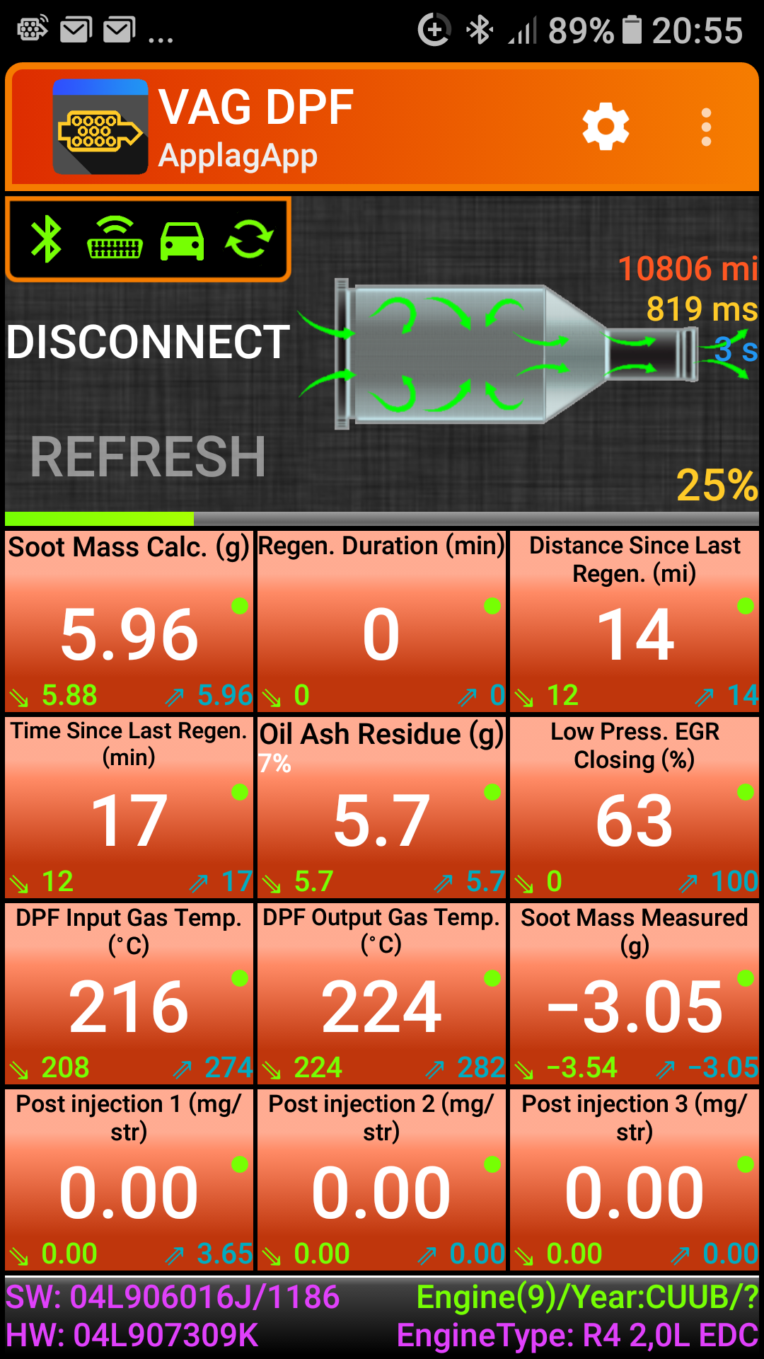

Can now go on my airport run  without any worries. see the screenshot .
5b0c66b57a5b6_3Screenshot_20180528-205523.thumb.png.81224ab3842a8b518c27fa1b369c922f.png

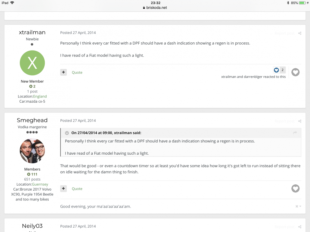

If there was a light/indication there would be no need for anybody to be unaware and no need for apps
If there were a light which came on every couple of hundred miles, apparently at random, then the dealers would be full of people complaining about a warning light which comes and goes, people demanding it be fixed because the light shouldn't be coming on if everything is working okay therefore something must be wrong, people driving 20 miles past their destination because they're too scared to stop because the light is on and they know it's doing a regen, all sorts of issues.
