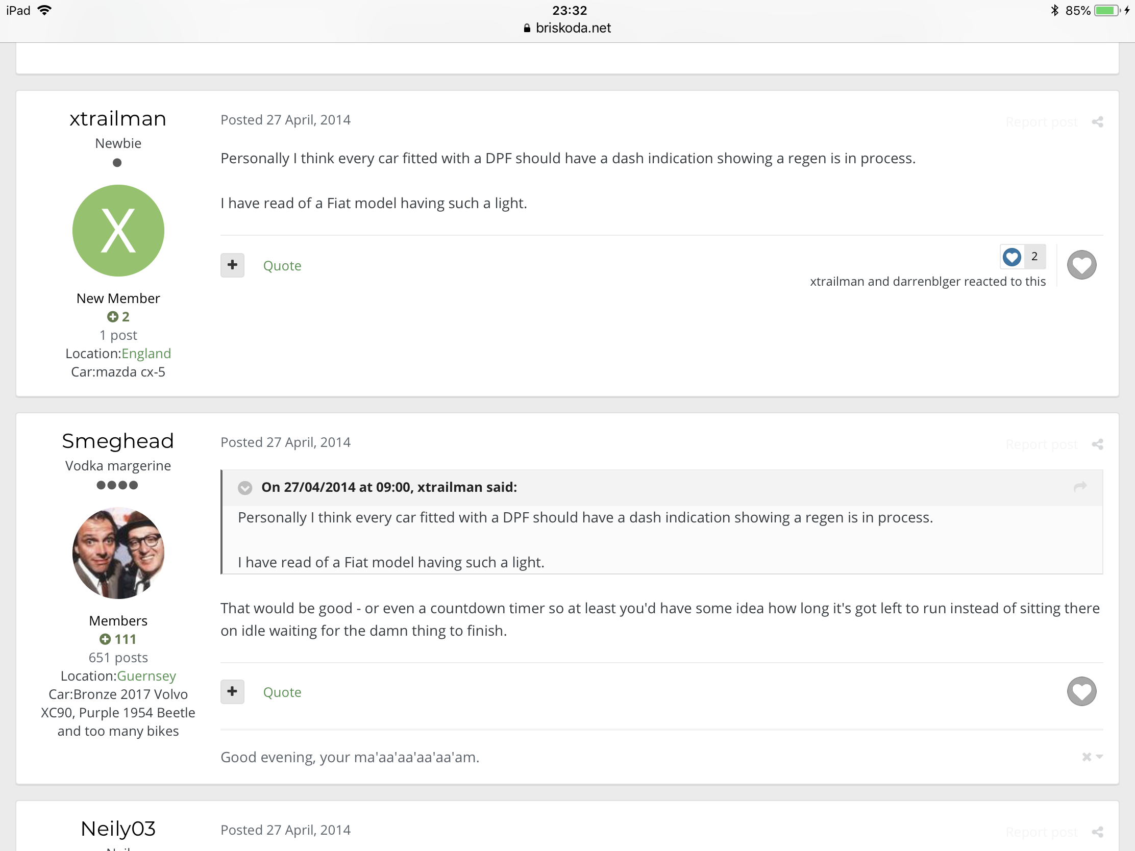

Idleness suggested they never interrupt a regen in progress and continues driving to complete it.
Ajay24 is concerned since having a warning light and took an unnecessary extra drive in an attempt to force regen.
Xtrailman gives no reason in the quoted post.
Smeghead also seems afraid to interrupt a regen, leaving the car to idle while it completes.

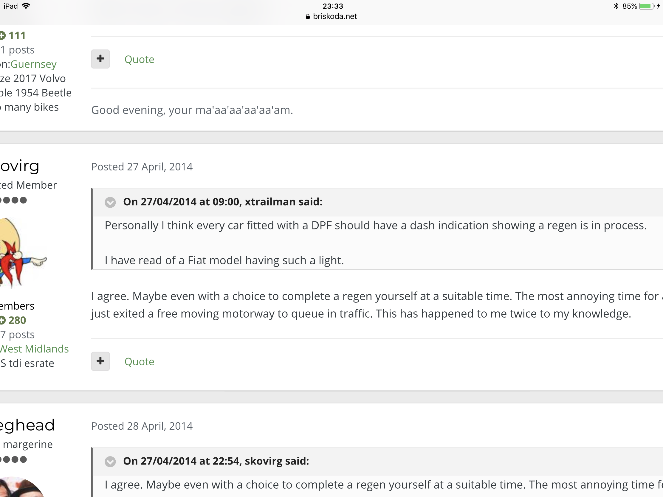

Skovirg looks to want to schedule regens but I'm unsure why.
As has been stated previously, it's perfectly fine to interrupt a regen and there is no need for extra drives or any attempt to schedule a regen unless the car requests attention.

^^^^^^^^^^^As I said earlier” if a regen is occurring too often or never how do you know” it’s just my and others opinions were all different don’t get hung up over it.and from your amount of retrofits it appears you have ,its your own personal choices that many others don’t have need or want but unlike you I respect other people’s choices and I’m sure-the footwell lights and teardrop wipe are very handy for u as a personal choice but for thousands of others don’t find the need but if these toys give you pleasure ,why not!
