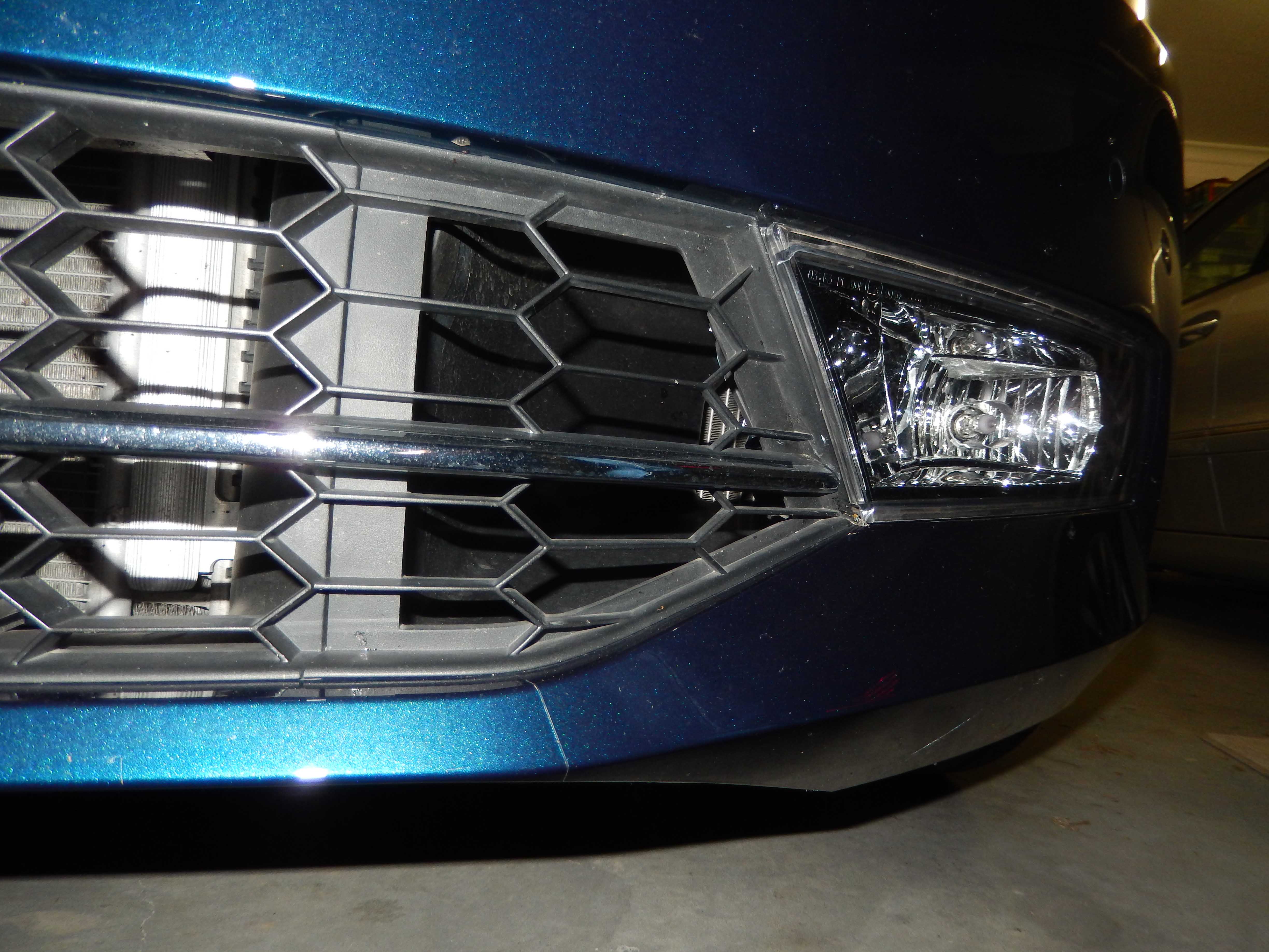

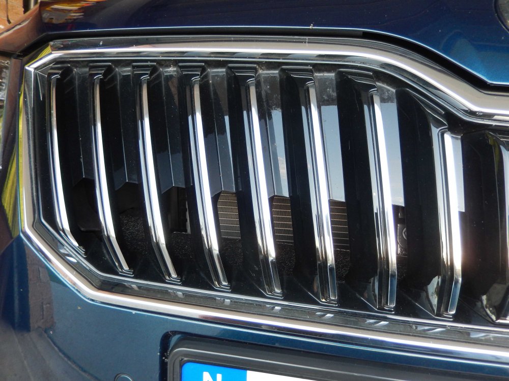

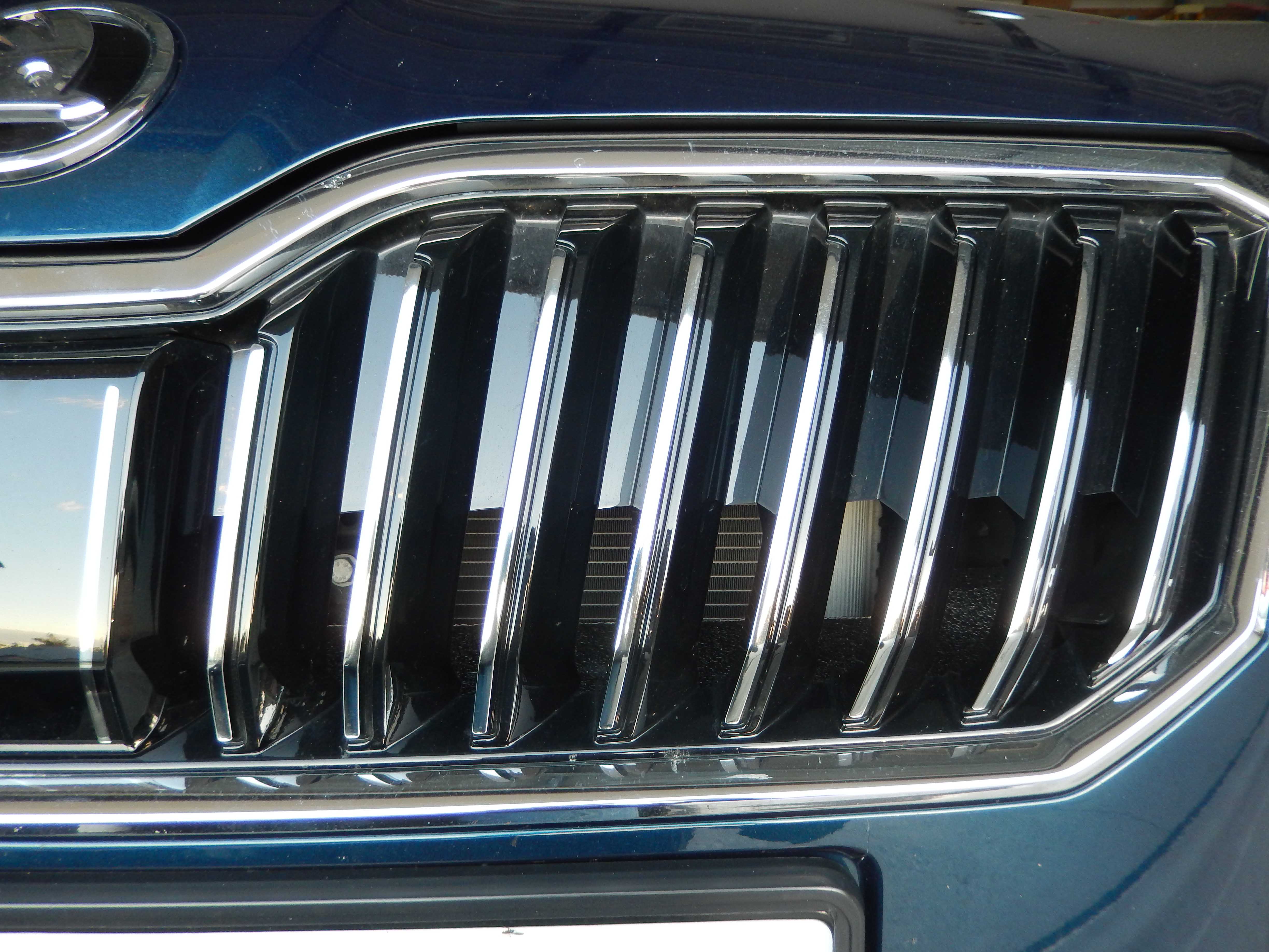

The Superb III radiator grille allows less than a half the amount of air into the plenum in front of the radiators it could if the grille bars were all open.  I can understand restricting the airflow in cold countries, but I live in Australia.  I am a little surprised there is not different grilles for different countries, depending on how hot the climate is.  I have attached some pics of my grille.
Has anyone tried to open the closed grille bars by cutting away the plastic?

There's an air intake next to one of the fog lights, no?   One of the access panels to the fog lights is usually solid and the other isn't, to allow air flow for the intercooler that sits right behind the foglight.   I'm sure the apertures that are already in your front grille would be adequate enough anyway, those gaps are plenty big enough to channel air into the engine bay, surely?

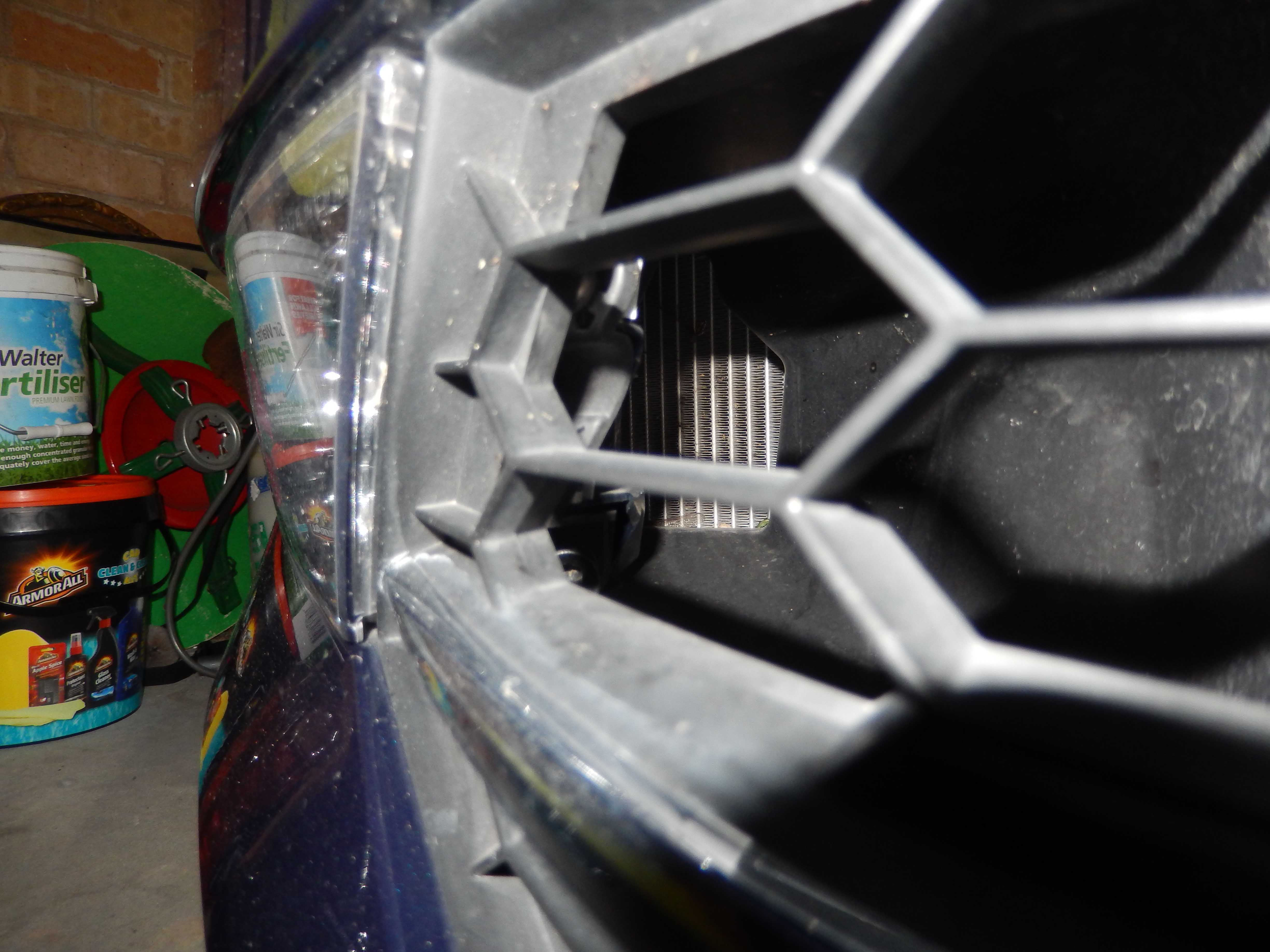

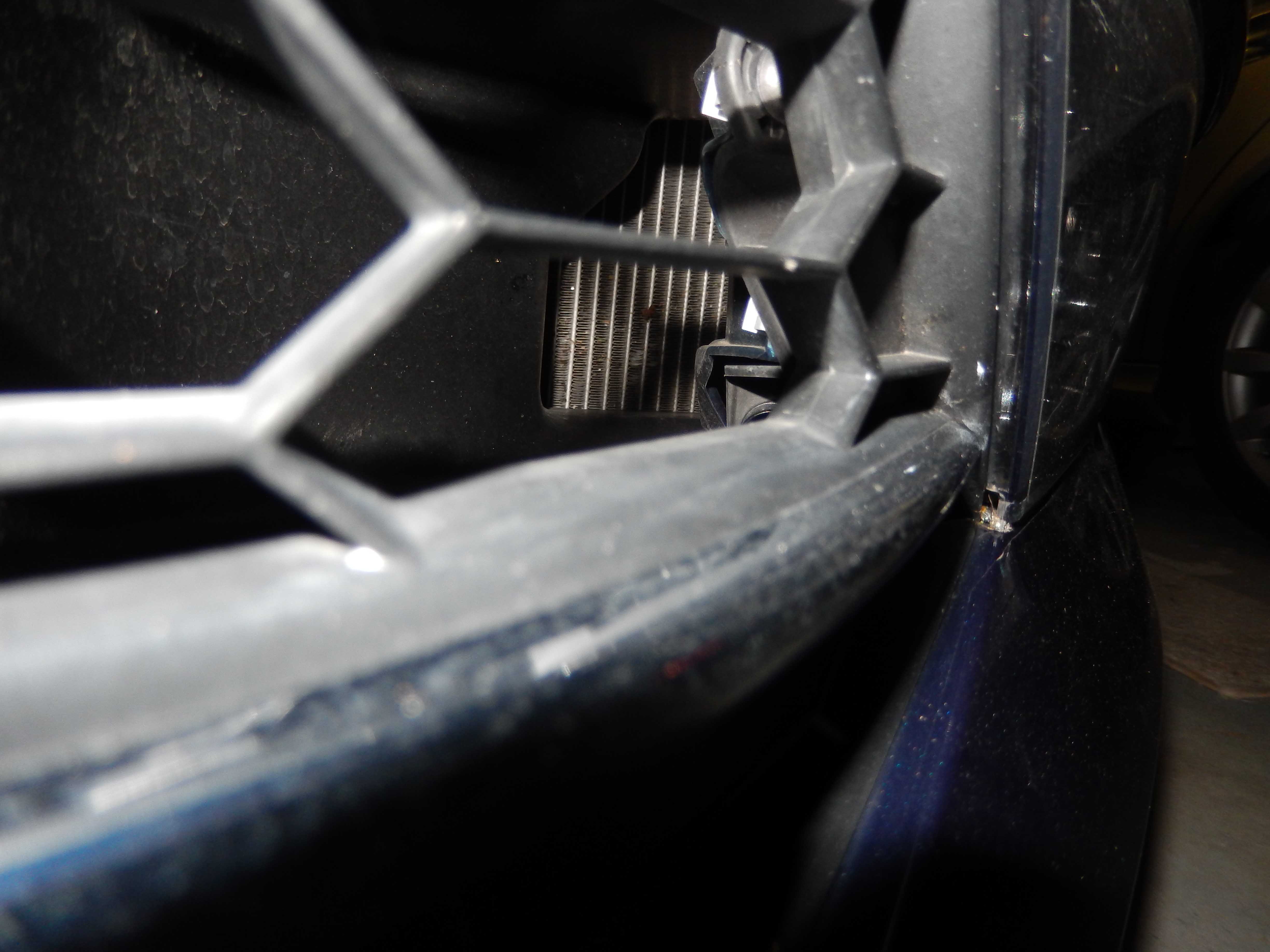

Yes, there are air intakes on both sides of my car, but they are for additional coolant radiators, not the intercooler.  Pics attached.  You can just see the intercooler and coolant radiator in the third pic.
