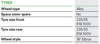

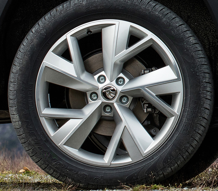

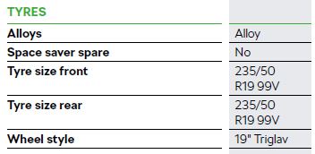

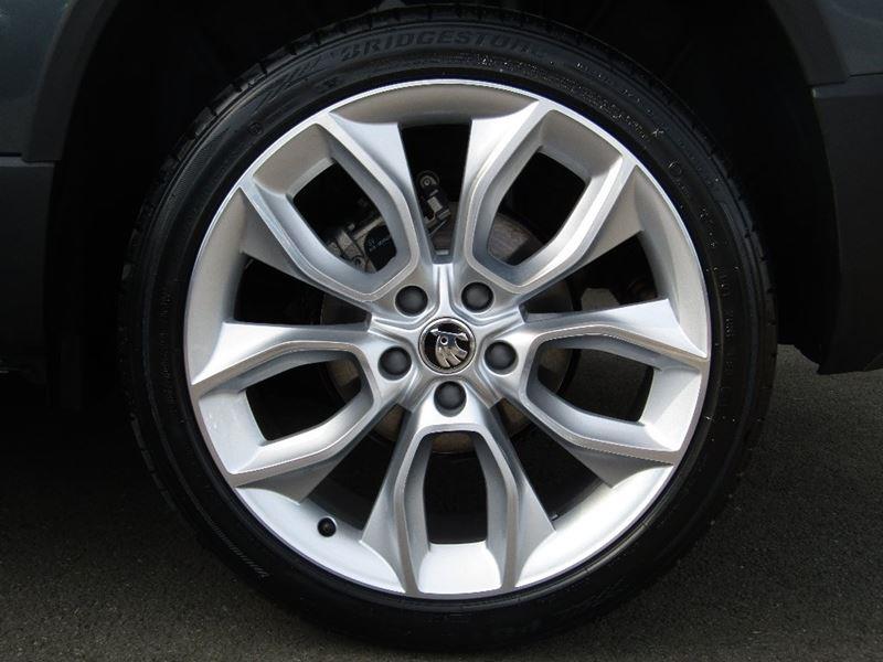

5b1251d6b3bb5_Kodiaq19Sirius.JPG.65f56fba03149641a3f193155a17aca4.JPG   5b1251d9a6a3c_Kodiaq19Triglav.JPG.bde29935054c03e0ec83c5e8db3c2a8c.JPG
5b1251dcce249_Kodiaq19Crater.JPG.07a0f6c018b391d29bb539372e292761.JPG   5b1251dfc121c_Kodiaq20.JPG.6ae9c043d96e0e5eb6efda5054100671.JPG

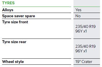

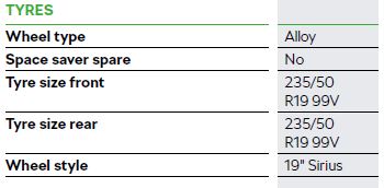

Karoq Crater 19" Crater vs. Kodiaq 19" Triglav...
Karoq Crater - 235/40 R19...
Kodiaq Triglav - 235/50 R19...
40 to 50 profile makes a significant difference.
2 hours ago, silver1011 said:
silver1011, are the above charts screen shots from somewhere? My Edition 19'' Craters are shod with 225/45/R19 tyres, as per Vectis. The link to the Tire Size Comparison website shows quite a significant size difference between the 235/40 and 235/50, whereas the difference between 225/45 and 235/50 is marginal. The reason I'm asking is that I have a set of Sirius 19" wheels which I intend to fit with full winter tyres later in the year.
According to the Slovenian configurator, the supplied tyre size also depends on drive type.

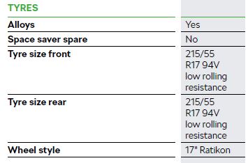

On 17" rims you get 215/55 R17 tyres with 2x4 but 225/55 R17 with 4x4;
on 18" rims you get 215/50 R18 tyres with 2x4 but 225/50 R18 with 4x4;
on 19" rims you get 235/40 R19 tyres with either drive type.

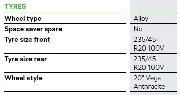

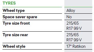

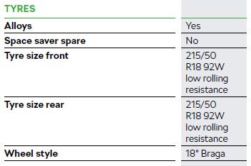

I got them from Skoda UK's 'Karoq Pricing & Specification' brochure (April 2018)...
karoq_pricing_specs.pdf
I guess there are two elements at play here, the cars ability to shield its occupants from the effects of driving over rough road surfaces and the ability of the wheels and tyres to protect themselves from damage from potholes.
It's only personal opinion but I think the profile, or the height of the tyre sidewall, plays the biggest part here, hence my preference for a higher profile and also my observation that the larger alloys fitted to the Karoq might be coming at the sacrifice of tyre profile?
Given the choice I'd choose a tougher and more durable set-up over handling and aesthetics.
The reason I made reference to the Kodiaq is that you seem to be able to get a decent mix of both a large diameter alloy for aesthetics as well as a sufficiently sized tyre profile for durability and ride comfort on poorly surfaced roads.
Edited by silver1011

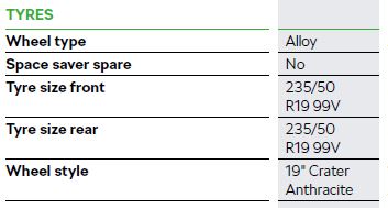

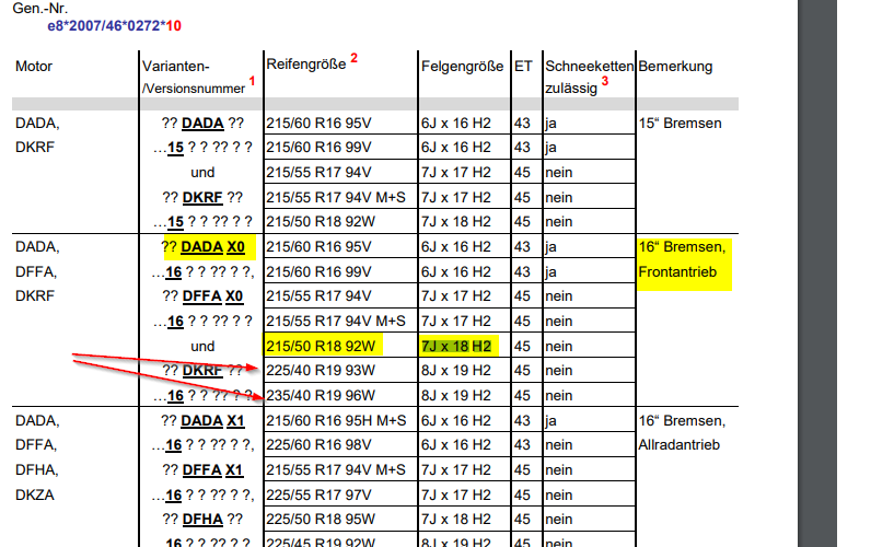

Interesting that the tables and pictures above indicate 235/40 19 tyres on Crater wheels. My 2021 car has 225/40 19 tyres on Crater wheels.
If I am reading this right - the Type Approval does already cater for that size though so at least that's okay 🙂   the chart was from 2018 so I guess they changed that spec for 2021.
I was half wondering if there might have been a new type approval but here it is in black and white (red arrows):
