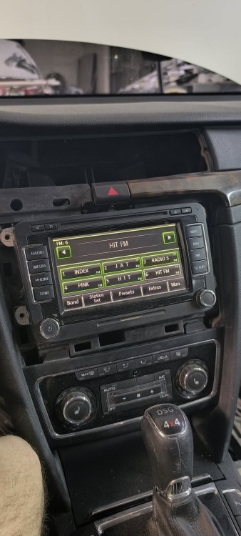

Hello, can anyone help me to update my skoda superb firmware with lithuanian language install?
Part nr. 3T0035680E
HW H64
SW 4024

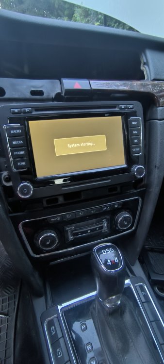

I now have problem when switch to media sistem starting staying probobly bad ssd or hdd any advice how to fix that can i plug out hdd or code something via vcds?IMG_20260618_203011.jpgI
