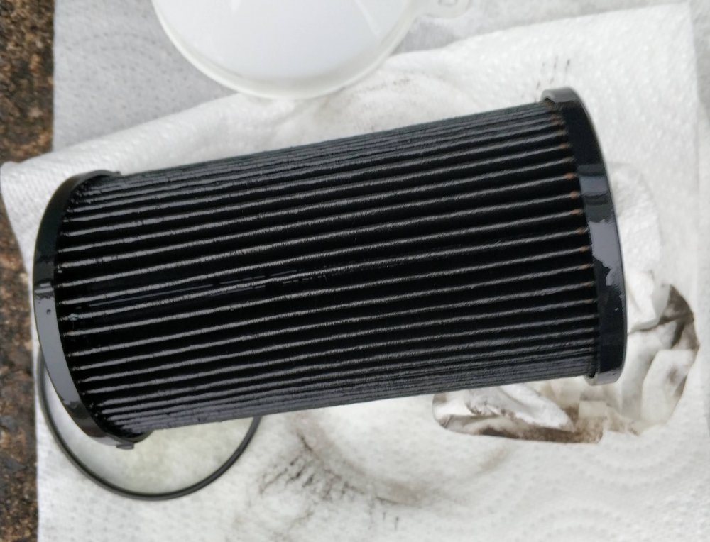

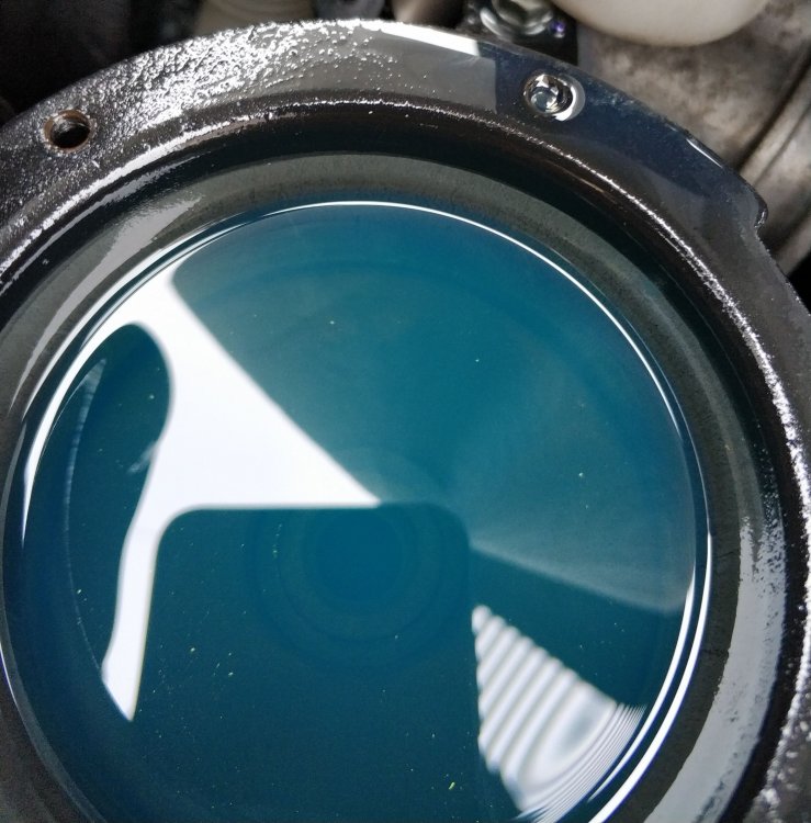

Here are some pictures of the original filter, i think they are definitely metal flakes due to how shiny they are, also I think that could well be the original filter or at least the first service one (car is on 99k now) so it has had a long time to accumulate those flakes, although I am a little worried now.
To be honest, that filter looks about right, ive seen them taken out at 10k and been that dirty. Took mine out when I first got the car and it had what looked like mayonnaise or pork fat half way up it! Really silted up with rubbish.
Not sure what those flakes could be, as its not on the engine end and has been stopped by the filter, so its something from the tank to the housing :wondering:
Could be swarf from the screw holes when the bolts were removed
