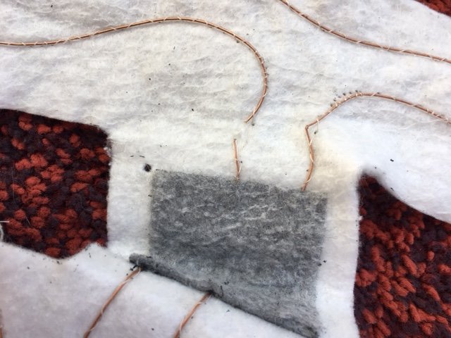

I've added pictures of the heater pad and close up of the broken wire - It seems to have been caused by mechanical damage as the wire beside the broken one also has a kink - like something hit the seat hard where the side squab joins the main seat pad, but I can't think what it was.

OK, so I decided to repair it - shortened a couple of loops to create enough free wire to twist together a new connection - cleaned the wires carefully back to bare copper, tinned with soldering iron, twisted together and soldered again.  Checked resistance was similar to passenger side where there is no fault. Refitted, then tested for several minutes with seat covers off to check function and no overheating at repair site.  All seems good and seat covers back on  :)
