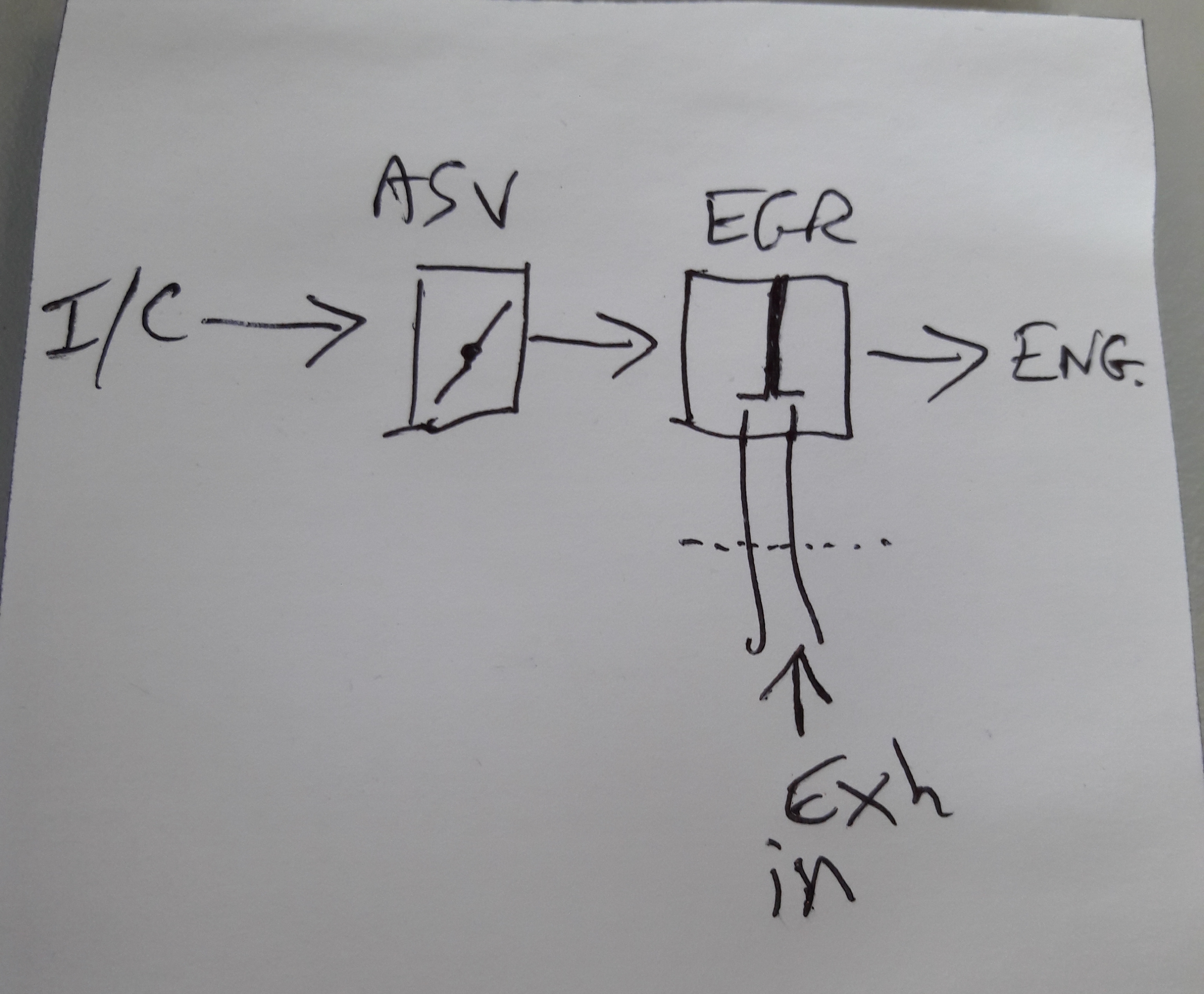

How was the EGR modified? If I blank off the EGR, does that render the ASV redundant, gases can no longer flow through the EGR to it?

You've not totally understood the airflow path into your engine.
From intercooler, through Antishudder valve then through EGR into inlet manifold/engine.  Blocking the exhaust gas input into the EGR (dotted line) has no impact on the ASV.

Some people blank both ends, should be enough to do just one.
