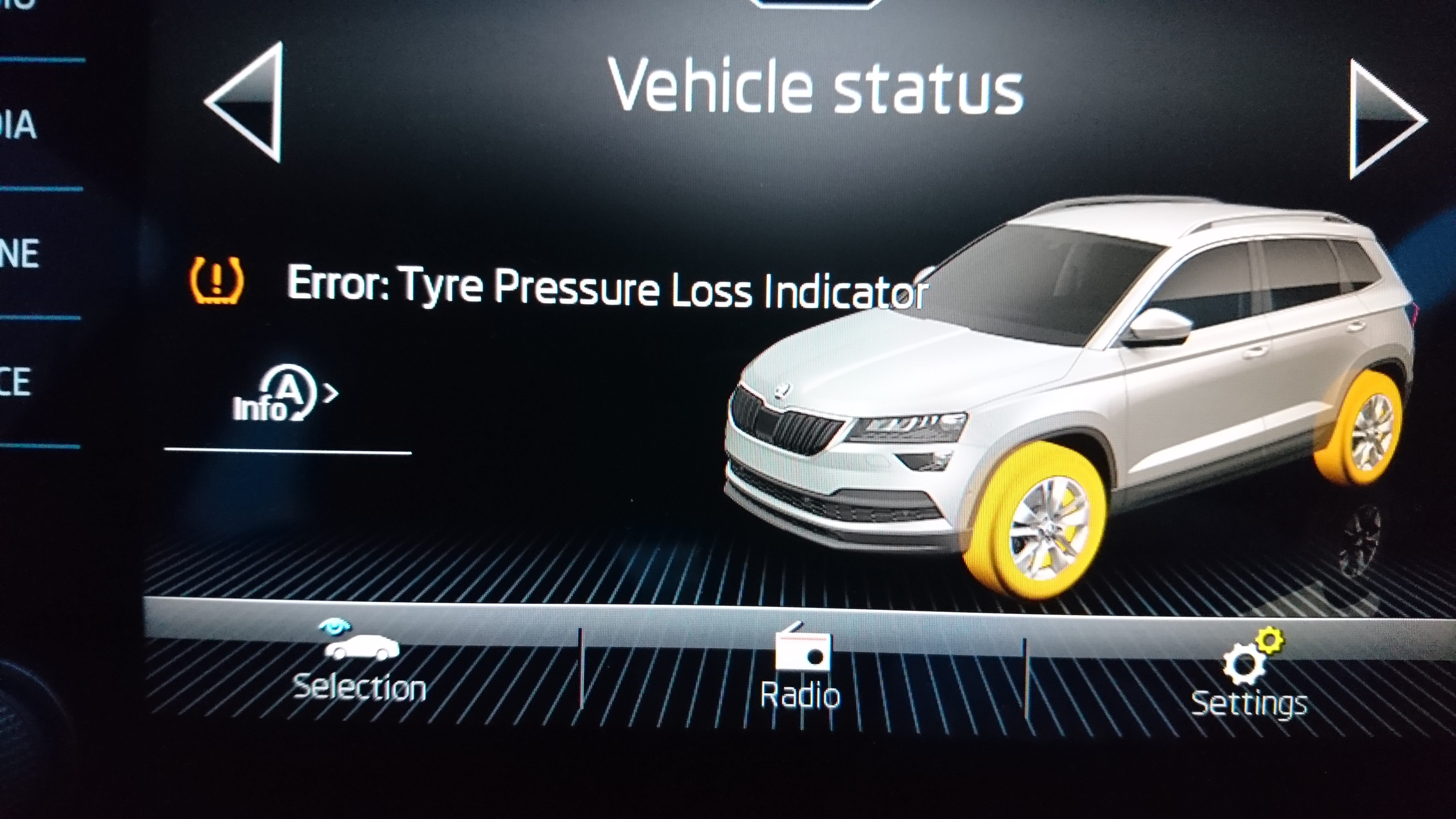

You can bring up the start-stop status screen by going to the car menu, then the "vehicle status" page then pressing on the a-info on the left as per this picture (ignore the warning, got a puncture today!).
This screen will tell you why start-stop hasn't activated. Occasionally I get a "engine must be running" message which is weird though!
Thanks for that. THX
Does it come up with the crossed out symbol (top right of the Maxidot) ?
