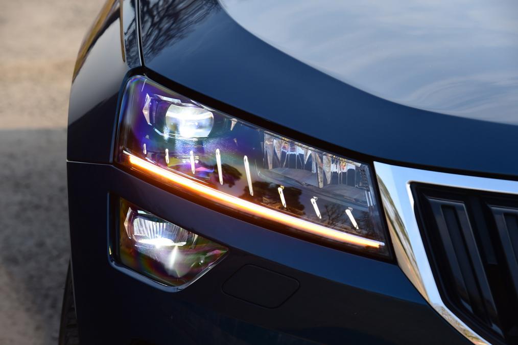

The lower lights have two functions, they are static cornering lights, but double up as front fog lights. It could be that although the wheels appeared straight ahead they were marginally off-centre, hence bringing one of the cornering lights on. The fog lights operate by two pulls of the main light switch, first position for front fogs, second position for rear fogs. There should be two corresponding lights which come on within the instrument cluster.

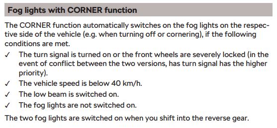

In addition to turning the steering wheel (or indicating) at speeds below 30mph, putting the car in reverse also activates the front cornering foglights.
The difference is that when in reverse, both front foglights light up together, the idea being it helps to illuminate low walls, bollards etc. for when the front end swings wide whilst reversing.
Dipped headlights need to be on (either manually or via Auto) for them to work, i.e. when you're in the darkened garage with the headlight switch set to Auto.

If in doubt, there's always the owners manual, page 72...
