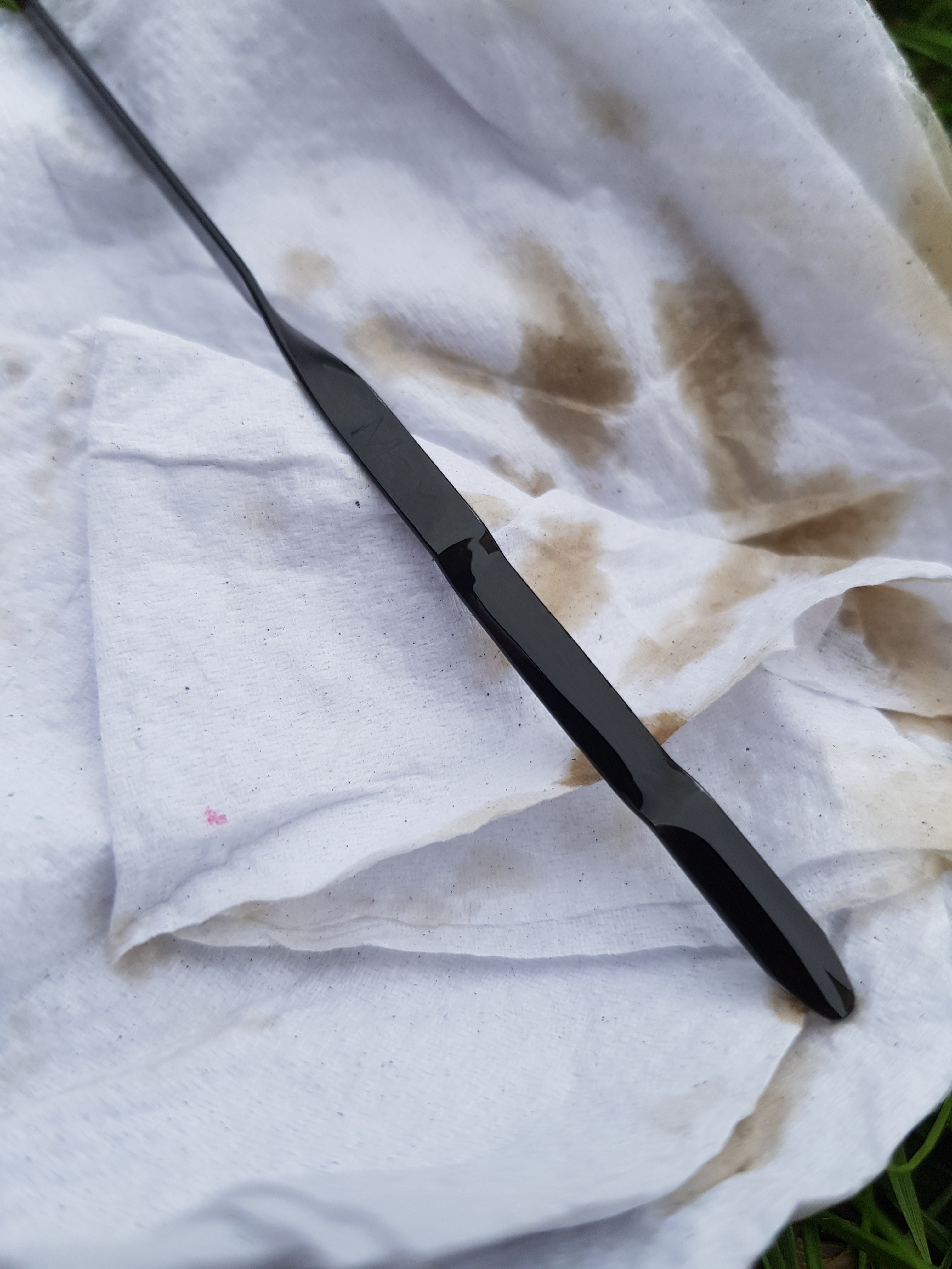

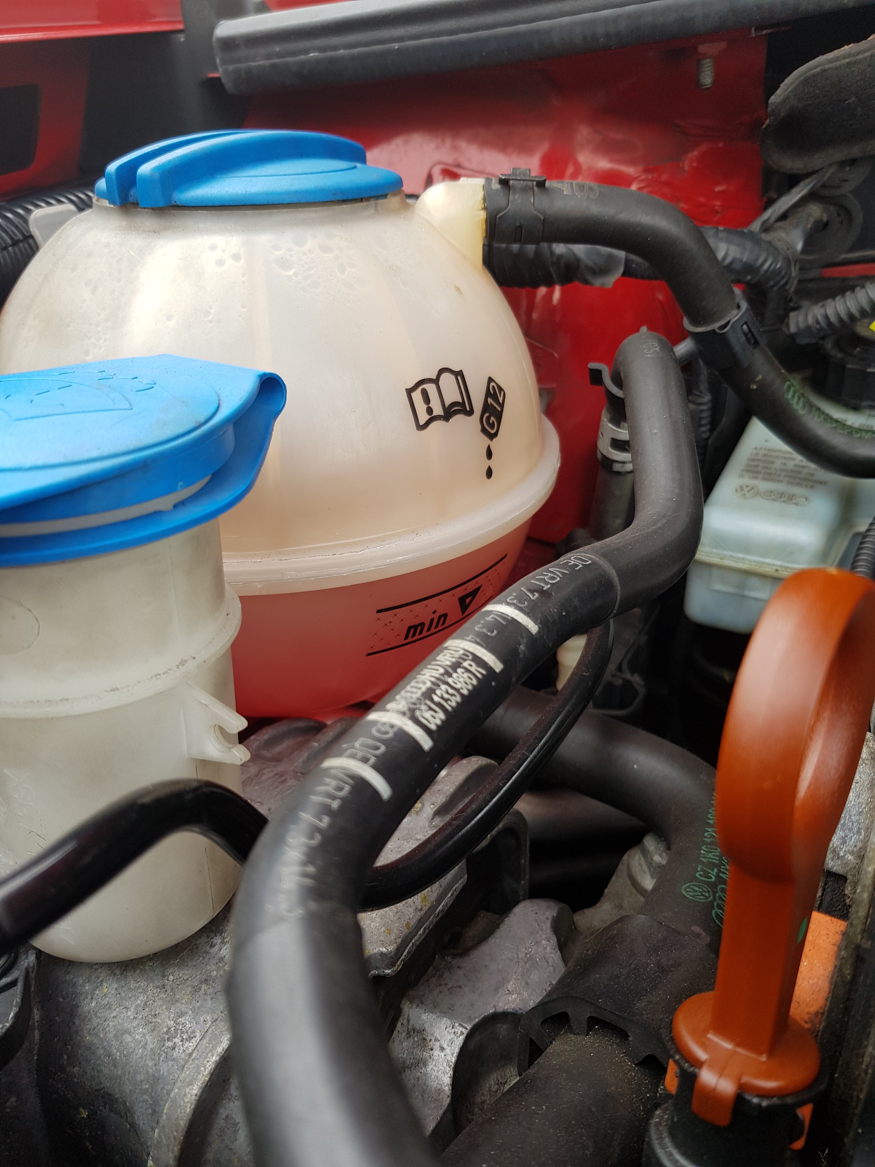

So checked oil when cold and it's hard to get an exact reading but maybe 1-2mm over maximum line. Coolant is 3-5mm over maximum line when cold too. This was on uneven ground also.
I've left it 20mins since a drive. Not a  big drive either. The oil is hard to read at the minute to be honest, it always gives me trouble when warm. The coolant looks to have expanded and is halfway up the bottle. I am attaching images of both.
Hear hissing again, I think it is the coolant over the oil. The coolant bottle and engine cover are so hot to the touch you can't keep your hands on them for longer than 1 second.
All sounds OK.
So check the engine oil when stone cold, so if you park up at night, check in the morning.
It should be above the 'correct level' when checked 'stone cold',  as it should be because all the oil is in the sump.
& @ normal operating temperature as per the Owners Manual tells you,  'area A' & not above. .

Coolant cold after everything cools down should not be above the Maximum line,
but then it should drop when up to temperature via the overflow.

The hissing sound could be a knackered cap in the coolant expansion bottle, try buying a new cap and see if it disappears, the fans kicking in after switching the engine off is normal, normally more frequent in the summer months, my old diesel used to do it as well.
