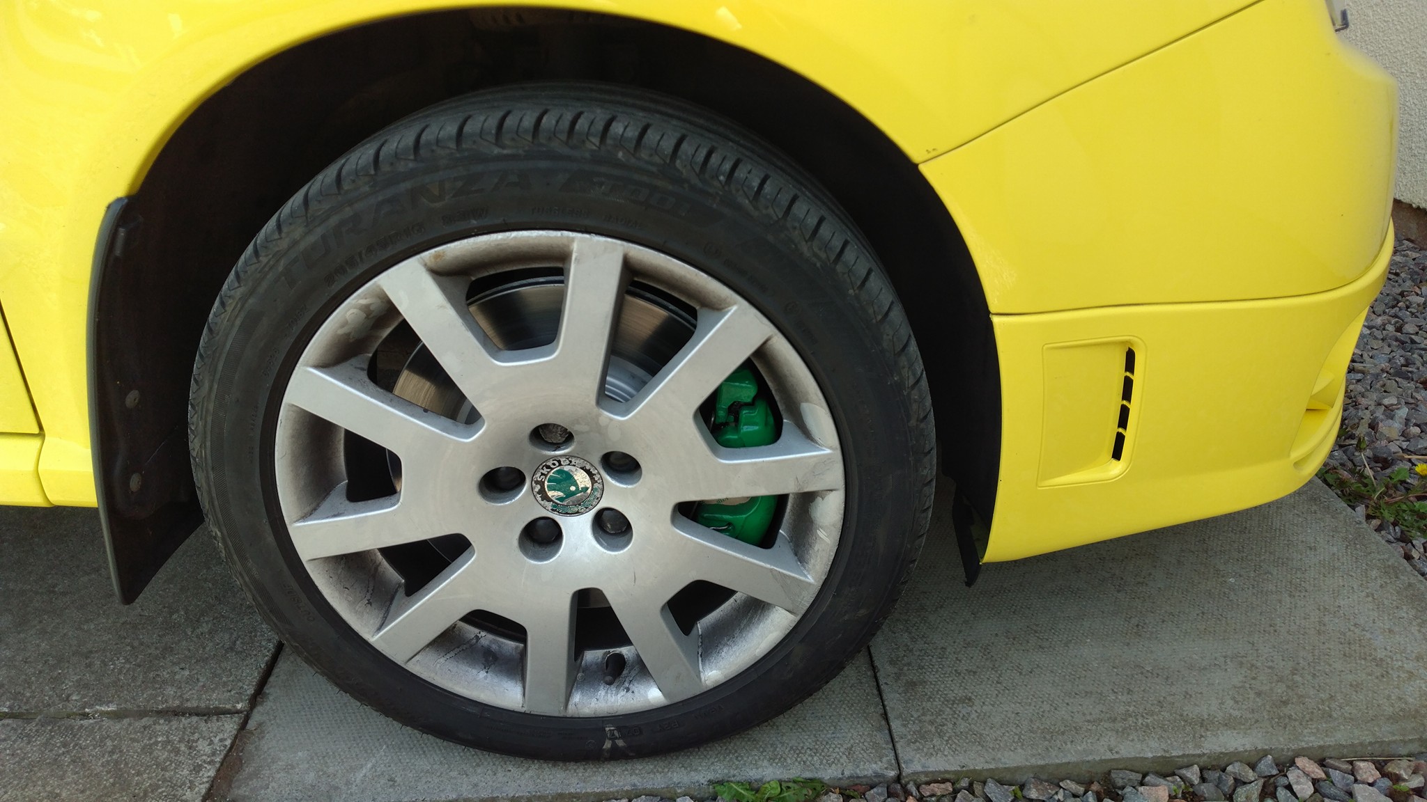

I have literally just done my brakes today, upgraded to 312mm with brembo discs and pads.
You need mk1 Octavia VRS calipers and carriers, then the discs and pads. You can use the original lines apparently but mine were perished so I got Octavia lines too as they are 4cm longer.
Can tell the difference straight away and they clear inside the 16" wheels with pro ably 2mm between the caliper and wheel weights so no need for bigger wheels.
You can also fit Octavia VRS calipers to the rear.

Calipers and carriers were from eBay  £68 posted.
Rebuild kit from Bigg Red  £30.
I couldn't get the paint off so went back to Bigg Red and they charged £70 to soda blast, anti corrosion paint and then high temp ceramic bake on paint.
Discs and pads were from euro car parts with a weekend offer of 35% off and came to £120
Hoses were again from euro with 35% off and came to £35.
So all up it came to £323 but you could do it cheaper if you didn't rebuild the calipers  (I had to as seals were split) and you left them green. I wanted them black as I'm going to fit 17" spider and get the refurbished in metallic purple eventually and thought it would look odd.

Just the fronts so far, eventually I will fit Octavia VRS brakes to the back.
No I had the Octavia VRS calipers painted.
Struts are Bilstein B4 but you can leave the ones on there now. I fitted them as an upgrade as mine needed replacing.
